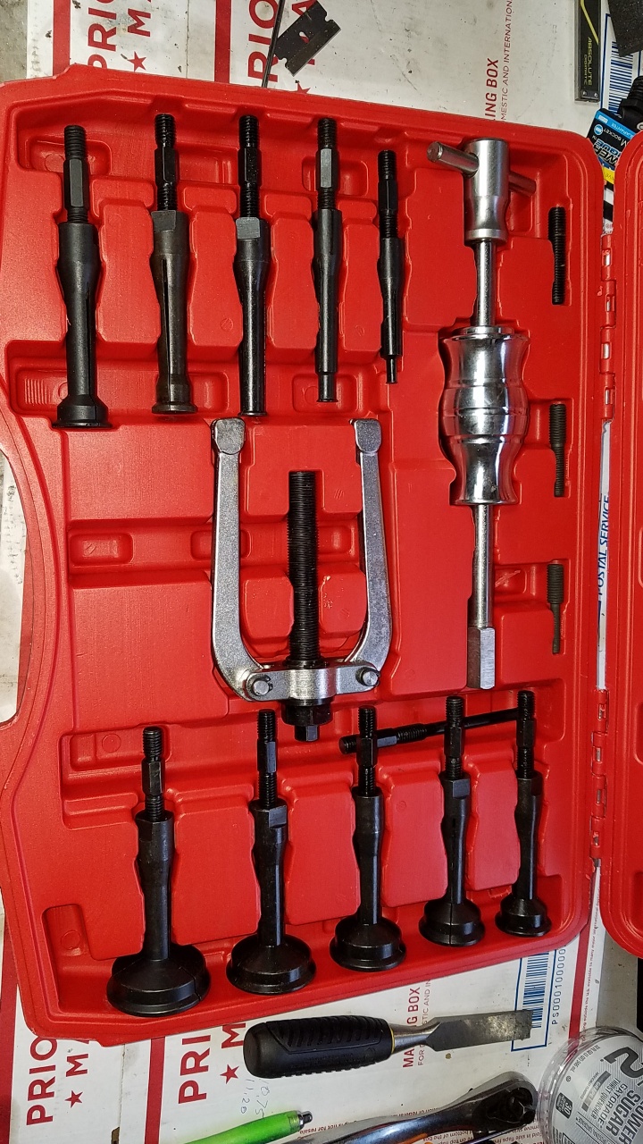

Here is the kit..

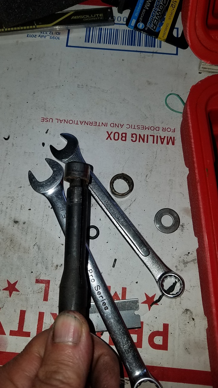

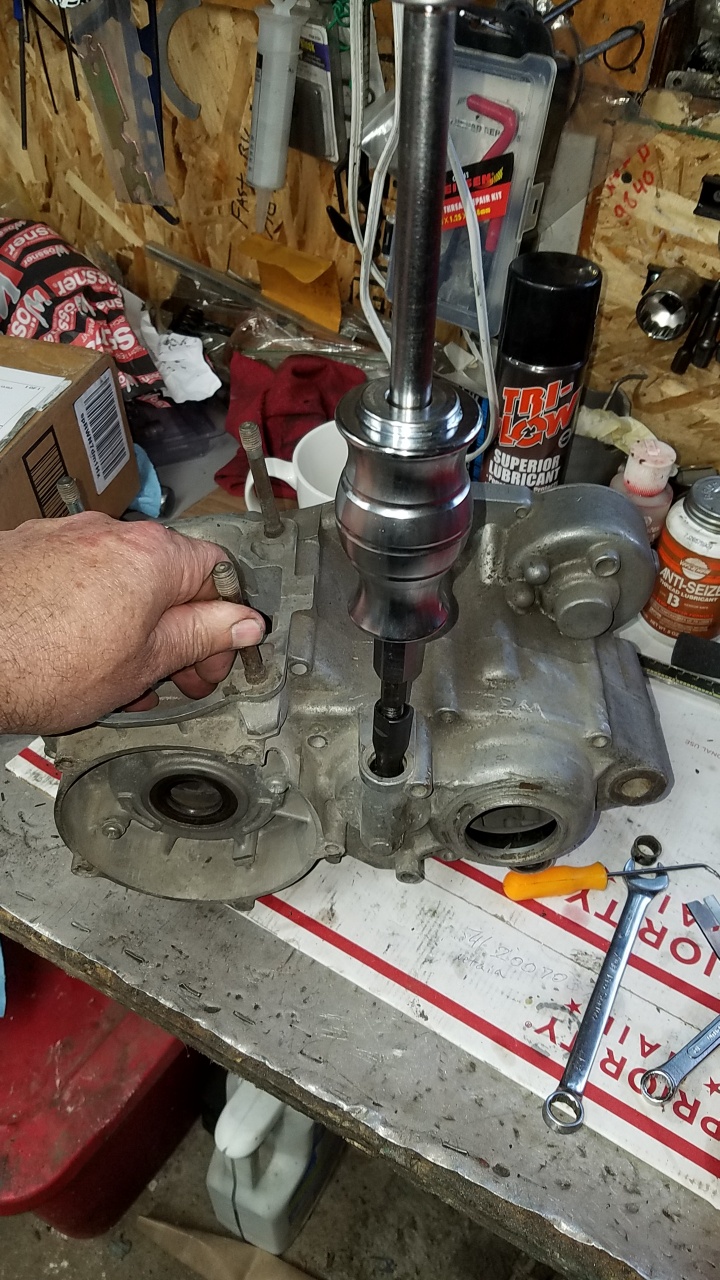

1st bearing gone...

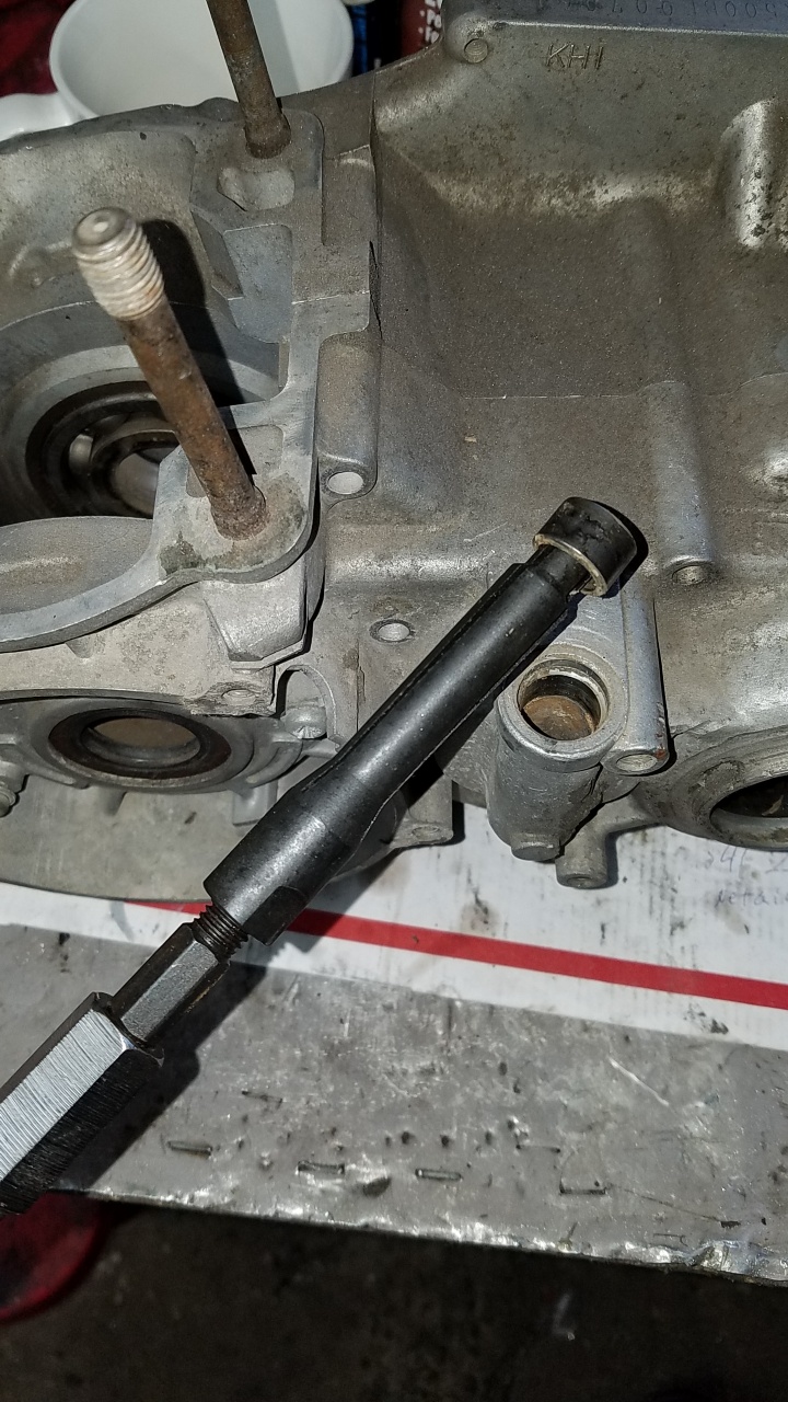

Set up for the deep bearing... Yep, the tool is plenty deep..
Done..
