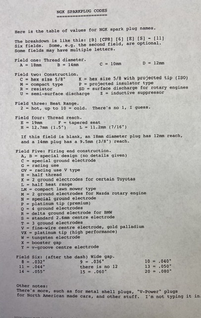

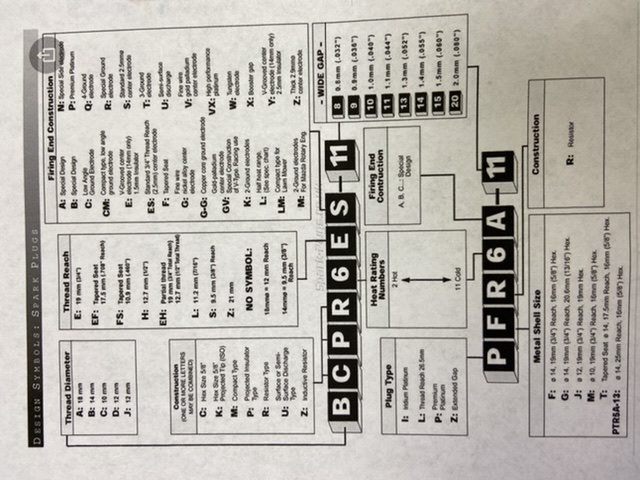

These might come in handy some time.
- Attachments
- BEBECEEC-5918-4761-87EF-808C638FCA4C.jpeg (107.6 KiB) Viewed 14278 times
- 491B44D3-59E7-4290-9EFE-3BAB7D640758.jpeg (125.53 KiB) Viewed 14278 times
Re: KX 500 different plugs.
Nice
Thanks for posting those..
