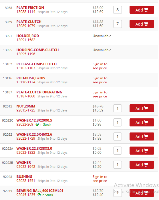

Go to www.partzilla.com of any other online parts house.
Look up your make, model, and year.

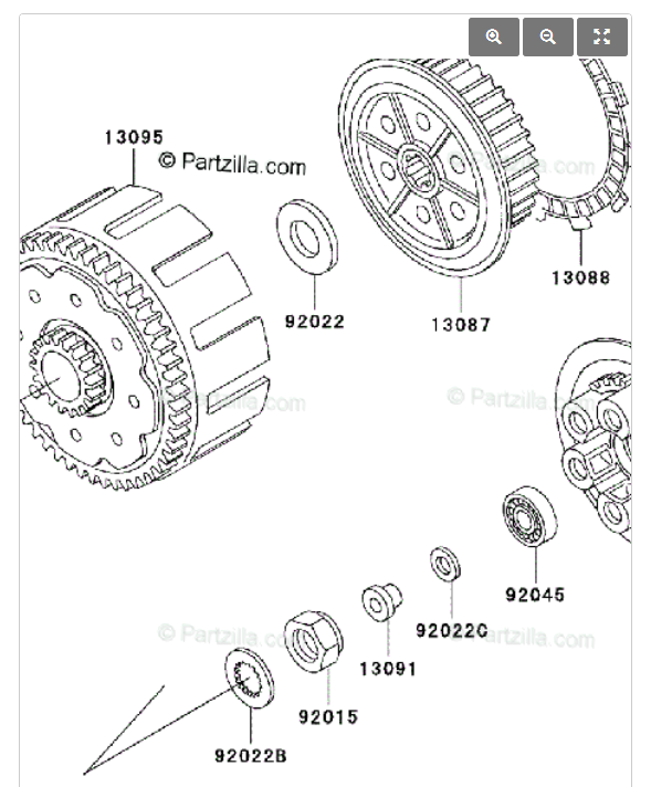

Now... look at the pic closely..
Without having any measurements you should be able to see a clear difference between the two washers.
But let's say that you can make heads or tails of it.
Look at the parts numbers below.
Notice anything interesting?

92022 - WASHER,22.5X46X2.6 92022-1739
22.5X46X2.6 That is the dimensions of the washer.
Granted, both washers don't have measurements but in this case one does.
Use the process of elimination
Any questions?
Any questions?

Today, I drained the oil, and took it apart again, just to see what there was to see. This is where it got a bit confusing. First off, I do have a well worn service manual. I also have the later model 500 supplement. If you look at the parts explosion in the service manual, one of the washers is depicted as a bigger outer diameter than the other. In the parts diagram (which I was looking at in the hot tub on my iPhone) they appear to be the same size on the drawing. That started my brain thinking that I had put them in backwards perhaps, because when I checked the other motor I have for reference, one was visibly thicker than the other, but the same diameter inside and outside. I was not the one who assembled that motor though. Also, when I put the Rekluse in mine, I did not disassemble the hub and basket, so I had not yet looked at the washers. When I did, I discovered that they cannot be interchanged, as the one between the hub and basket (92022) is an outer diameter too large to fit between the basket and case bearing, without hitting the idler gear for the kick starter. Only the 92022A will fit there. (The 92922B is the spline lock washer, so it had no dimensions listed, as it is a special part) So, my motor was assembled correctly all along. This lead to two more questions. First, WTF is up with that other motor’s clutch? And second, what is going on with mine, that the Rekluse won’t work?
