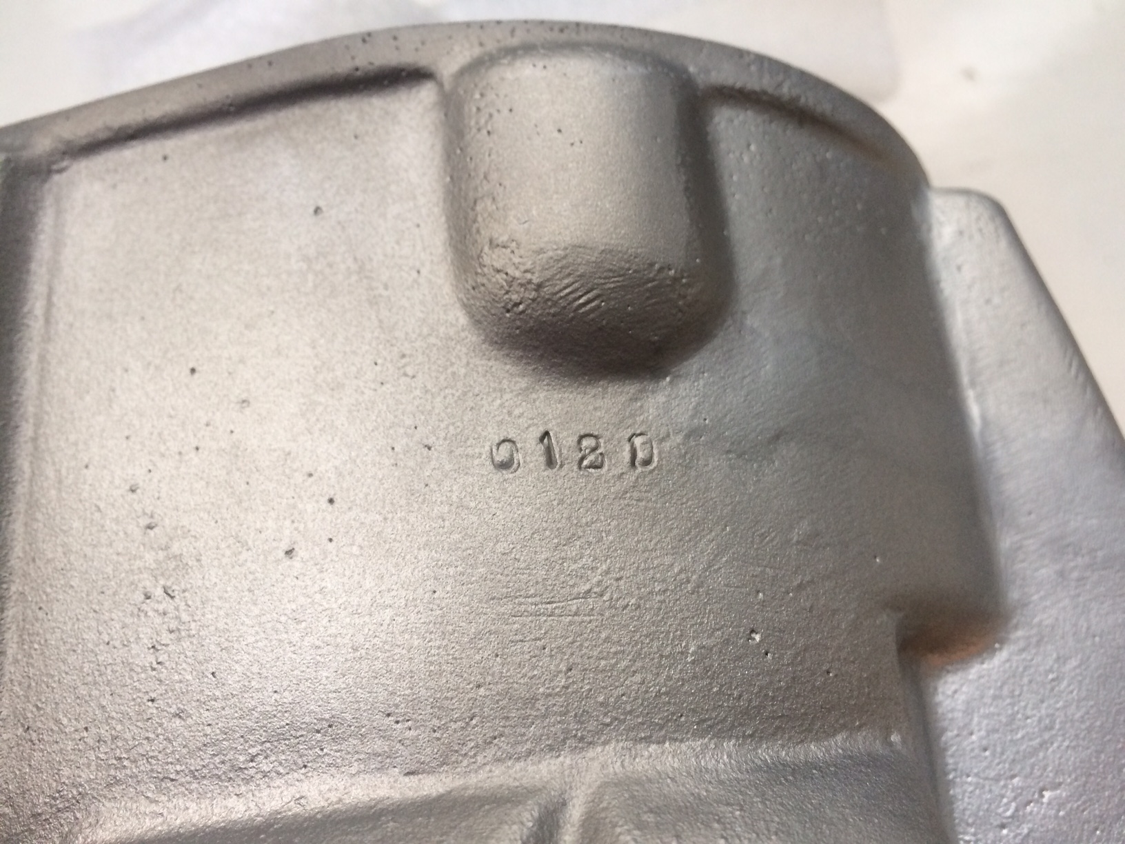

There are several things to be learned from this cylinder...
I don't have any measurements yet but hope too soon.
The first thing you learn is that there is very little difference between a stock cylinder and a SR cylinder.
The biggest differences I see is the amount of clean up.

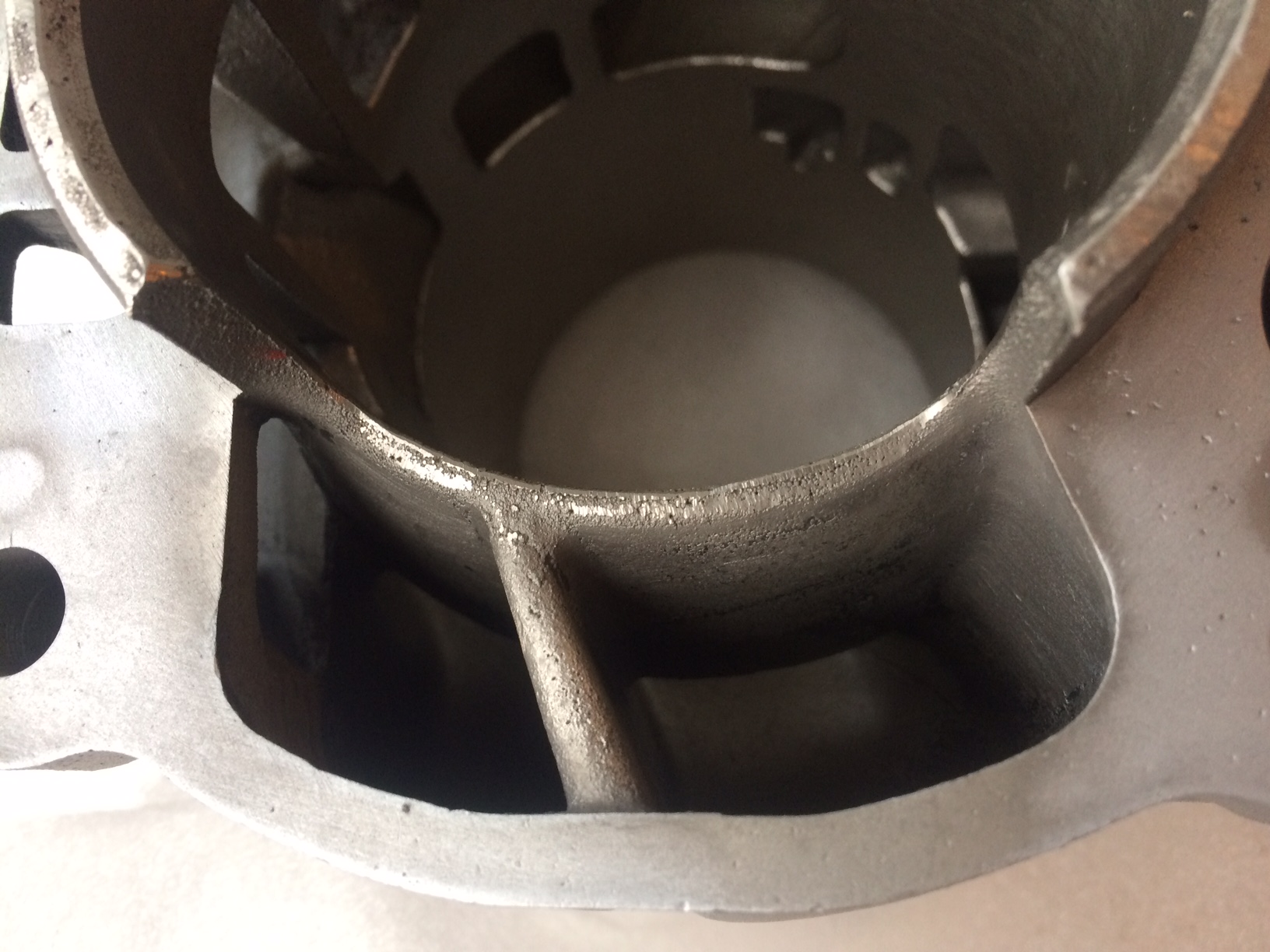

Let's take a look..
Re: SR500 Cylinder
A simple clean up as shown is all that is really necessary.

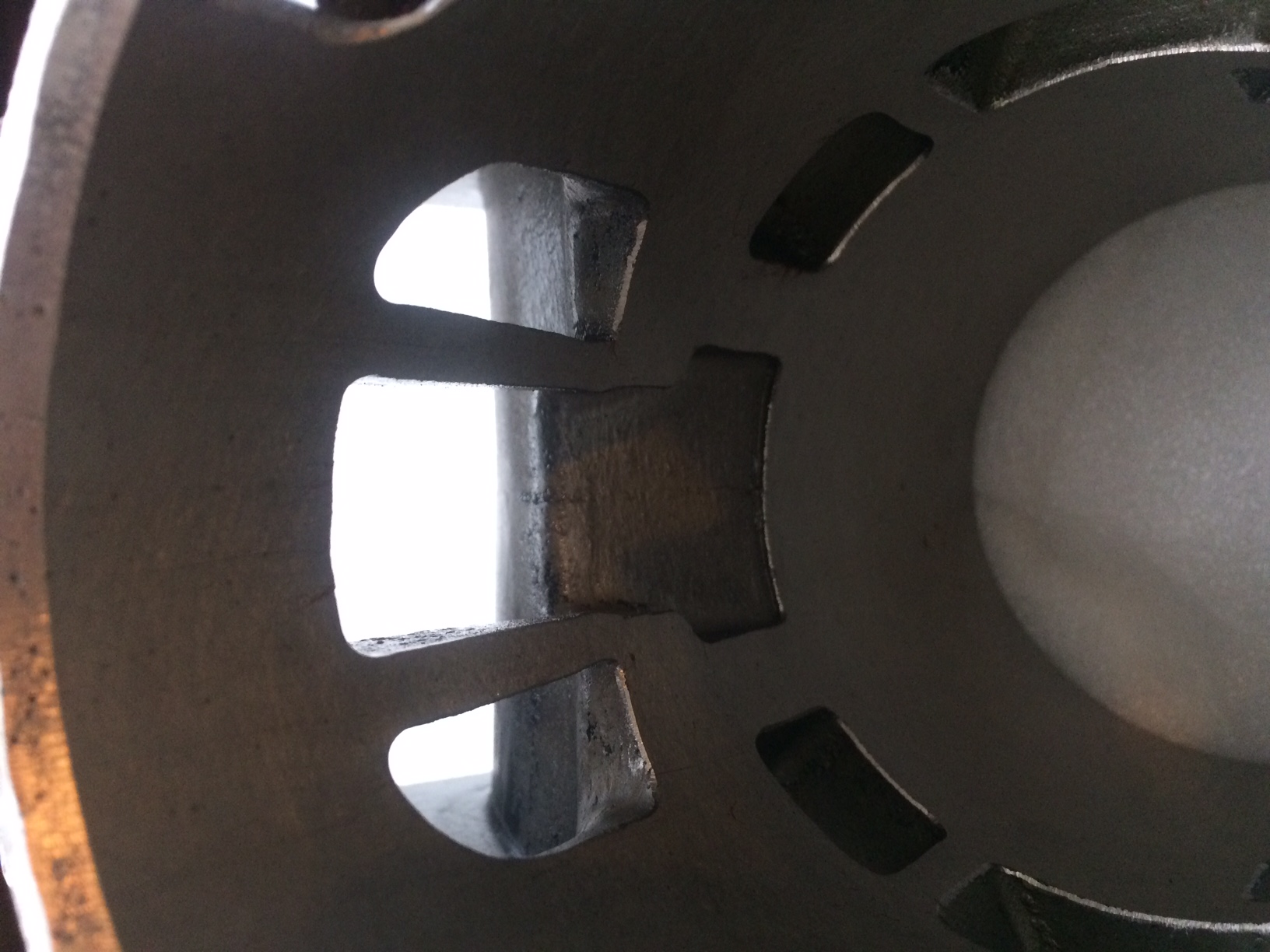

Re: SR500 Cylinder
I like to get these surfaces a bit more even but again there isn't much to do..

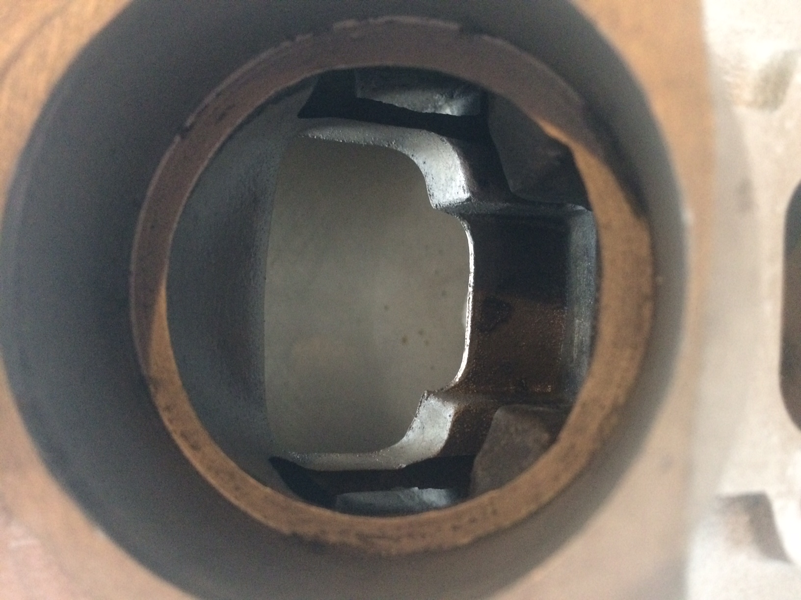

Re: SR500 Cylinder
I like to clean up the exhaust port and polish but it does not really make any HP.
Rather, by polishing the surfaces it gives carbon less chance to build up and will keep the new HP you are making longer...
