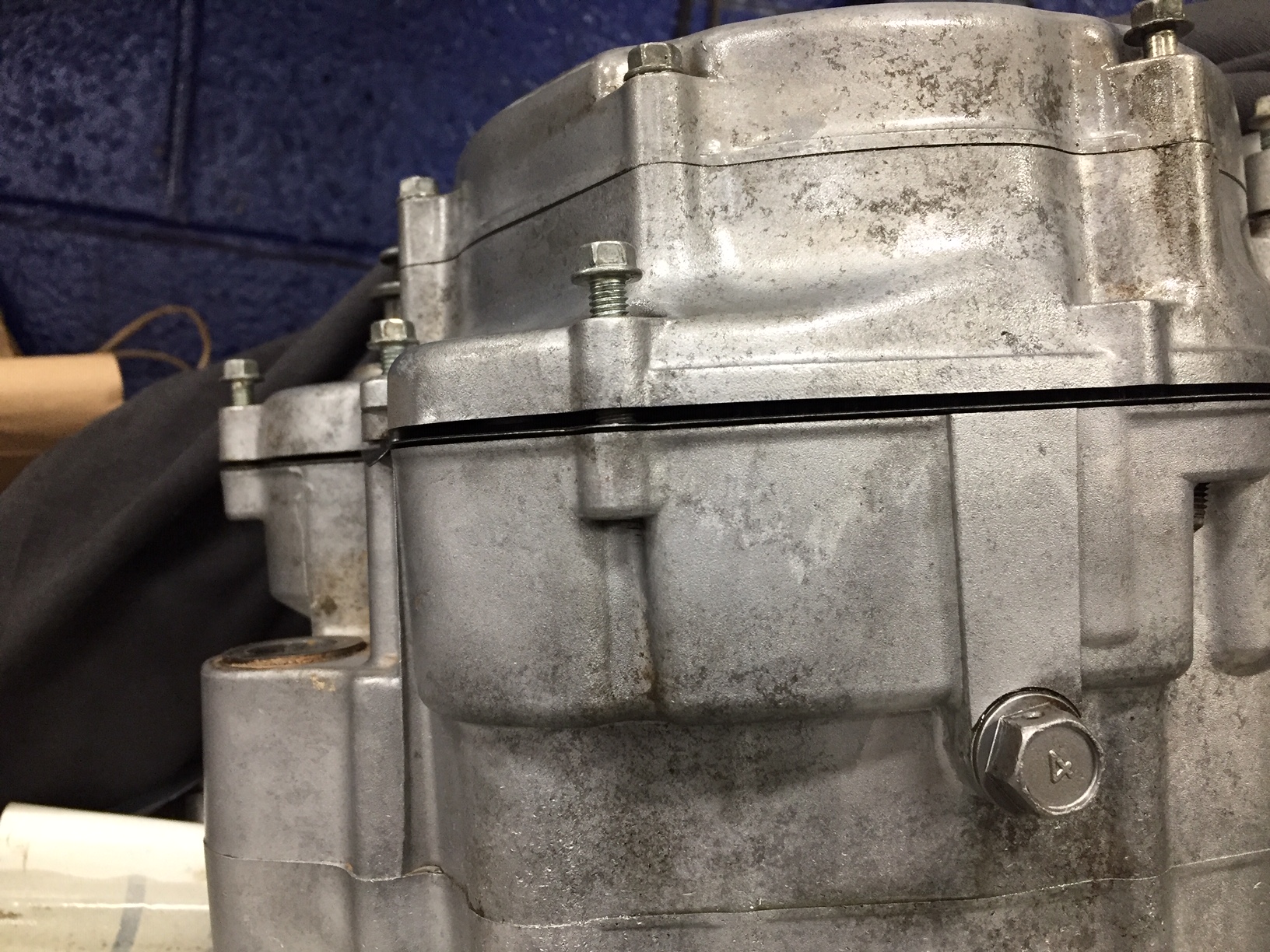

Is it possible for the shift shaft to hold up the right side cover? The notch in the cover is hitting the top of the shift shaft no allowing cover to seat flush? I can see the half-moon on the backside of the cover contacting shaft.

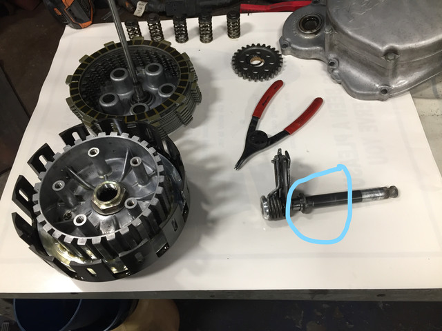

I tried spinning the shaft, you can feel the water pump and the exhaust advancer gears mess. You can see in with a flashlight that the notch on the backside is contacting the top of shift shaft, I did not have time to further investigate yet. I took it into work because we are slow of course, now I have not been able to get back on it. just wondering if anyone had that issue before. I decided to lay engine flat, in doing so I had to remove the gear shifter. I think the shaft slide out of position, also looks like to remove shaft completely I will have to remove clutch and basket

It's hard to tell from those pics but I think the shaft is not all the way down..
It looks like it is riding a bit high.
Double check to see if it is all the way in.
And yes, you would have to remove the basket to get the mechanism out.

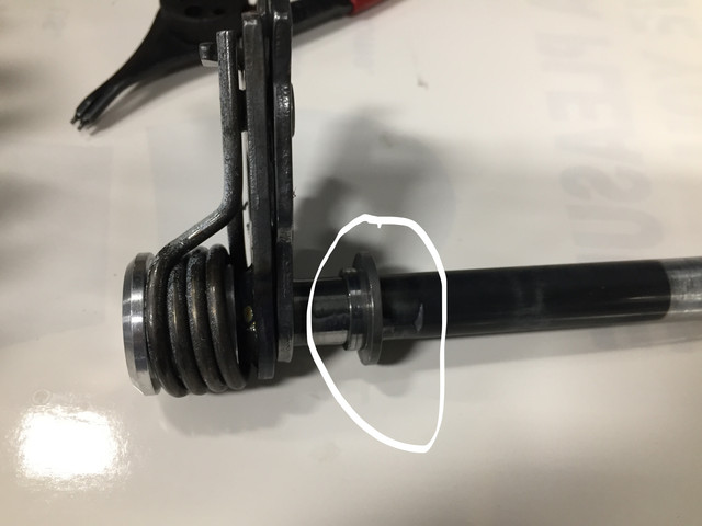

I had some time in am to look at it. Found the washer on the shaft was dislodged from the proper position.
Re: Could shift shaft hold up right side cover?
That can make a difference :lol:
