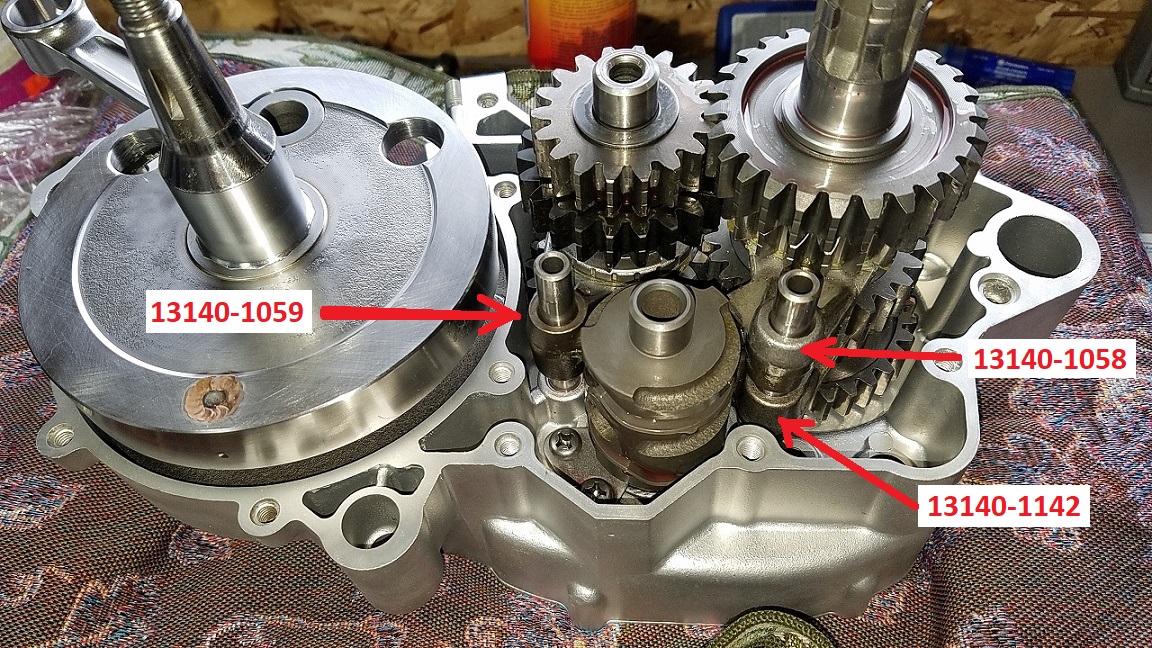

KX500 SHIFT FORK POSITION PICTORIAL
Bottom end tips and mods

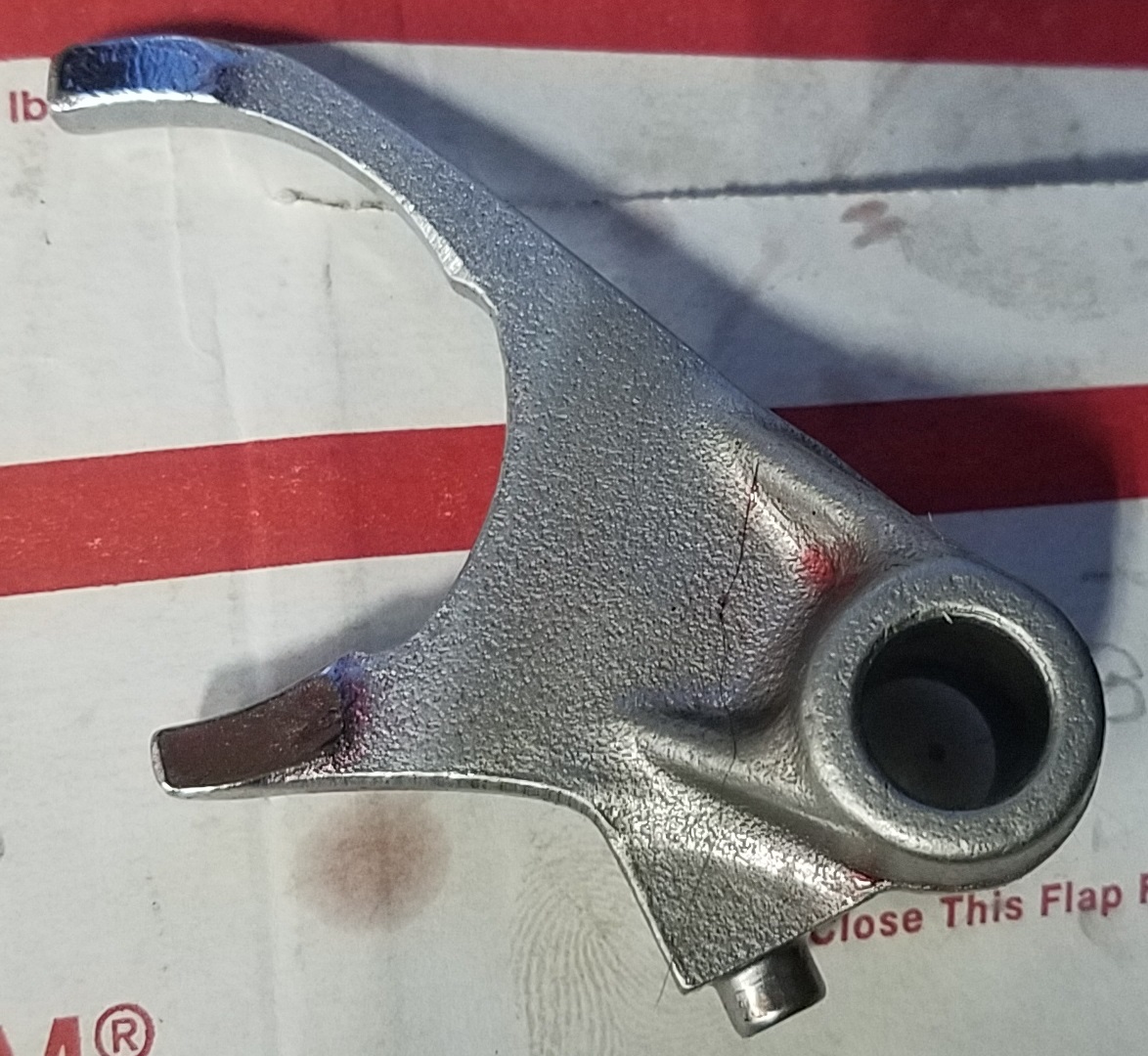

Let's start with the part numbers..
KX500 SHIFT FORK POSITION.JPG (475.81 KiB) Viewed 8053 times
Re: KX500 SHIFT FORK POSITION PICTORIAL
13140-1142
13140-1058
13140-1059
