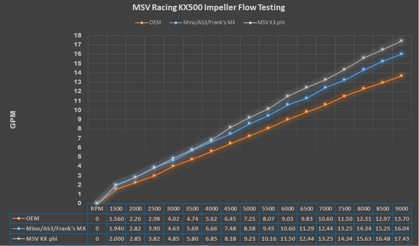

The KX500 “phi” impeller vanes are computer designed using “Golden Ratio” proportions based on the KX500’s H2O pump housing. This as well as closer tolerances between impeller and housing offer +1.2 average GPM more coolant flow and cooler coolant temps when you need it most! This increase in flow reduces the cycle time between the engine and the radiators allowing more heat removal quicker, lowering head and coolant temperatures.

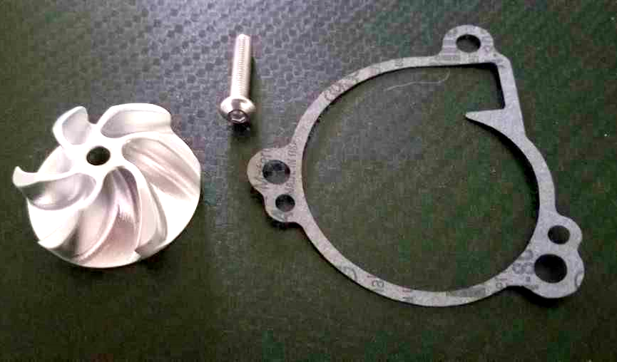

The MSV Racing KX500 “phi” Impeller comes with the main pump cover gasket and button head impeller fastener for a seamless install.

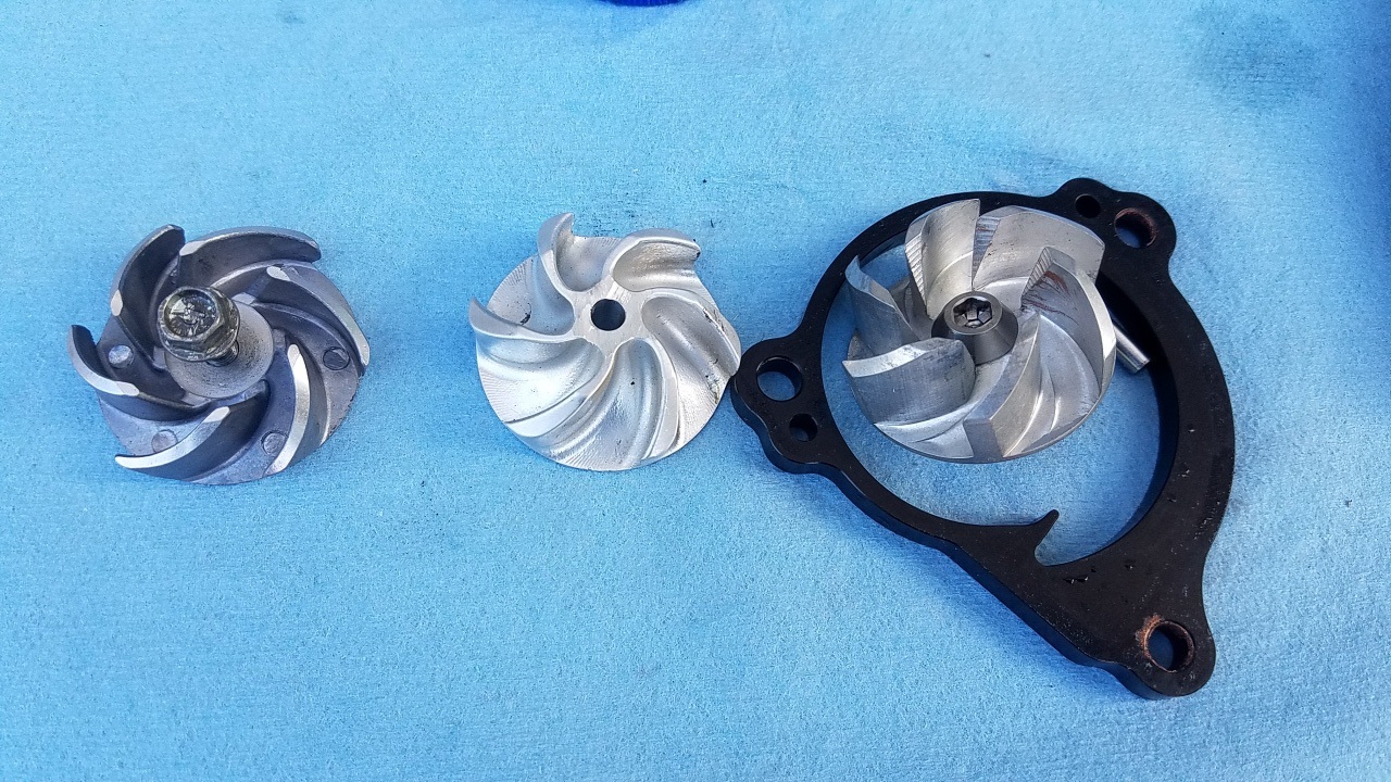

From left to right.. Stock, MSV, and AS3.
KX GURU RACING KX500 IMPELLER TEST 101.jpg (446.87 KiB) Viewed 13138 times

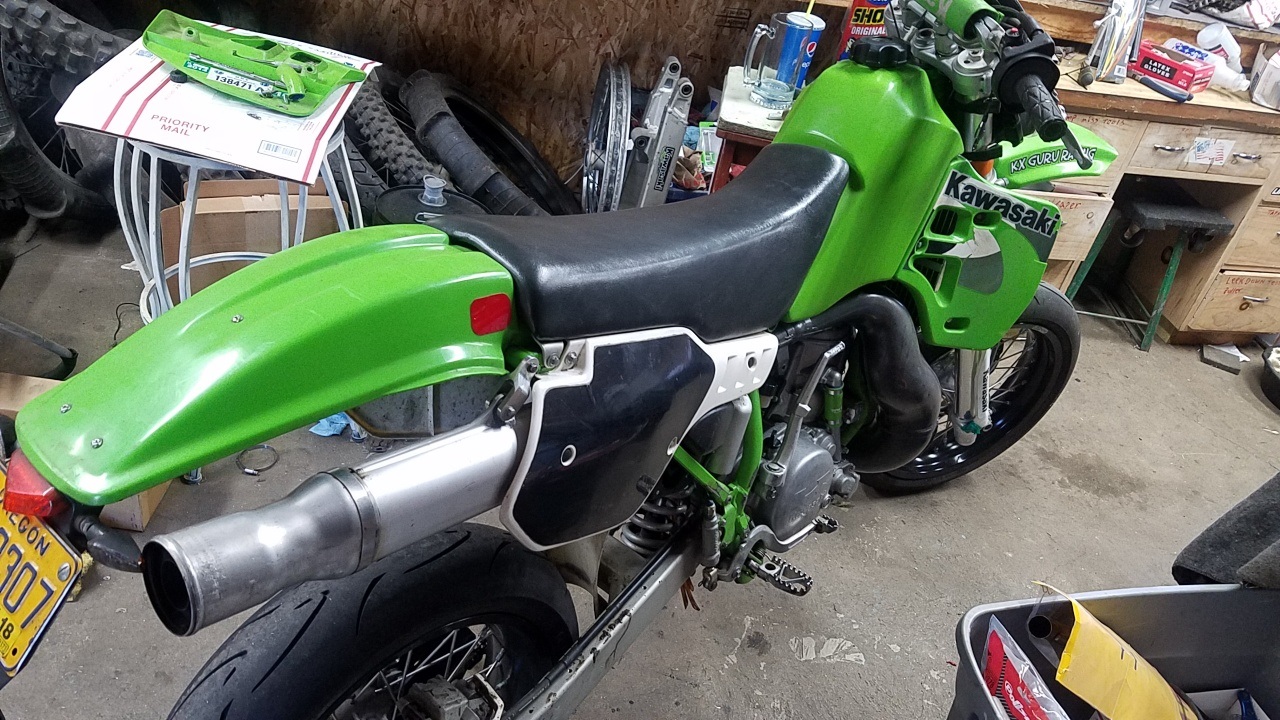

Test bed.
2001 KX500.
The engine is stock.
The exhaust is stock with the addition of a arrestor added to the end of the stock muffler.
KX GURU RACING KX500 IMPELLER TEST 102.jpg (407.7 KiB) Viewed 13138 times

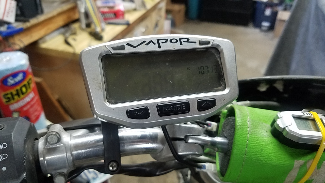

The head temp is a under the spark plug style from Trail Tech, Vapor..
KX GURU RACING KX500 IMPELLER TEST 103.jpg (276.44 KiB) Viewed 13138 times

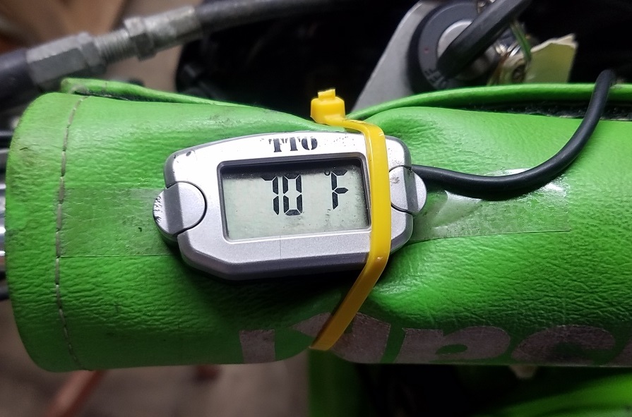

The water temp was taken where it exits the head on the left side.
It is a Trail Tech TTO
Lol... Yes, it is mounted temporarily.
I wanted to get this testing done ASAP and the making of a new mounting plate for the key and gauge would have delayed me for another week.

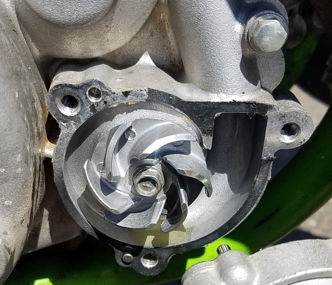

Here is a pic of the stock impeller
KX GURU RACING KX500 IMPELLER TEST 106.jpg (183.11 KiB) Viewed 13131 times

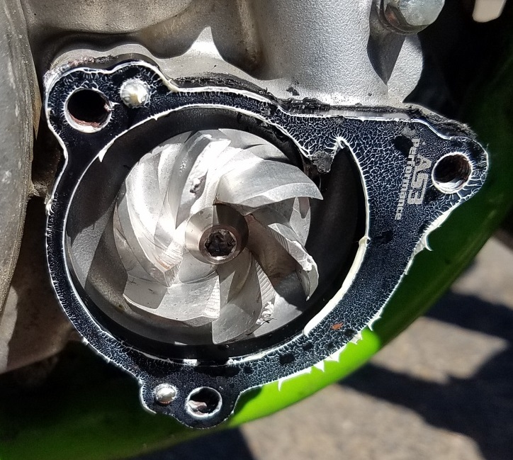

Here is a pic of the AS3
KX GURU RACING KX500 IMPELLER TEST 107.jpg (206.72 KiB) Viewed 13131 times

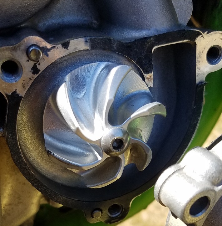

Here is a pic of the MSV PHI impeller
KX GURU RACING KX500 IMPELLER TEST 108.jpg (178.07 KiB) Viewed 13131 times

Installation...
The MSV installs the same way as stock except that you need the impeller bolt which is included in the kit.
The AS3 is so tall that it requires a water pump spacer, longer bolt, additional gasket, and longer alignment pins.
So far, my impression is that the MSV PHI impeller is superior in just about every way to the stock and AS3 impellers.
Under the testing parameters, it cools better and is easier to install then the AS3.

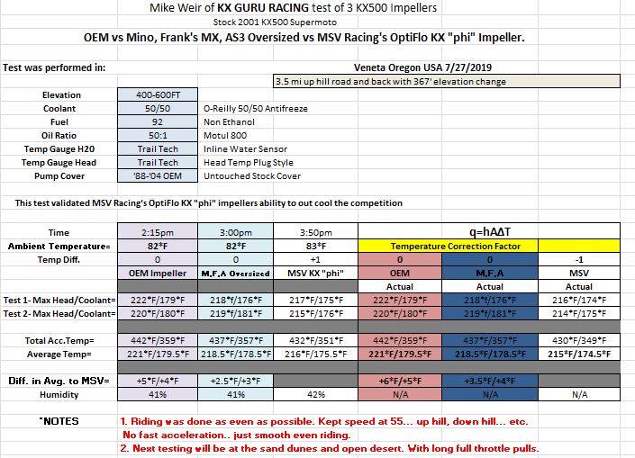

Here is some independent testing done by Alex Ward which further confirms my own testing..
KX GURU RACING KX500 IMPELLER TEST 106.jpg (58.35 KiB) Viewed 12988 times

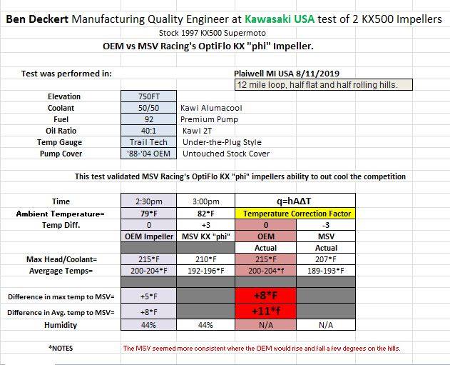

Here is some additional independent testing from Ben Deckert.
KX GURU RACING KX500 IMPELLER TEST 109.jpg (61.69 KiB) Viewed 12985 times
