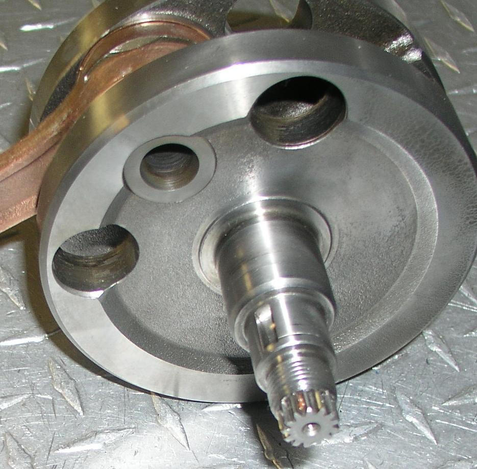

Here is a pic of the 85-86 kx500 clutch side of crank.

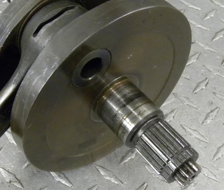

Here is a pic of the 1987 KX500 crank.

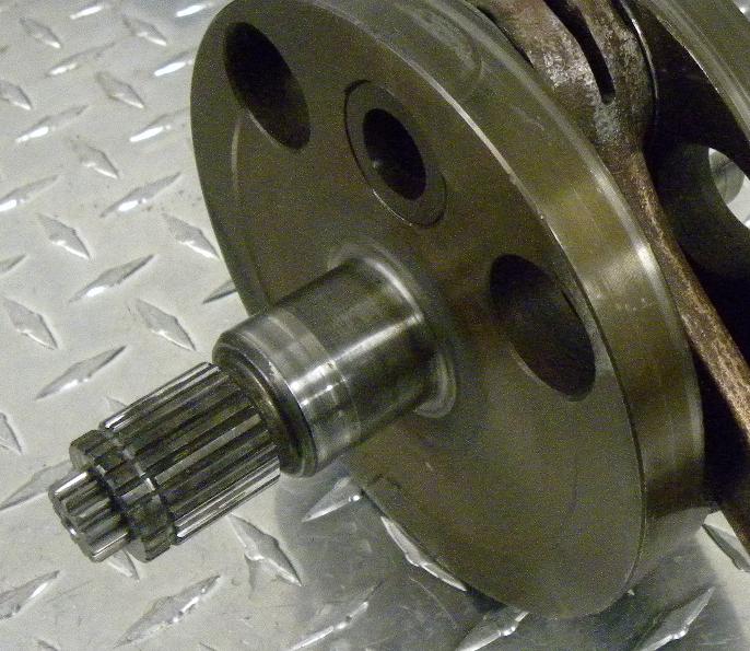

Here is a pic of the 1988 KX500 crank.

From what I can see, 85-87 kx500 crank shafts look identical.
From what I can see, 88 is the only kx500 crank shaft where it uses the snap ring on the primary crank gear but has the holes in the crank halves..
From what I can see, 89-04 crank shafts look identical.
So my best prognostication is that 85-04 can all be swapped as long as you have the correct primary crank gear asy to match the crank you are using.
