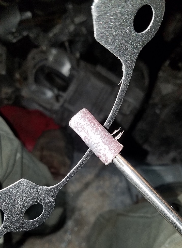

You spent some serious money getting a beautiful top end ported, plated, and ready to install. Spend a few minutes to port match your Cometic base gasket or you just wasted some of the time or money you invested. I probably wouldn't try this with those cheap paper gaskets....
