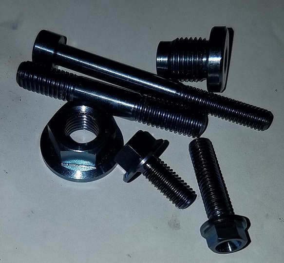

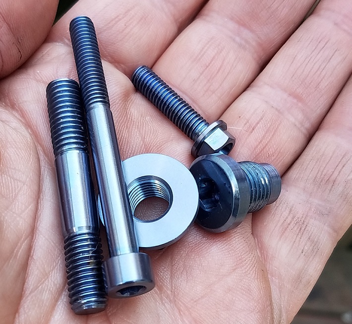

As you can see, 9V batteries when new are a bit high on voltage but should be good enough for this initial test.
I put enough water into the bottom of the pan to cover the bolts I wanted to anodize.
I sprinkled in about 2 table spoons of Borax... probably too much but whatever.. it's cheap ;)
Then I used two alligator clips to attach the wires to the two ends of the battery terminals.
On one end of one of the wires I stripped off about 5 inches of the insulation.
I'm pretty sure I could anodize faster if I used a better anode such as a spoon soldered to the wire.
But this will give me an idea.
Then I dropped in a bolt to the solution and made sure it was covered over.
The I touched the bolt with the opposite wire..
Here is a vid showing the results...
https://youtu.be/NGc0g3jkjHw

Bad pics buy you get the idea... :geek:
