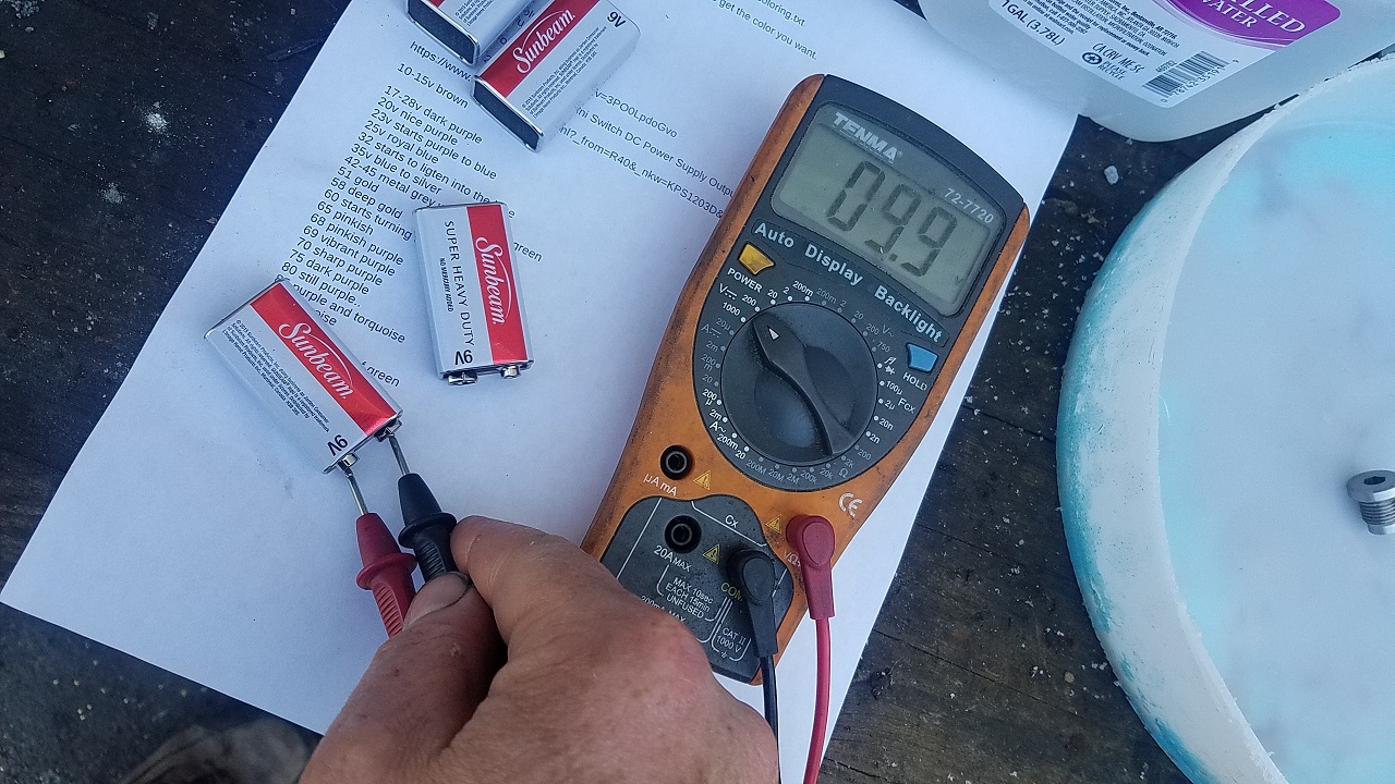

Testing a normal 9V battery and you get approx 9V :shock:
Take the negative of one 9V battery and attach it to the positive of another and you should get about 18v :o
Add another battery to the series and you should get about 27V :D
Posts: 6319
Re: DIY "Do it yourself" Anodizing your titanium bolts
As you can see, 9V batteries when new are a bit high on voltage but should be good enough for this initial test.
