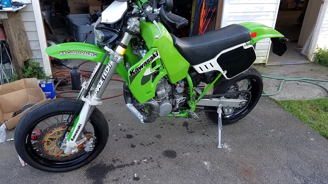

Here we are, the test bed.
This is my 01 KX500 Supermoto that has had a fair amount of riding done on it.
I hadn't ran it in about a year and a half.
In fact, I think Oscar Cota was the last to ride it down at his place in So Cal when we were putting Sean Colliers bike together..
We robbed a bunch of parts off it for Sean's bike and I just haven't had the time to get it all back up and running.

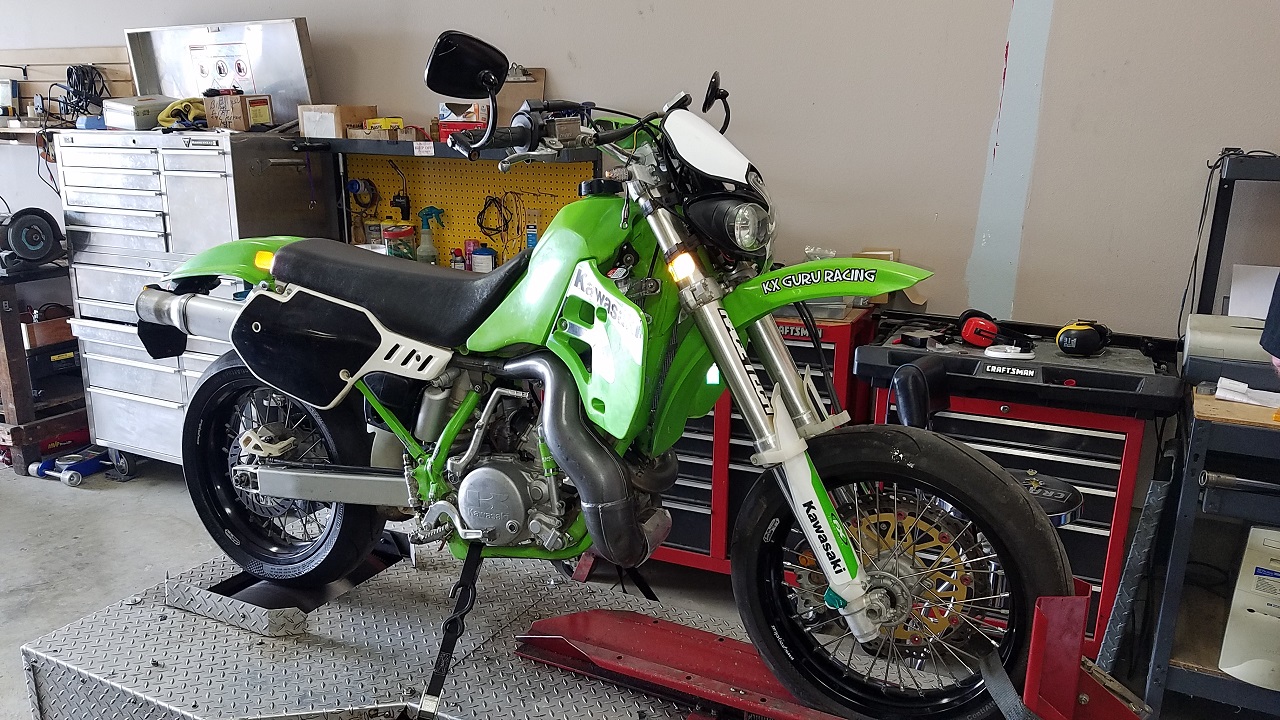

Re: KX Guru Racing JT Engine Works KX500 Turbo Crank testing
Sitting on the dyno... strapped down and ready..
KXGURU RACING JT ENGINE WORKS KX500 TURBO CRANK TESTING 110.jpg (443.38 KiB) Viewed 18984 times

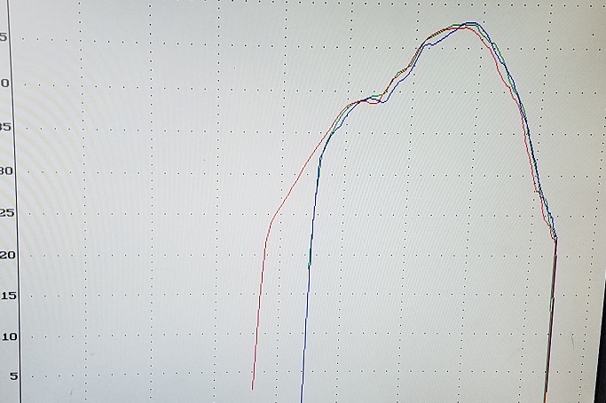

4 pulls and threw out the top one...
first dyno series.jpg (108.66 KiB) Viewed 18984 times
48 RWHP.
For a worn out top end that's about what you would expect from a completely stock KX500.
If the engine was completely fresh you can expect 52-55 RWHP from what others have told me.
Some people will want to point out that Kawasaki claimed 63HP but that is Crank HP.
You will loose a bit through your clutch, transmission, chain, sprockets, and rear tire.
So, I don't care about what it is at the crank.
I want to know what my tire is transferring to the ground 8-)

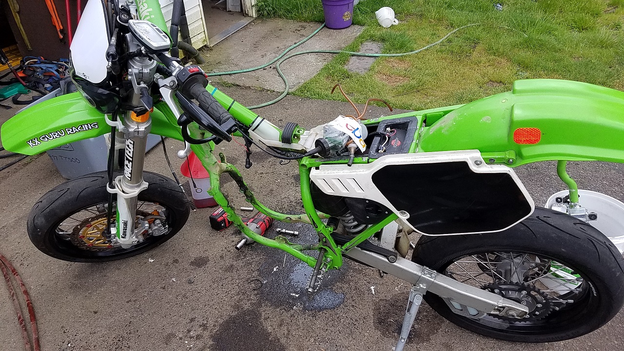

Got it home from the dyno about 3pm and started disassembly.
KXGURU RACING JT ENGINE WORKS KX500 TURBO CRANK TESTING 111.jpg (562.62 KiB) Viewed 18982 times

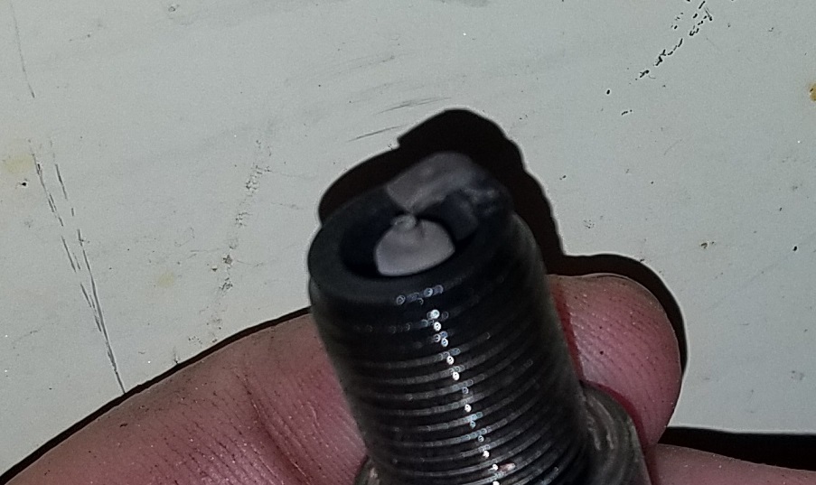

Check out the plug... it's no bad considering the blow by we were getting.
KXGURU RACING JT ENGINE WORKS KX500 TURBO CRANK TESTING 112.jpg (134.95 KiB) Viewed 18982 times

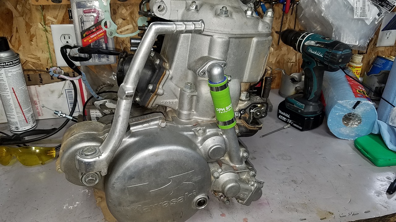

The engine is out..
KXGURU RACING JT ENGINE WORKS KX500 TURBO CRANK TESTING 113.jpg (568.99 KiB) Viewed 18982 times
And sitting on the bench.
KXGURU RACING JT ENGINE WORKS KX500 TURBO CRANK TESTING 114.jpg (432.4 KiB) Viewed 18982 times

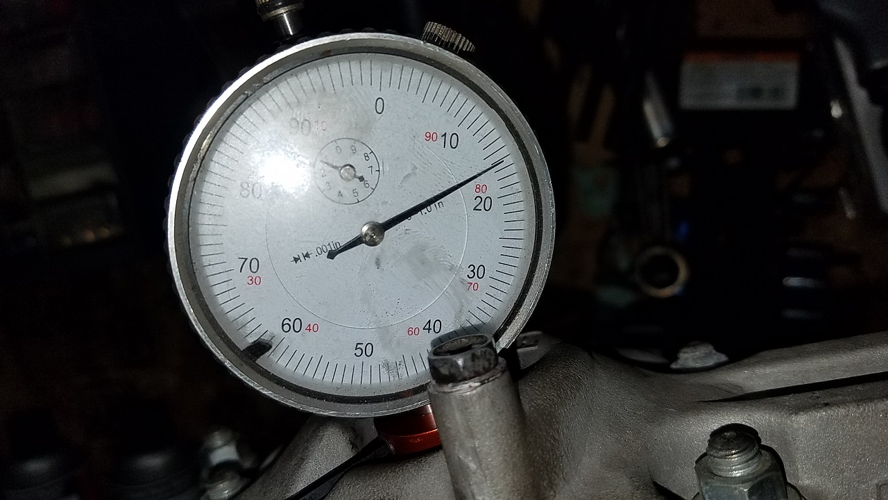

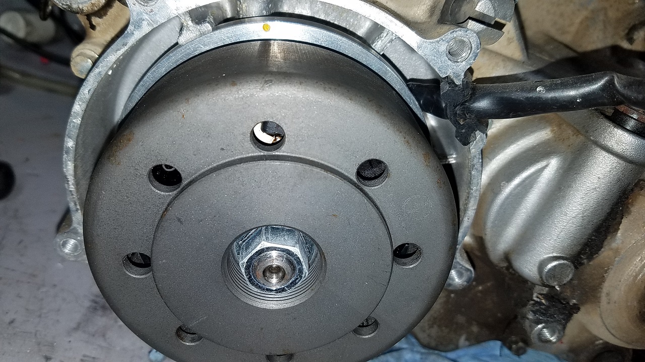

One of the few after market parts is a Power Dynamo ignition system so we need to be careful and use the same settings.
KXGURU RACING JT ENGINE WORKS KX500 TURBO CRANK TESTING 115.jpg (419.3 KiB) Viewed 18981 times
KXGURU RACING JT ENGINE WORKS KX500 TURBO CRANK TESTING 116.jpg (278.84 KiB) Viewed 18981 times
Documented :shock:

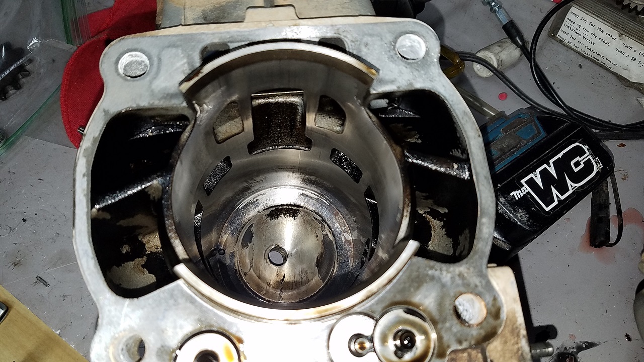

The top end is actually pretty clean considering it's age.
KXGURU RACING JT ENGINE WORKS KX500 TURBO CRANK TESTING 117.jpg (373.56 KiB) Viewed 18980 times

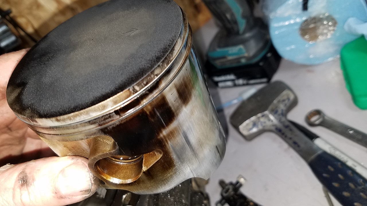

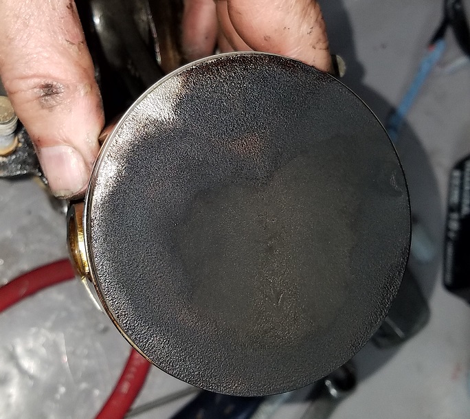

The piston top is.... dirty..... :D
KXGURU RACING JT ENGINE WORKS KX500 TURBO CRANK TESTING 118.jpg (181.5 KiB) Viewed 18980 times
As you can see, the blow by is significant.
KXGURU RACING JT ENGINE WORKS KX500 TURBO CRANK TESTING 119.jpg (299.54 KiB) Viewed 18980 times

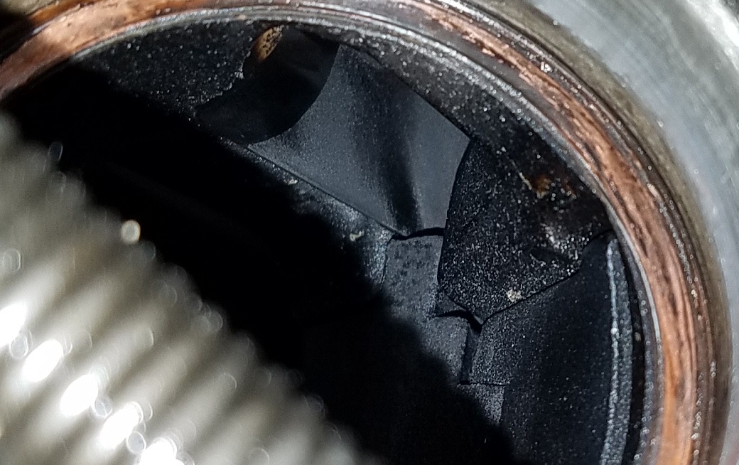

The exhaust valves operate smoothly but could use a good cleaning and adjustment, but, we are not going to clean, adjust, or replace anything.
KXGURU RACING JT ENGINE WORKS KX500 TURBO CRANK TESTING 120.jpg (241.88 KiB) Viewed 18979 times
