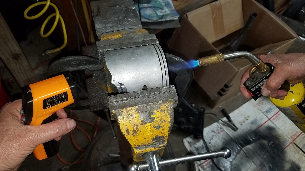

Here is how I will test.
I will use a stock KX500 Piston (Used).
I will put it into my vice to hold it.
Jason will hold a map gas torch on the face of the piston.
I will use a inexpensive Infrared Thermometer Gun w. Laser Guide to take temps from the bottom of the piston at 15 second intervals.
After I do this I will coat the piston top with the Cerakote, cure it, then run the test again and compare.
Here is my simple setup.

Uncoated piston
Starting temp 62F
15 SEC 120F
30 SEC 185F
45 SEC 227F
1 MIN 263F
1 MIN 15 SEC 296F
1 MIN 30 SEC 313F
1 MIN 45 SEC 328F
2 MIN 353F

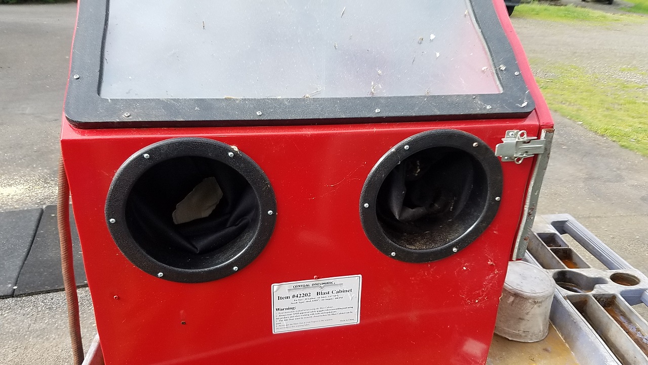

I traded some work for this never used cheapo blast cabinet.
In the directions is says not to use use aluminum oxide.
Guess what I'm using... Yep Aluminum oxide.
At 40 lbs the media comes out at a low velocity so it won't blast through the metal to quickly
Here is the piston ready for blasting.

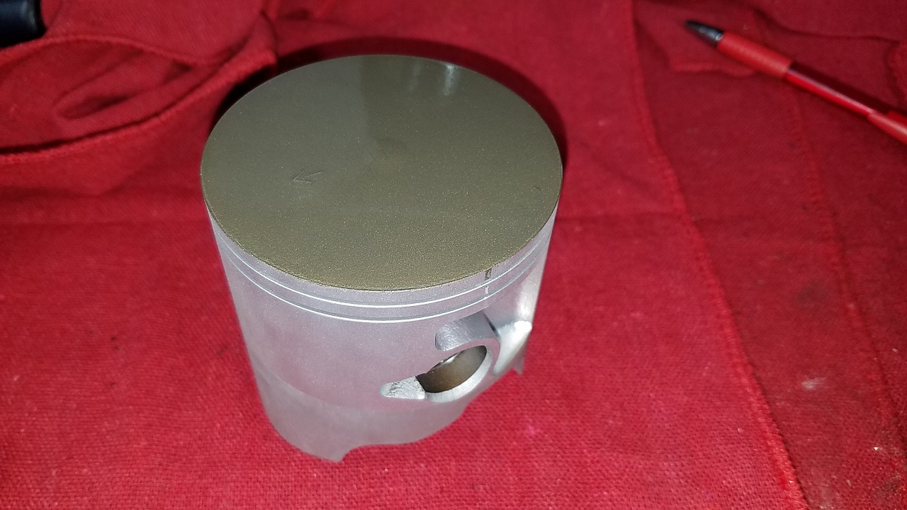

Here is the results after the aluminum oxide is ran on the dome..
