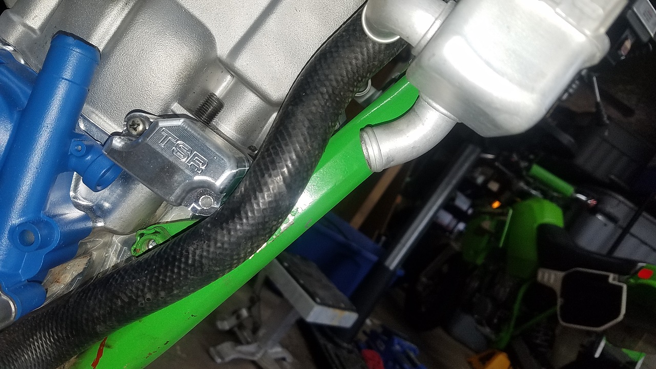

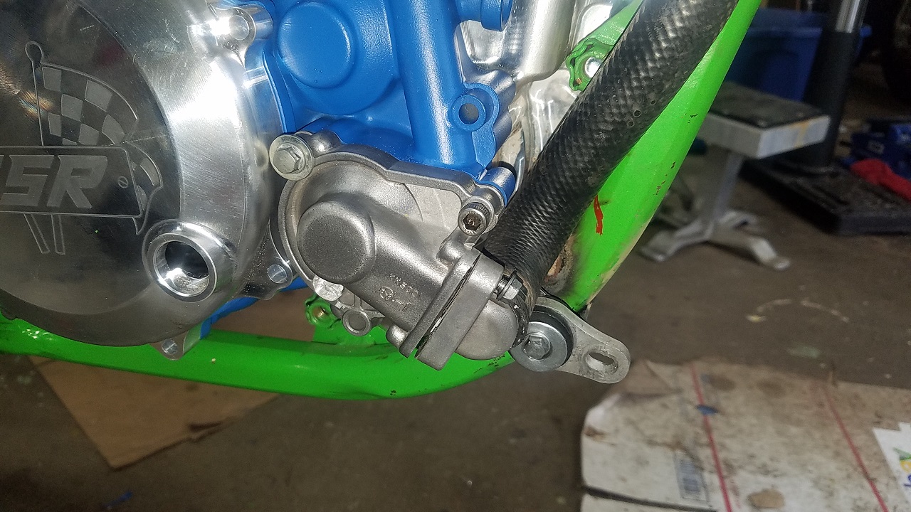

Posts: 6319
I'm also double checking all the fittings and clearances...
This side is tight but has just enough clearance...
