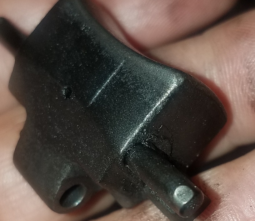

The first thing to do is remove the pins.
You can see from this pic that the ends are very worn.
Remember, for ever .001" of wear you loose .002" of lift.
It is not uncommon to see these worn .020" or more :shock:
.020" of lift will reduce your port timing probably about 2 degrees and create that annoying KIPS rattle which in turn is creating turbulence from the flapper dancing around. Yes, you are loosing HP if you hear that KIPS rattle.

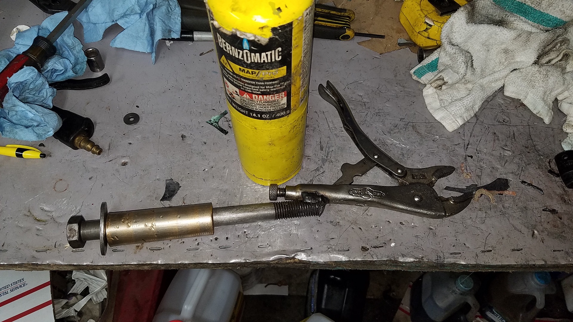

Next, it's time to remove those worn out pins.
So I use a Slidegrip, Map Gas, and a vice.
Before you pull the pins out, measure them and record it.
I like to make mine about 1mm or .040" longer then stock per side.
KX GURU RACING KX500 EXHAUST CENTER FLAP 103.jpg (873.64 KiB) Viewed 14692 times

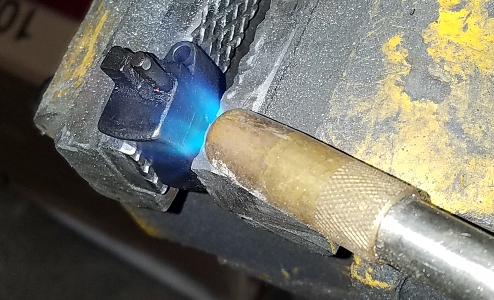

Then, I heat the valve on the thin side of the pin...
KX GURU RACING KX500 EXHAUST CENTER FLAP 104.jpg (257.6 KiB) Viewed 14692 times

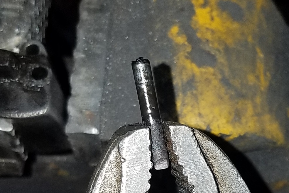

Once the valve is hot enough, about 15 seconds, I hook up the Slidegrips and give it a couple of quick slide of the hammer and it pops right out.
KX GURU RACING KX500 EXHAUST CENTER FLAP 105.jpg (601.05 KiB) Viewed 14692 times

Pins out...
KX GURU RACING KX500 EXHAUST CENTER FLAP 107.jpg (275.58 KiB) Viewed 14689 times

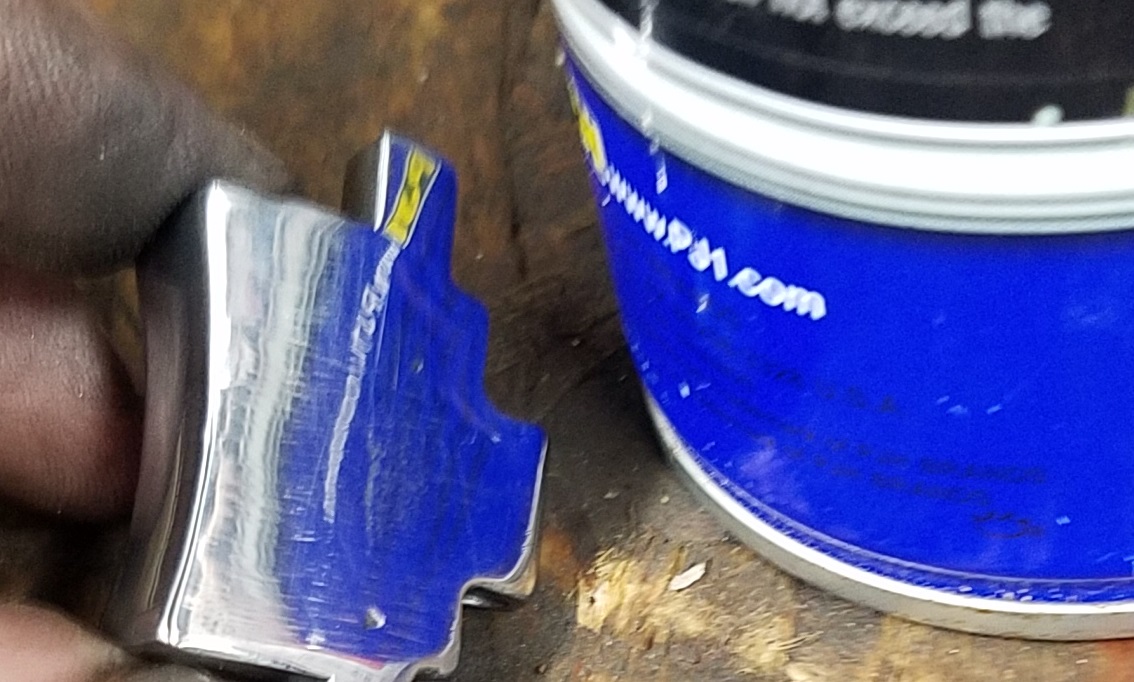

After I get the two surfaces cleaned up, I switch to another flapper wheel which is made from a Scotch-Brite type material.
KX GURU RACING KX500 EXHAUST CENTER FLAP 112.jpg (290.08 KiB) Viewed 14688 times
After the flapper wheels are done I run it on a bench grinder or polisher with a cloth wheel.
I use some green polishing rouge.
KX GURU RACING KX500 EXHAUST CENTER FLAP 113.jpg (762.35 KiB) Viewed 14688 times
KX GURU RACING KX500 EXHAUST CENTER FLAP 114.jpg (230.75 KiB) Viewed 14683 times
So, the more time you spend, the better and smother it will look.
It took me about 20 minutes for the disassembly and polish.
10 more minutes of time would have been crazy 8-)
Just go easy with the grinders, less is more.

Here is about 5 minutes more on the polisher..
KX GURU RACING KX500 EXHAUST CENTER FLAP 117.jpg (300.58 KiB) Viewed 14645 times
KX GURU RACING KX500 EXHAUST CENTER FLAP 118.jpg (297.89 KiB) Viewed 14645 times
As you can see, you get diminishing results.
Sure, it is better and I could get it better yet but for me it's plenty good enough for what it does :lol:
