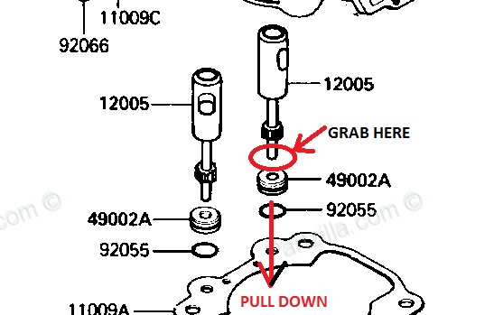

1988 kx500 cylinder 3.jpg (47.54 KiB) Viewed 9451 times
Grab on to the bottom of the exhaust valve and pull the valves down about 1/4"
If you have aluminum valves BE CAREFUL AS THEY WILL BREAK EASILY
If they don't pull down easy, STOP, squirt the valve heavily with a good penetrating oil.
Be sure to squirt both valves not from the bottom but into the exhaust port as shown below
1988 kx500 cylinder 4.jpg (37.24 KiB) Viewed 9451 times

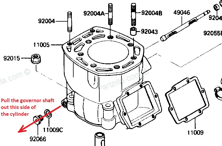

Once you have both valves moved 1/4" down, pull the governor rod out in this direction
1988 kx500 cylinder 5.jpg (118.19 KiB) Viewed 9451 times
