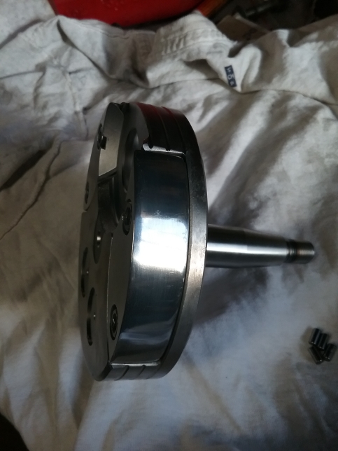

Ok... Jason cleaned and polished the crank and rod.
Remember, send them off dirty and they generally come back dirty.. :shock:

Well... we are a step closer to dyno results.. Steve Parris just finished cutting the crank webs...

What's the purpose of the cuts in the crank ?

The original idea was to push more of the charge up the transfers.
What those guys found out was that there was only so much charge in the lower end and sweeping it up the transfers did not produce more charge.
In fact, a lot of guys gained a little bottom end but lost a lot of top end most likely due to increased turbulance.
The idea behind this design is to compress the charge, then send it up the transfers.
Steve Parris has a patent on this design.
According to Steve he is getting about 7 HP gain with a KX250.
So, we shall see what the dyno says.
I'm very excited.
If we can get 4-5 HP I'll be thrilled.
