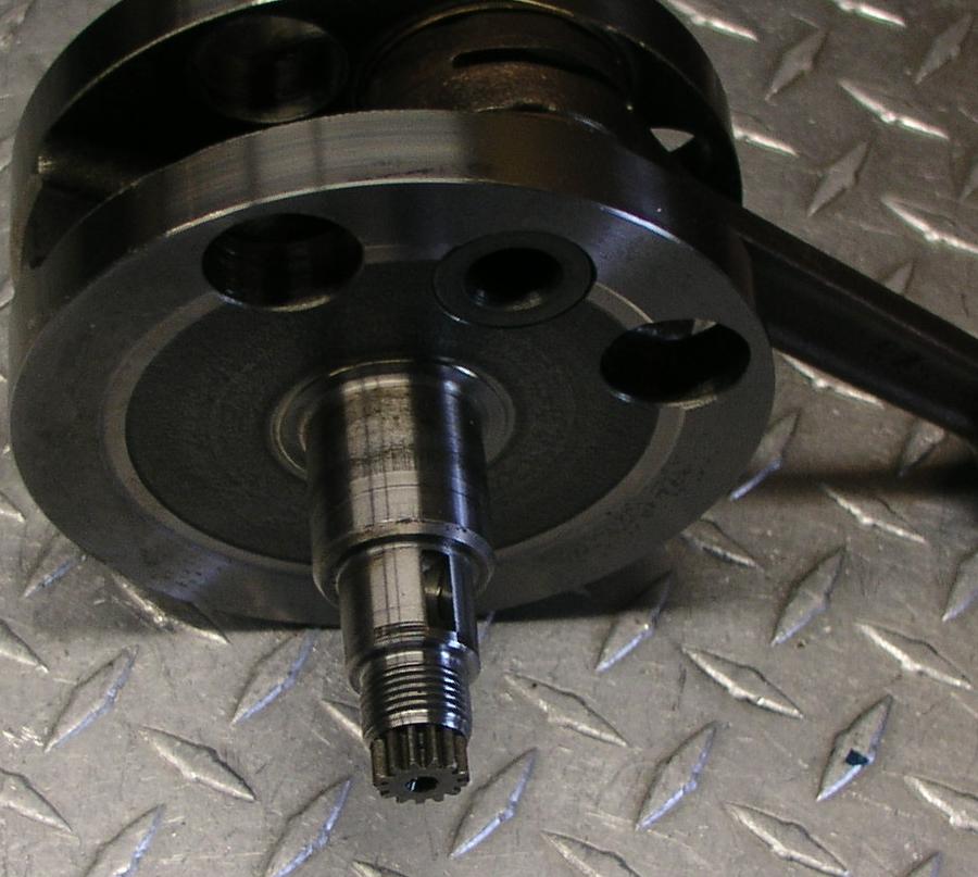

Here is a pic of the 85-86 kx500 clutch side of crank.

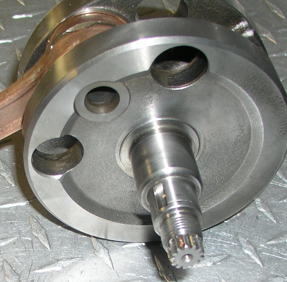

Here is a pic of the 1987 KX500 crank.

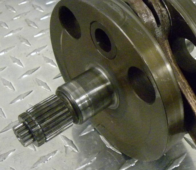

Here is a pic of the 1988 KX500 crank.

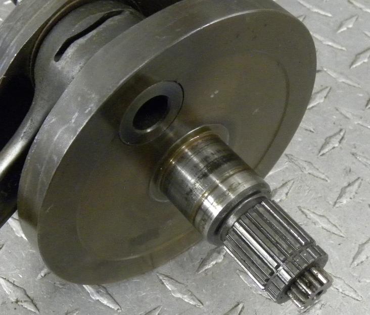

The pic below looks just like a 89-04 KX500 crank.
This pic is of a 1992-2004 KX500 crank.
Trying to determine the difference between the 89-91 and the 92-04.
I have heard that the 89-91 kx500 crank shaft is lighter then the 92-04.
But, that will require some verification.

From what I can see, 85-87 kx500 crank shafts look identical excluding the set backs which vary for crankcase volume.
From what I can see, 88 is the only kx500 crank shaft where it uses the snap ring on the primary crank gear but has the holes in the crank halves..
