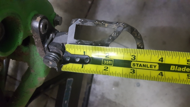

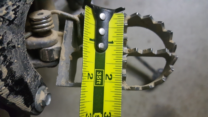

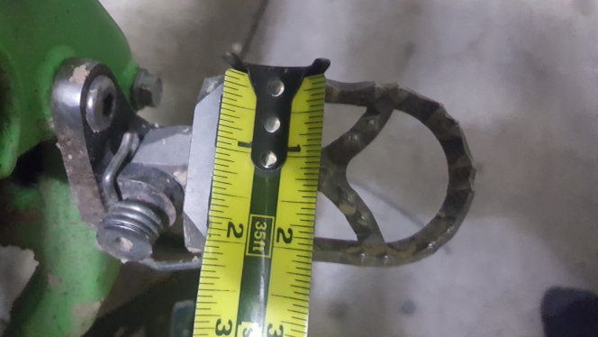

Re: KX500 foot pegs. What else will work?
Here is some dimensions on the Yamaha Torc 1 pegs that we modded for Sean's bike.
