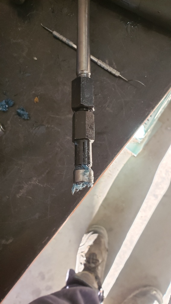

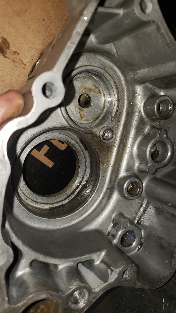

This is a little late for op but I'll just add to this thread for anybody else looking to get that stupid bearing out. I just rebuilt two bottom ends and I was able to use the greasy rag/bread trick (youtube it, there's lots of videos on it) to get the lower bearing up far enough to grab it with my slide hammer. It only worked in one of the cases the other one it broke off the top lip of the outer race and wouldn't move it at all after that. I tried bread but that didn't work at all, grease and rag worked better.

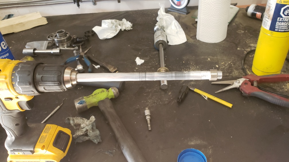

I had piece of aluminum rod that I put in a drill and then spun it on the bench grinder until the OD of it allowed one of those needle bearings to just slip on Then I put bits of rag and grease in the bottom of the blind hole and hammered the aluminum rod down into it. It takes a bit of time and you have to keep adding more grease and rag but it came slowly.
It will only come up so far until the grease starts coming out the hole where clutch push rod goes through, but at that point I could just reach it with my slide hammer Also want to put some keywords in here so it comes up on a Google search easier, I only found this thread after I replaced those bearings lol.

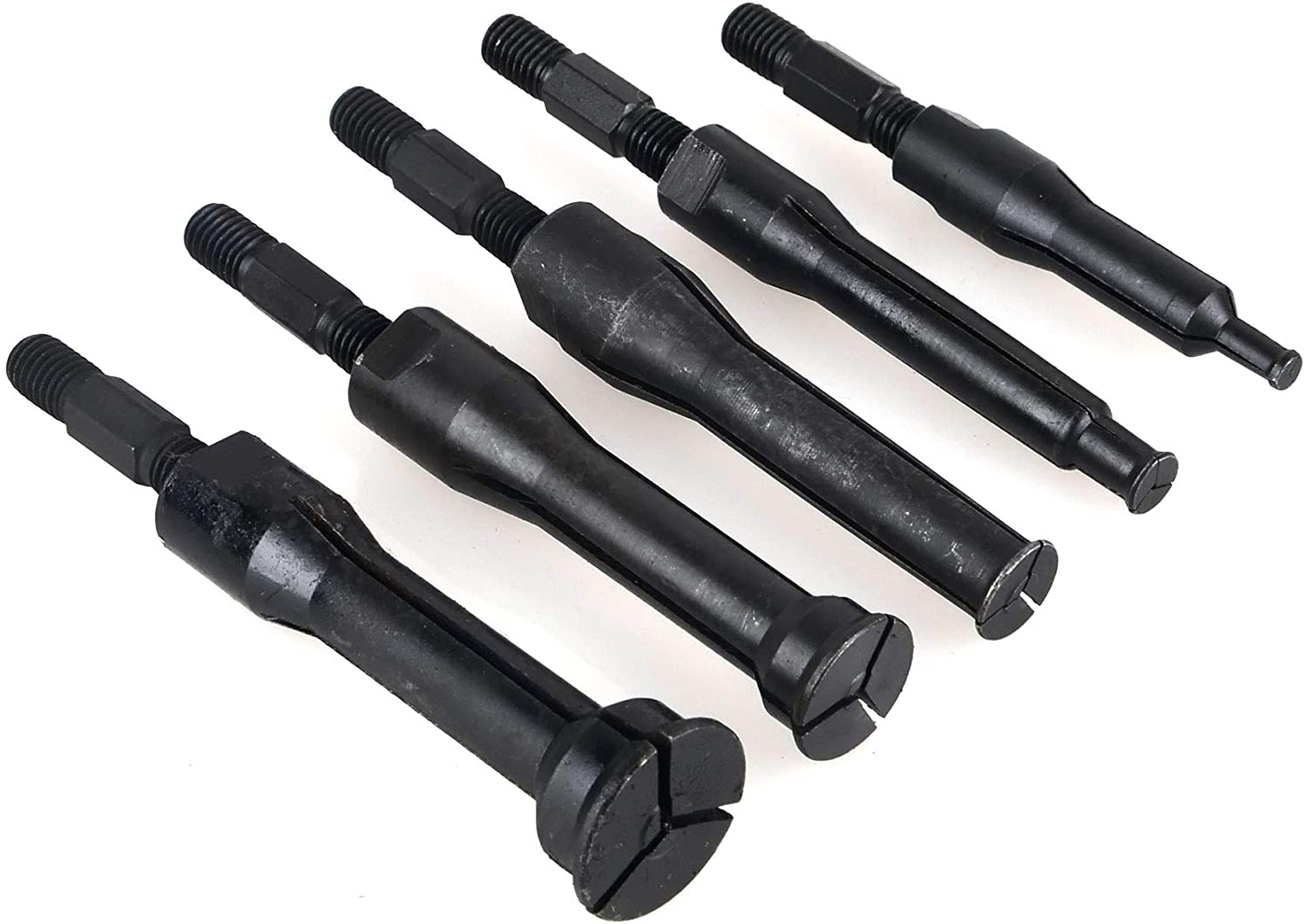

DA YUAN 16 pcs Blind Inner Bearing Puller Hole Remover Extractor Set Slide Hammer Tool Kit
by DA YUAN
4.5 out of 5 stars 5 ratings
Price: $54.95
https://www.amazon.com/YUAN-Bearing-Pul ... 70&sr=8-18
