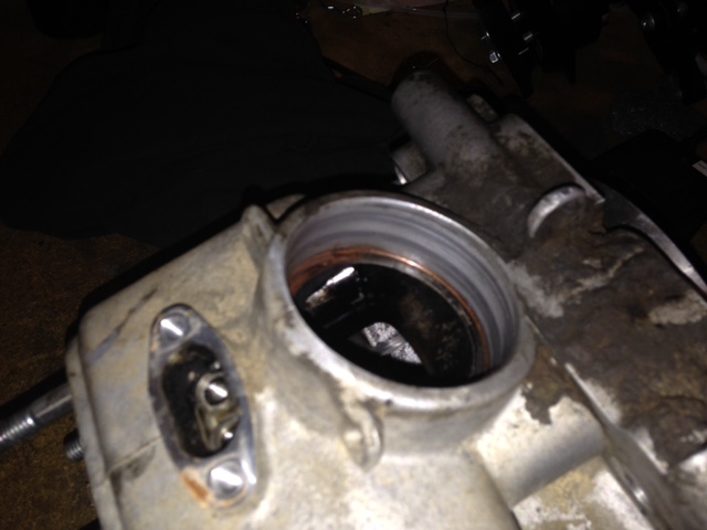

So digging further into the KX500 I bought months ago and finding more and more issues. Looks like the pipe has worn into the aluminum where it inserts into the cylinder. There was muck everywhere around this area on the cylinder and frame, this is not allowing the pipe to seal up. Is this fixable? If so, who is the best place to send it to? Guessing it would be cheaper to have this cylinder repaired, bored, and re-plated compared to buying a new cylinder for $630.

Hi Doug.
Sorry for the delay in my response but I just took a few days off and disappeared into the desert...
If you are in the USA I would send it to Tom Morgan
http://www.morganracingengines.com/
If you are in Canada or outside of the USA I would send it to Adam Millar
https://www.facebook.com/MRE500/
Both are super nice guys and both are capable of getting you fixed up.
As far as cost I would ask both to be sure, but my guess is that it will be in the neighborhood of 400

No worries, I am jealous you got to disappear into the desert for a few days! I am in the U.S., so I will contact Tom Morgan.

Figured I would post an update. sent my cylinder to Tom Morgan, got it back last Friday. He repaired the exhaust area, and sent the cylinder out to be re-plated to the piston I also purchased from him. Very happy with his work, price was reasonable and I would recommend him to anyone. Now I just have to wait for all my parts I ordered from Kawasaki and get this thing back together.

Oh yeah, Tom is a very capable builder and working in a top of the line plating facility has advantages
