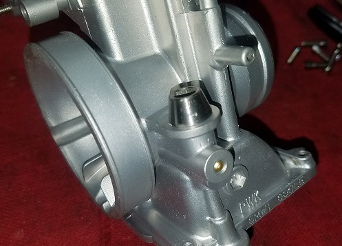

Getting there...
KX GURU RACING KTX500E BUILD 119.jpg (228.72 KiB) Viewed 9664 times
KX GURU RACING KTX500E BUILD 120.jpg (276.57 KiB) Viewed 9664 times
KX GURU RACING KTX500E BUILD 121.jpg (202.78 KiB) Viewed 9664 times
KX GURU RACING KTX500E BUILD 122.jpg (65.96 KiB) Viewed 9664 times

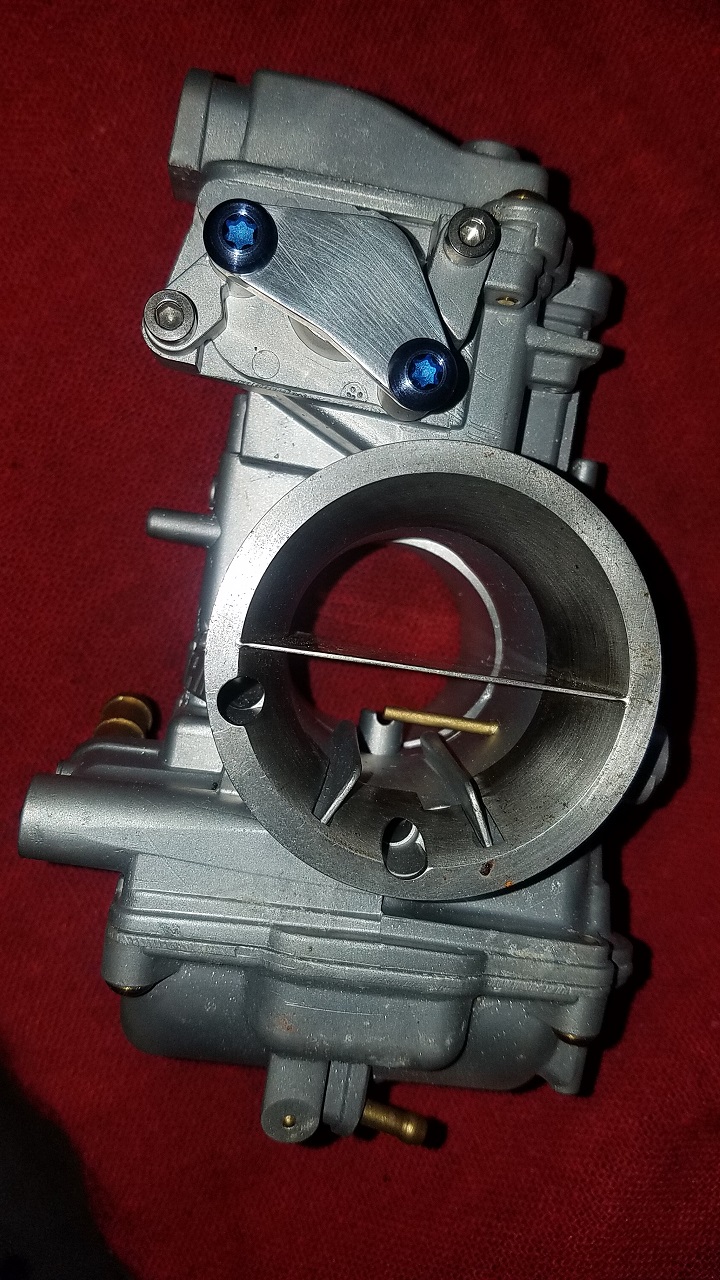

Re: Need a new carb for your KX500?
Just a few small details and she will be ready.
We used a New quad vent air striker for the Sunny Garcia build.
We used a stock kx500 cable and swapped the cable screw from the kx500 carb to the air striker.
The elevation was 3000 feet.
PC2 pipe
VF2 reed on the low tension settings
50/50 91 pump gas and 110
Mild porting.Stock compression.
Pilot 55
Main 162
NEEDLE-JET,N89D 16009-1613 on the top clip.
We likely could have ran a leaner needle.
But the bike ran beautiful.
