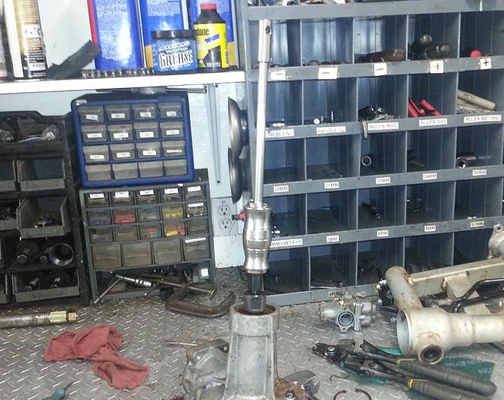

Re: Grease your stinkin bearings!!!
And believe me when I say that this bearing did not want to come out.
grease your stinkin bearings 4.JPG (86.14 KiB) Viewed 8676 times
grease your stinkin bearings 5.JPG (77.33 KiB) Viewed 8676 times
After the heat was applied it came out with some difficulty but, it came out.
If the previous owner had taken it to a shop to get it fixed it would have cost at least a few hundred dollars.
Why?
Cause the manufactures aren't putting any or very little grease in their bearings :o :shock: :?
SO GREASE YOUR STINKIN BEARINGS :ugeek:
