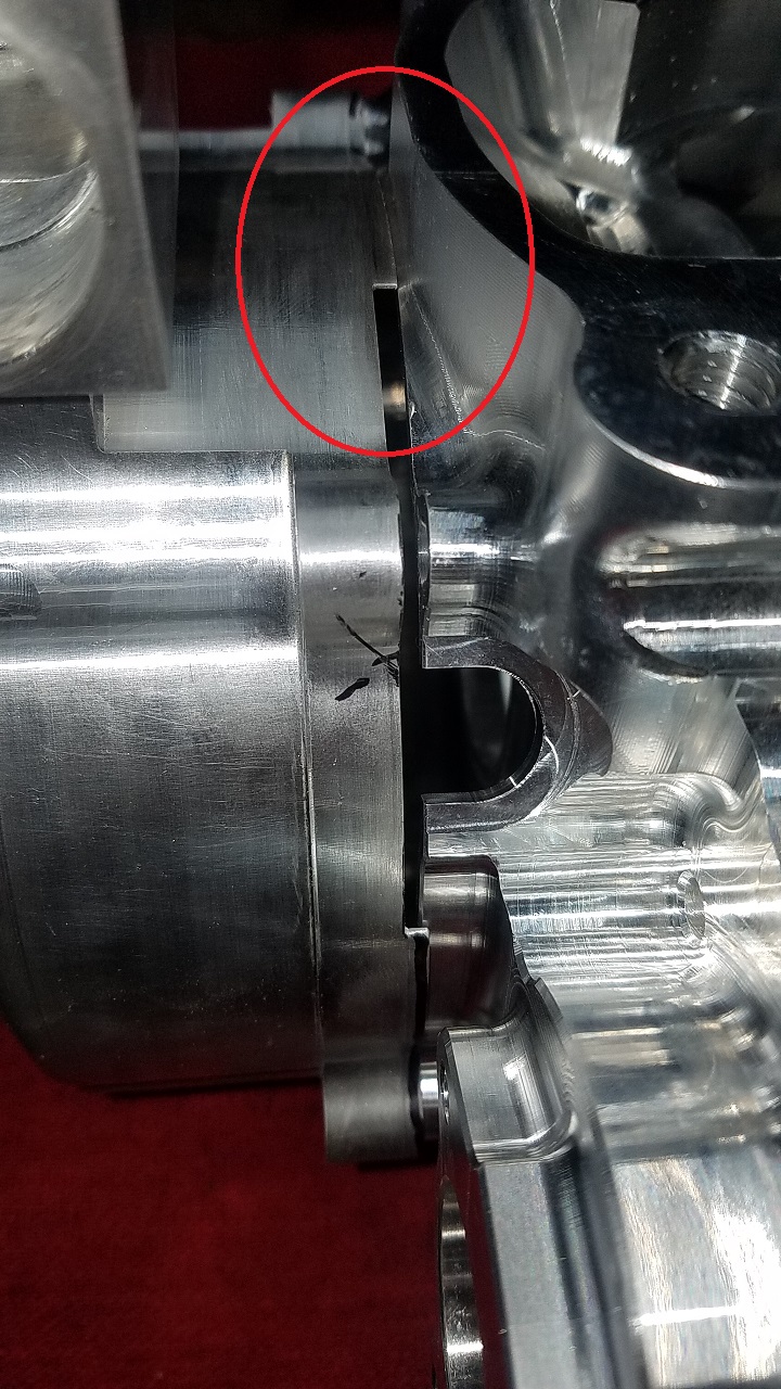

As you can see there is quite a gap between the cases and the starter housing.
The Panthera starter housing has a lip around the outside edge.
The lip goes most of the way around.
I suspect that it is there for alignment.
The issue is that part of the lip hits on the case.

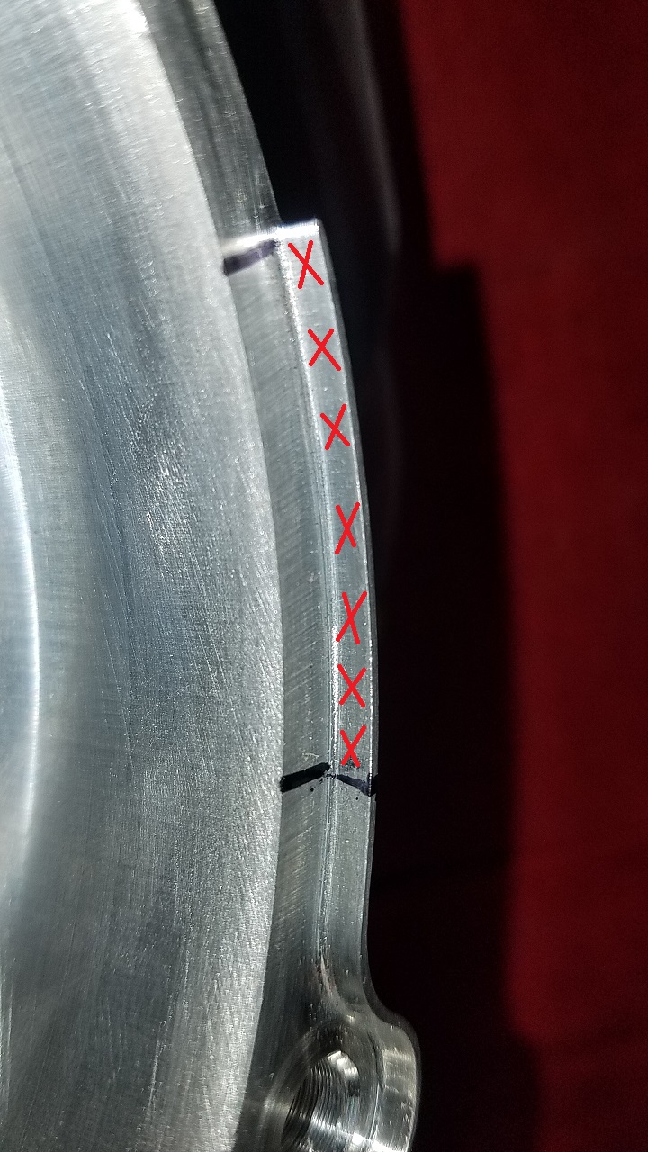

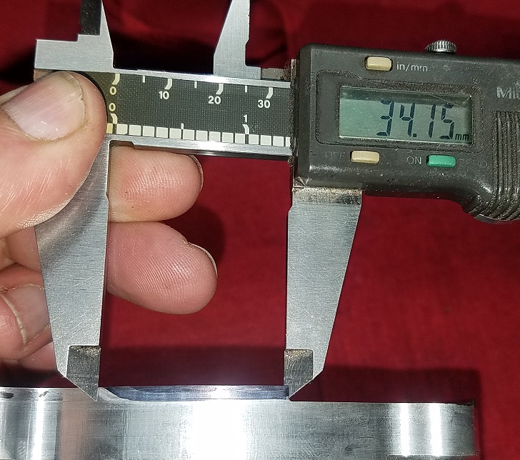

So a little material has to removed from the starter housing lip area.

I've got the starter housing ready to machine... Except I put a piece of tape over the vent area that is not shown in this pic..

In this pic you can see the area of the Engine cases that is interfering with the starter housing.

If you decide to do this project yourself but you don't have a milling machine, You can use a drill press, hand grinder, porting tool, Dremel, or a hand file :shock: Or, you could contact Sebastian before you buy a E-Start and ask him if he would be willing to machine that area off for you..
