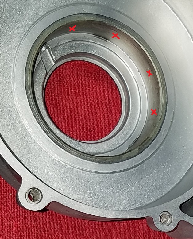

As the KX500's get older and older we see many that have had the main bearing journals in the crankcases worn out.
We have seen many different repair methods.
Some people use a punch or chisel and work over the ID of the journals.
That caused material to mushroom out and takes up the clearance.
Another fix is to use retaining compound and glue the bearing in.
Some have bored the journal out and shrink fit a small sleeve in.
We usually take ours in to a industrial plating facility and have the ID build back up to factory specs which is the longest lasting out of all these options.
