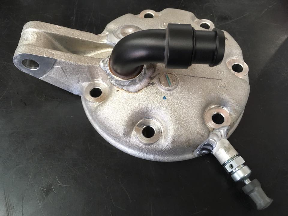

Here is a CR500 head that was modified by Adam Millar for his CR500 to KTM conversion.
This was set up for parallel cooling using a single outlet to feed the top of the radiators.
Obviously he will use a "T" to connect the top hoses to the rads...
