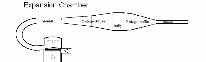

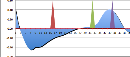

Primary Action
The main action of an expansion chamber is the creation of reverse waves (returning to the cylinder) that happen from the main pressure wave in it expanding and then contracting at the diffuser and baffle cones. The wave is first created when the exhaust blasts into the exhaust port. Graham Bell wrote that "changes in cross-sectional shape [area] affect pulse wave energy" which is another way of saying that the bigger the change in pipe area, the stronger the return wave from that area is. My Excel file, sheet 2, calculates the percentage area change along the diffuser and baffle every 10mm of their length. Putting the calculated numbers into sheet 3 will result in a graph of the return waves:

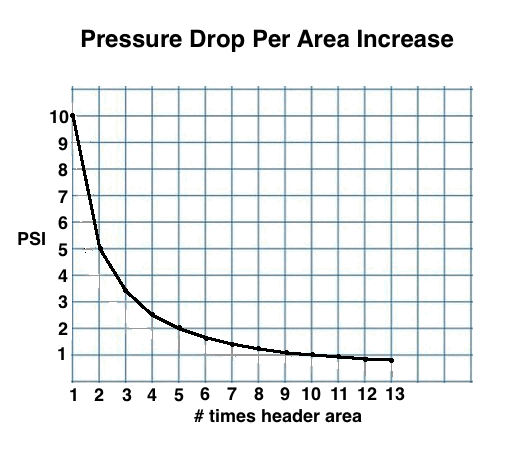

Header Diameter
This is the pipe that connects the cylinder to the diffuser cone. Gordon Jennings said its cross sectional area should be 15%-20% larger than the exhaust port area for maximum peak power, and 50% greater for motocross bikes (for a wider powerband). Most pipe builders just keep the same stock header diameter. My expansion chamber calculator lets you do whatever you want to but gives recommendations for header and belly diameter based on my own theories. What I don't like about his advice on headers is that it essentially disassociates its size from the size of the engine displacement and exhaust port blowdown area (which is the only part of the exhaust port I consider because all of the exhaust typically exits before the exhaust port is half way open). This topic of header size is important because both Graham Bell and Gordon Jennings give belly diameter recommendations that are 2.5 times that of the header. So they keyed off the header. The right diameter header is best for power because too narrow creates too much suction following the pressure pulse and causes more air/fuel loss from the cylinder. And too wide doesn't assist in pulling up intake charge through the transfers.
What type of powerband you want should influence your choice of header diameter you choose. Larger diameter headers will present a greater pipe volume. Following the exhaust pulse will be a negative pressure that will be minimalized the greater the pipe volume is. So a smaller than normal header diameter will allow more post-exhaust suction which has both good and bad effects. The good aspect of its influence is that it helps pull up intake charge through the transfer ports right as they open. This can be important when the transfer duration or blowdown is small for the intended RPM. The bad aspect is that the suction will cause the intake flow to be less toward the rear of the cylinder and more toward the exhaust port. This causes some loss of intake charge out the exhaust port. To know what is happening you need to see the intake flow pattern left on the top of the piston. It depends a lot on how close the transfers are to the exhaust port and whether or not their direction of flow is well toward the rear.
My idea on how to correctly size the header diameter is that it should be done by a formula using engine size, compression ratio, and open port area at the end of the exhaust pulse exiting the cylinder. And I recommend a maximum belly diameter as 2.55 times that diameter (but you can use any size you want and see how different sizes affect the final power graph). The formula I use agrees with the experiment done by Gordon Jennings with different header diameters for a DT250 where he found the best size for maximum power.
Most headers on high RPM MX and GP bikes are divergent up to 2 degrees. That is to say that they get larger with more distance from the cylinder. This theoretically aids exhaust gas flow at high RPM but reduces the diffusers return wave strength.

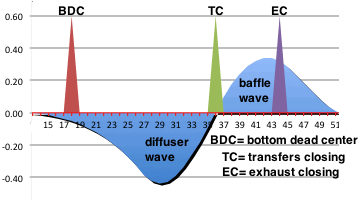

The Diffuser (expanding/diffusing) Cone
As long as the primary pressure wave is traveling along the diffuser it is creating a vacuum (negative pressure) wave that returns to the cylinder. From around 2500 RPM to peak RPM this vacuum wave returns when the transfer ports are uncovered and the vacuum either helps to suck in extra intake charge from the crankcase into the cylinder, or it prevents the suction into the crankcase of exhaust gases (due to crankcase vacuum) as the piston rises. Extra fuel/air contributes to a stronger/longer combustion for more engine power. Also less dilution of air/fuel by exhaust gases leads to a more powerful combustion due to a higher percentage of oxygen. This is what causes an expansion chamber to give more power than a header/muffler combo w/o diffuser or baffle cones.
* pipe powerband: the RPM range where the horsepower is increased due to the effect of the diffuser and baffles return pressure waves.
Diffuser Angle(s)
The two main considerations are: how many milliseconds long the return wave has, and what the shape of the diffuser is (whether it is a single cone or if multiple cones then what waveshape do they create so that it matches the type powerband you want). Greater angle of diffuser sections means the diffuser will be shorter. Jennings wrote in his Two Stroke Tuners Handbook that multi-coned diffusers cause a higher return wave peak which increases power. I would add that stronger return waves are more likely to suck out fresh intake charge from the cylinder unless the transfers have a good design so that they are good at directing the intake charge towards the back of the cylinder. Also the transfers roof angle comes into play as the more horizontal they are, the more likely the intake charge can be sucked out the exhaust port instead of heading up to the spark plug. Also a strong return wave may suck out too much intake charge if the front transfers are very close to the exhaust port. You can tell by looking at the pattern the intake flow leaves on top of the piston. (see example). The diffuser angles should also be in relation to crankcase compression ratio because a high ratio (1.5:1 or more) has more need of a strong vacuum wave from the diffuser to counter the crankcase suction as the piston rises after BDC. Otherwise some exhaust gas gets sucked back down into the crankcase. The advantage of a multi-coned diffuser: Since the main factor affecting the strength of the return wave is the percentage change of cross sectional area (every 10mm) then a single angle diffuser cone for my 55cc engine ended with a 6.5% area change (for the last 10mm distance of the cone) whereas a 3 stage cone I designed, although the belly cross sectional area was 9 times that of the header, ended up with a strong 9.1% area change at the end. A 2 or 3 stage diffuser causes the percentage area change to be more evenly spread out along the length of the diffuser instead of having very strong changes at the beginning (15.5%) and very weak changes at the end (6.5%).
Click here to see how different diffuser designs result in different return wave shapes and amplitudes. Click here to read more about diffuser cone angles.
Maximum Cross Sectional Area of Diffuser
According to Graham Bell the maximum diameter at the end of the diffuser (at the belly) shouldn´t be any more than 2.5 times the beginning header inner diameter. This is equal to an area 6.25 times that of the cross sectional area of the header. My recommendation after much study of different engine/pipe/dyno results is to use 6.5 times the area instead which is 4% bigger.

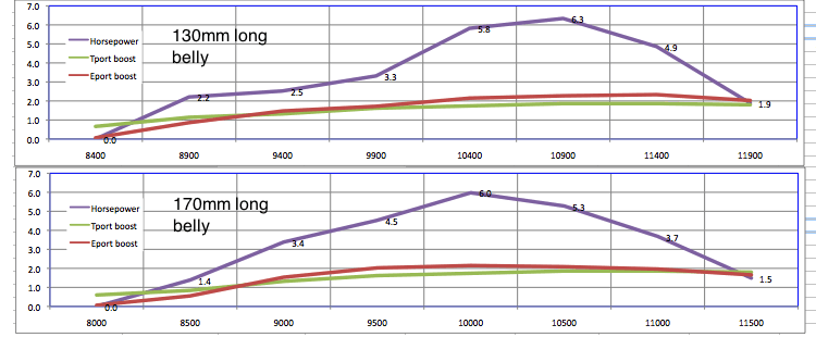

Belly
The belly exists to keep the diffuser and baffle waves from overlapping too much which would cause a canceling of their pressure differences. You can see in the graph below (calculated using Boyles Law) that as the belly width increases there is a more minimal pressure change and therefore a minimal return wave strength. 10.3 psi is a typical exhaust pressure peak in the header which is the beginning pressure in this graph. It is the pressure changes in the exhaust wave going thru the pipe that cause the secondary waves to return to the cylinder. The more pressure change, the stronger the return wave is. So although there are pressure changes all the way up to 12 times the header area it is just not recommended to expand that far.

Header Diameter

Belly
Re: Wanna build your own 2 stroke pipe? Read this first
If the belly is too wide then that causes the end of the diffuser and the beginning of the baffle to be "dead zones" that cause very minimal return wave strength and so in essence lengthens the virtual belly. That is why some people think that having a wide belly widens the powerband (at the expense of peak power). Well, it does but only because it's causing a longer effective belly section at the expense of the diffuser and baffle lengths. Look at the graph below to see how the end of the diffuser wave and the beginning of the baffle wave are extended weak areas of wave strength which looks almost the same as if the belly were much too long (much longer than the actual 90mm the pipe had). The belly width was 129mm when it should of been no more than102mm.
With most bikes there is limited space which sets the maximum diameter of the belly and so the diffuser and baffle have to be designed to accommodate the belly diameter. It is always parallel-walled. When designing a pipe it is always best to make variations to it and note the results at the power graph. Below are two graphs showing the difference in pipe powerbands for 2 belly lengths with a single cone baffle. You can see how a longer belly has peak power 500RPM earlier in the powerband and a more linear rise in power. The purple graphs are the pipe power graphs.

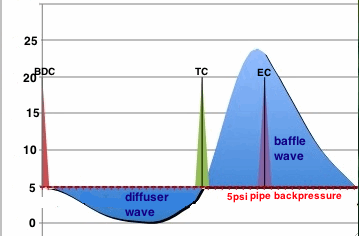

The Baffle Cone
The purpose of the baffle is to create a return wave so that at high RPM the return wave arrives back at the cylinder before the exhaust port is closing in order to increase cylinder pressure. Without it the piston will push intake charge out the exhaust port as it rises. Providing a pressure to match or exceed the pressure created in the cylinder by the ascending piston (~5psi) is the reason for the baffles return wave as well as increasing dynamic engine compression. Doing both things increases engine power at high RPM. Unfortunately, at all engine RPM except near peak RPM, the return wave returns when the transfers are open and tends to push exhaust gas and/or intake charge back down into the crankcase from the cylinder via the transfers which limits mid range engine power. But if you want an engine with explosive power on top then you have to have a strong baffle return wave. The baffle should be designed to match the bikes RPM range of the needed powerband which takes precedence over the peak power you want. A longer baffle due to a lesser angle will allow a slightly wider pipe powerband, but its main advantage is less power loss when the engine RPM is just below the RPM range of the powerband.

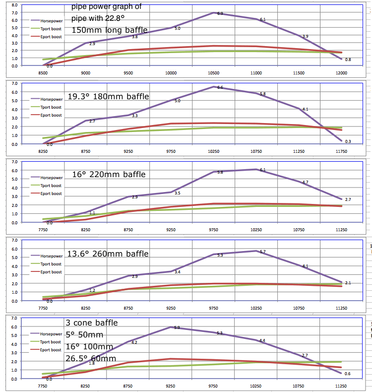

Angle
For a single angle baffle cone the steeper the angle the stronger the baffle return wave and the stronger the supercharging effect. Lesser angles cause less peak power but don't restrict pre-powerband power as much as a steep angle and so are better for trail bikes and street bikes (although you can eliminate that power dip with a boost bottle). Making a 2 or 3 cone baffle with lesser angles gives more power at the beginning of the powerband (and less at the end of it). Most racing bikes just use a single angle cone. My expansion chamber calculator ECcalc is useful for calculating the baffle return wave length and shape.
Here's some graphs showing the changes of pipe power from different baffle angles. Take note of the last graph which is from a baffle with 3 cones of increasing angle. This is best for enduro bikes because its peak happens 750RPM earlier than the 13.6° baffle and has about the same peak power.

Angle

Stinger/Silencer
The stinger acts as a bleed off valve for the pipe. It controls the amount of average pressure in the pipe. More pipe pressure adds to the baffle wave and detracts from the diffuser wave. So too narrow or too long a stinger will decrease the diffuser wave too much. The pipe pressure caused by the stinger increases with RPM so that the highest pressure is at top RPM which is why it hurts the diffuser wave the most there, more so than at mid RPM.

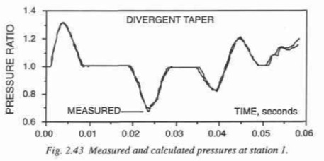

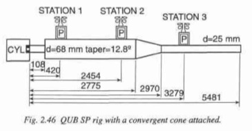

Details from "Design and Simulation of Two Stroke Engines"
by professor Gordon Blair:
http://www.dragonfly75.com/motorbike/2StrokeDesign.pdf
Here is the graph from page 181 showing the sensor #1 sensing the initial pressure wave, and then the negative (vacuum) return wave, then the return wave bounced back from the closed cylinder port, then the wave reflected back from the diffuser as a positive wave:
What is most important about this test is the recorded time it takes for the wave to travel these known distances. The distance, in meters divided by the wave speed, in meters per second (mps), gives the time of wave travel. (m/mps=time) This test proves that the negative return wave is reflected back all along the length of the walls of the diffuser cone. Doing a graphical analysis of the wave graph I determined the initial positive wave was 7.2 milliseconds wide and that the negative return wave was 8.8ms wide. The increase in width is due to the length of the diffuser, at the end of which is where the last of the positive wave reflects back from. The way to calculate the return timing and length of the negative wave in a 2 stroke expansion chamber is by this formula: WRT1=(D1x2)/SW where WRT1 is the wave return time for the first part of the wave, D1 is the distance from cylinder port to beginning of diffuser, and SW is the speed of the wave which is determined by the temperature and chemical composition of the exhaust gas (and almost impossible to calculate). To figure the return time for the end of the wave is WRT2=((D2x2)/SW)+WW/2 where D2 is the distance from port to the end of the diffuser, and WW is the width of the initial wave which is figured thusly: WW=(60/RPM)xBD/360 where RPM is the top engine rpm, and BD is the blowdown in degrees (exh ATDC - transfer ATDC).

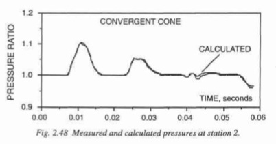

Baffle Cone and its Return Wave

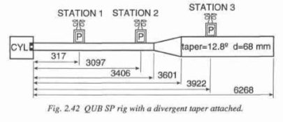

Next we can glean information from his test on the baffle cone:
Doing a graphical analysis of the wave graph I determined the wave action can be determined in the same way as with the diffuser cone except that the return wave is positive instead of negative. The return wave starts its return at the beginning of the cone, and the end of it begins its return at the end of the cone. This effectively defines the return action of the wave in a very specific way, with no room for other theories.
