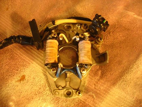

We are once again back to people wanting information on how to do the MSV Racing Dual Source Coils in Series Mod. Here is the tutorial and some pictures to help you complete this neat high performance upgrade on your CR500 stator.

Pulse Gap is set at .012"
Plug and Gap BR8EIX @ .030"

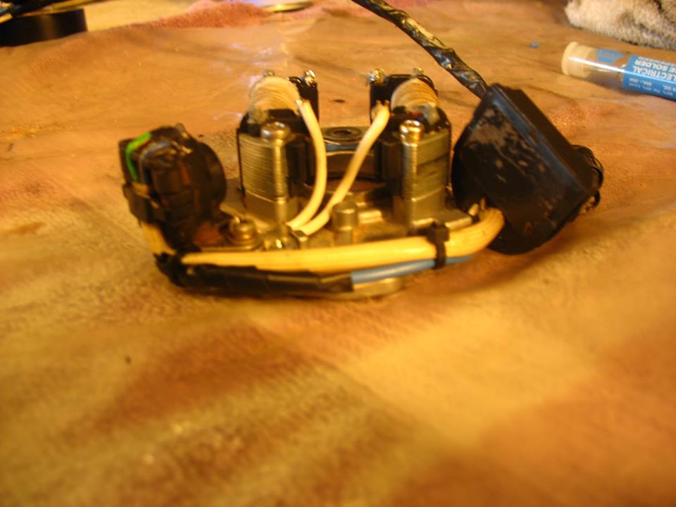

Simply unsolder the wire on the bottom of the original source coil. Route it nicely to the top of the new 2nd source coil. Cut off excess wire length, strip wire and solder it to the top of the new 2nd coil. Take the piece of wire you cut off and route it similar to the picture to attach the bottom of the 2 source coils. Strip wire and solder. Done and congrats!
