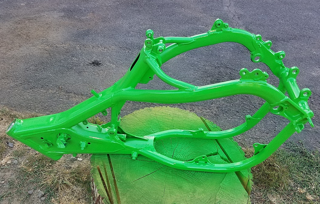

After the welding was done I put a rattle can coat on to protect from rust.
I will have the frame powder coated once the final mock up has been finalized.
KX GURU RACING KTX500E BUILD 123.jpg (514.91 KiB) Viewed 9455 times

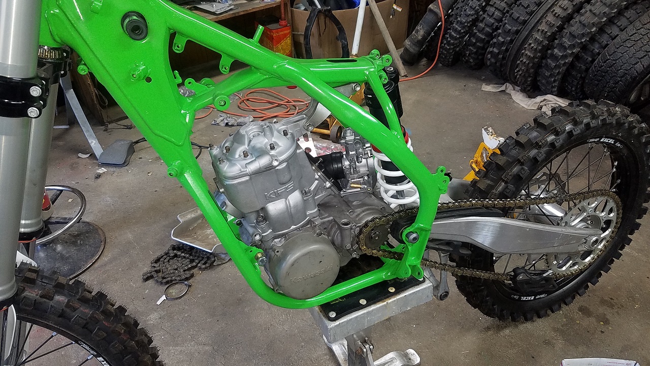

Next, I did a quick mock up to be sure everything was still perfect.
KX GURU RACING KTX500E BUILD 124.jpg (519.95 KiB) Viewed 9455 times
Oh yeah... I'm smiling... Every bolt lined up perfectly.
