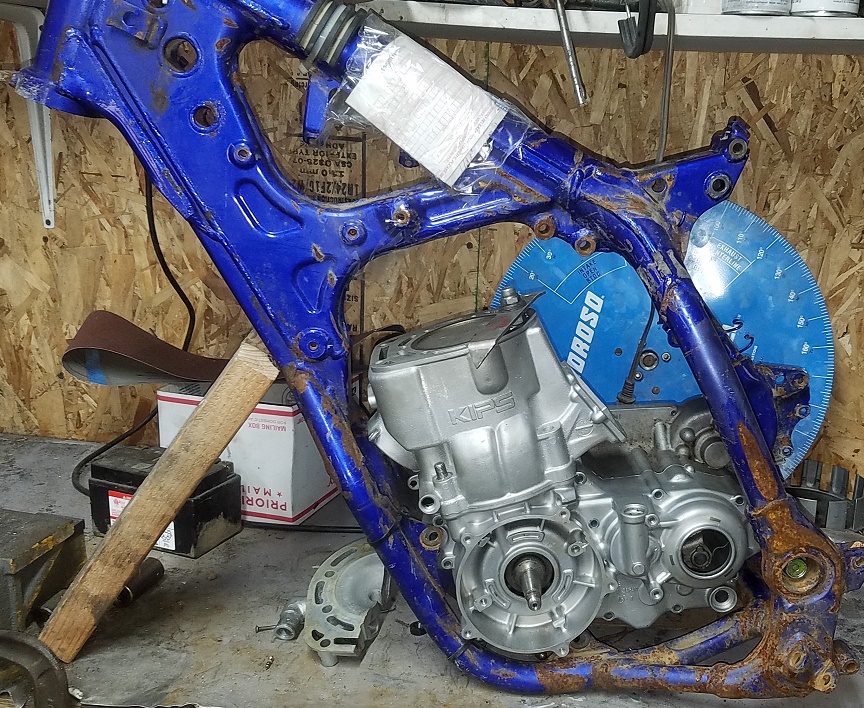

KX500 Engine is a 99 and up YZ250 chassis, can it be done?
Easy answer is YES!
You can make anything fit if you have the skills, time, and money :lol:
However, I think this one will be fairly straightforward and not too difficult.

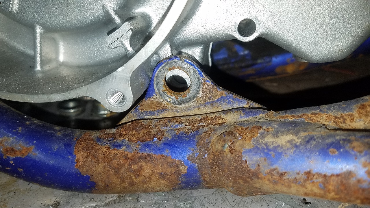

One of the first things you need to do is drill out the KX500 engine cases to 17mm to fit the swingarm pivot pin..

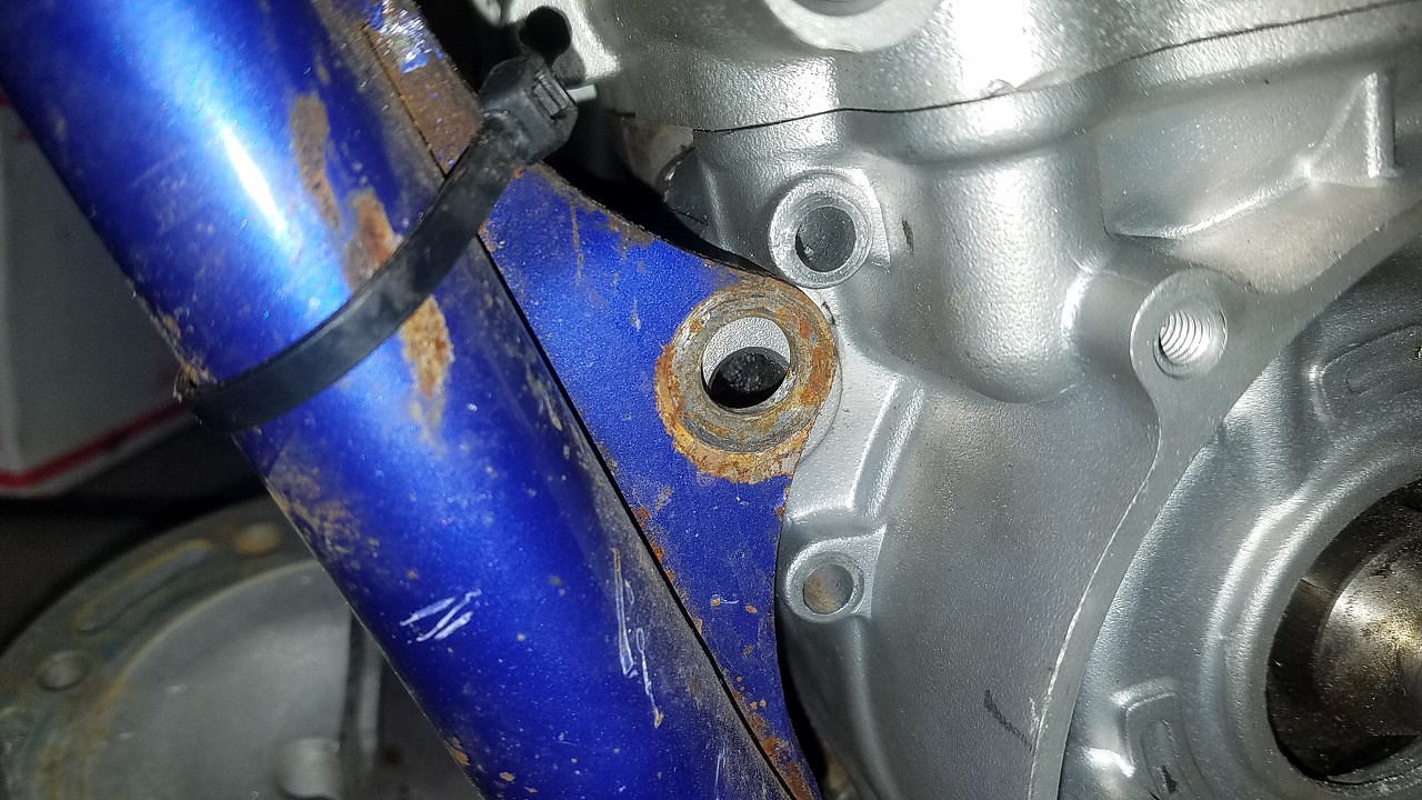

You will need to re-locate your engine mounts.
If your careful you can re-use the stock mounts tabs..
There is a member that is considering trying this so stay tuned for more info :shock:
KX GURU RACING KX500 ENGINE YZ250 CHASSIS 101.jpg (386.56 KiB) Viewed 4467 times
KX GURU RACING KX500 ENGINE YZ250 CHASSIS 102.jpg (508.3 KiB) Viewed 4467 times

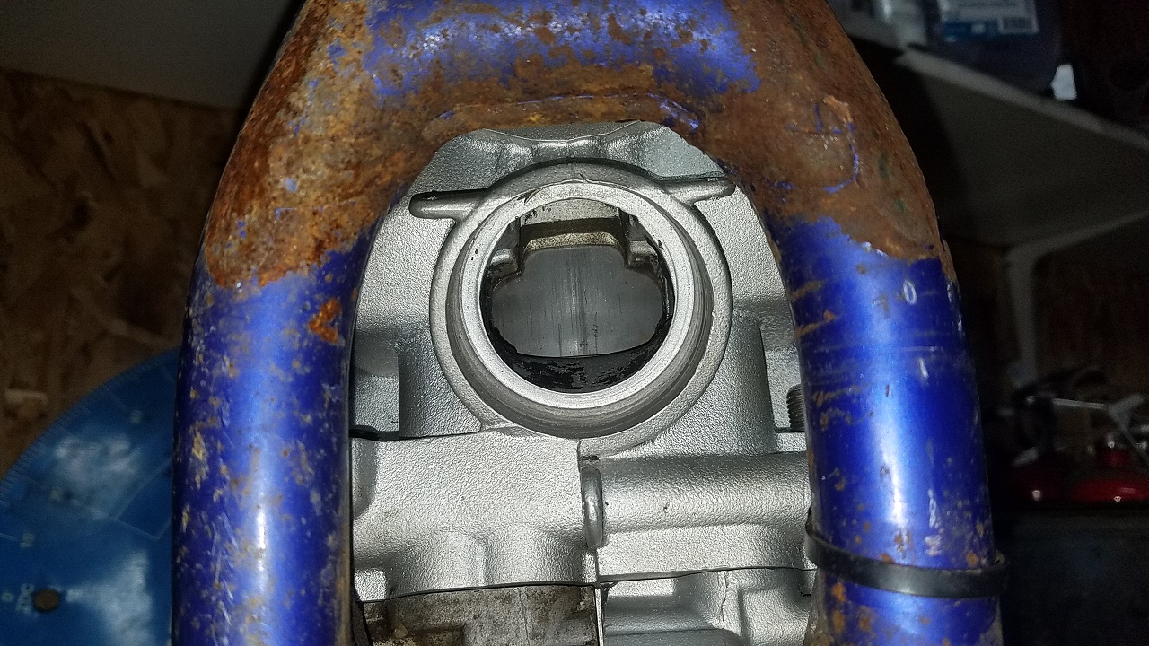

KX GURU RACING KX500 ENGINE YZ250 CHASSIS 103.jpg (475.87 KiB) Viewed 4467 times

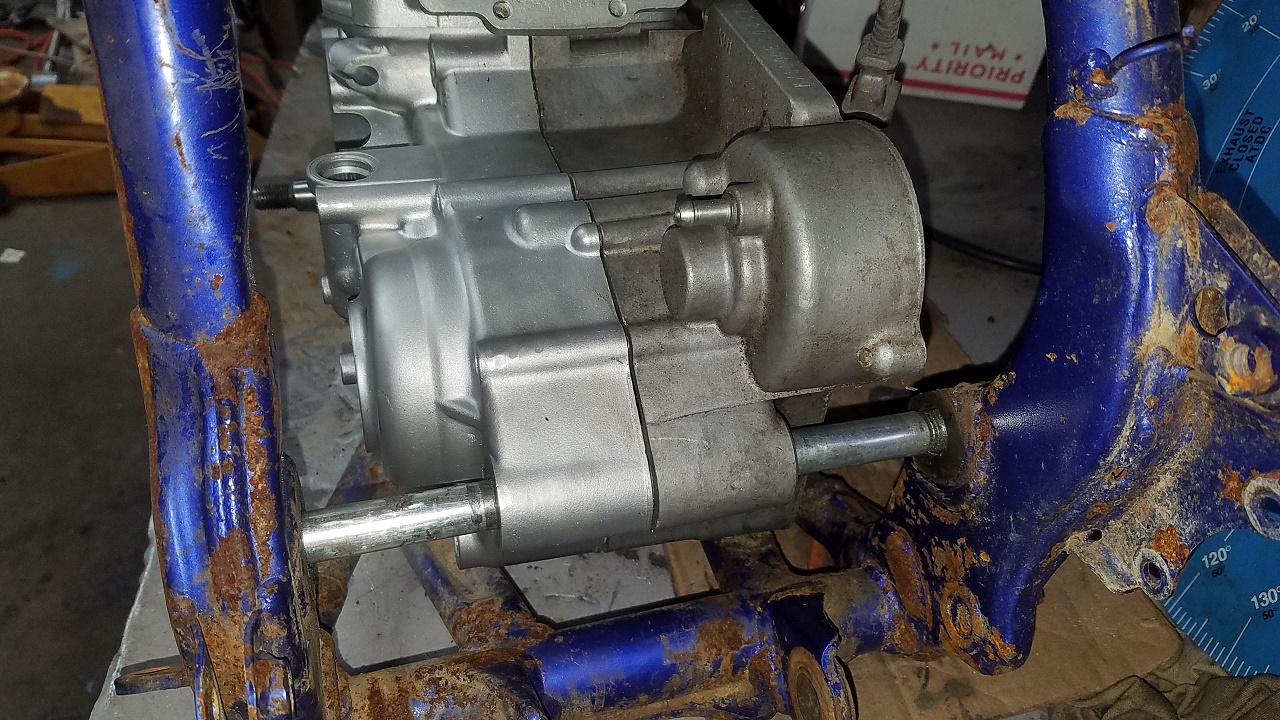

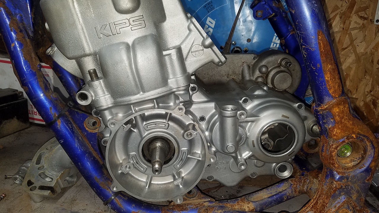

Re: KX500 Engine is a YZ250 chassis can it be done?
KX GURU RACING KX500 ENGINE YZ250 CHASSIS 104.jpg (505.06 KiB) Viewed 4466 times
KX GURU RACING KX500 ENGINE YZ250 CHASSIS 105.jpg (443.02 KiB) Viewed 4466 times
KX GURU RACING KX500 ENGINE YZ250 CHASSIS 106.jpg (444.11 KiB) Viewed 4466 times
