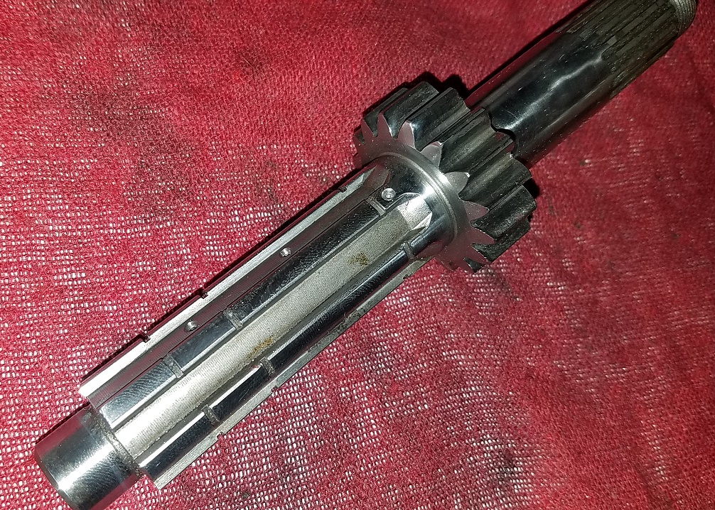

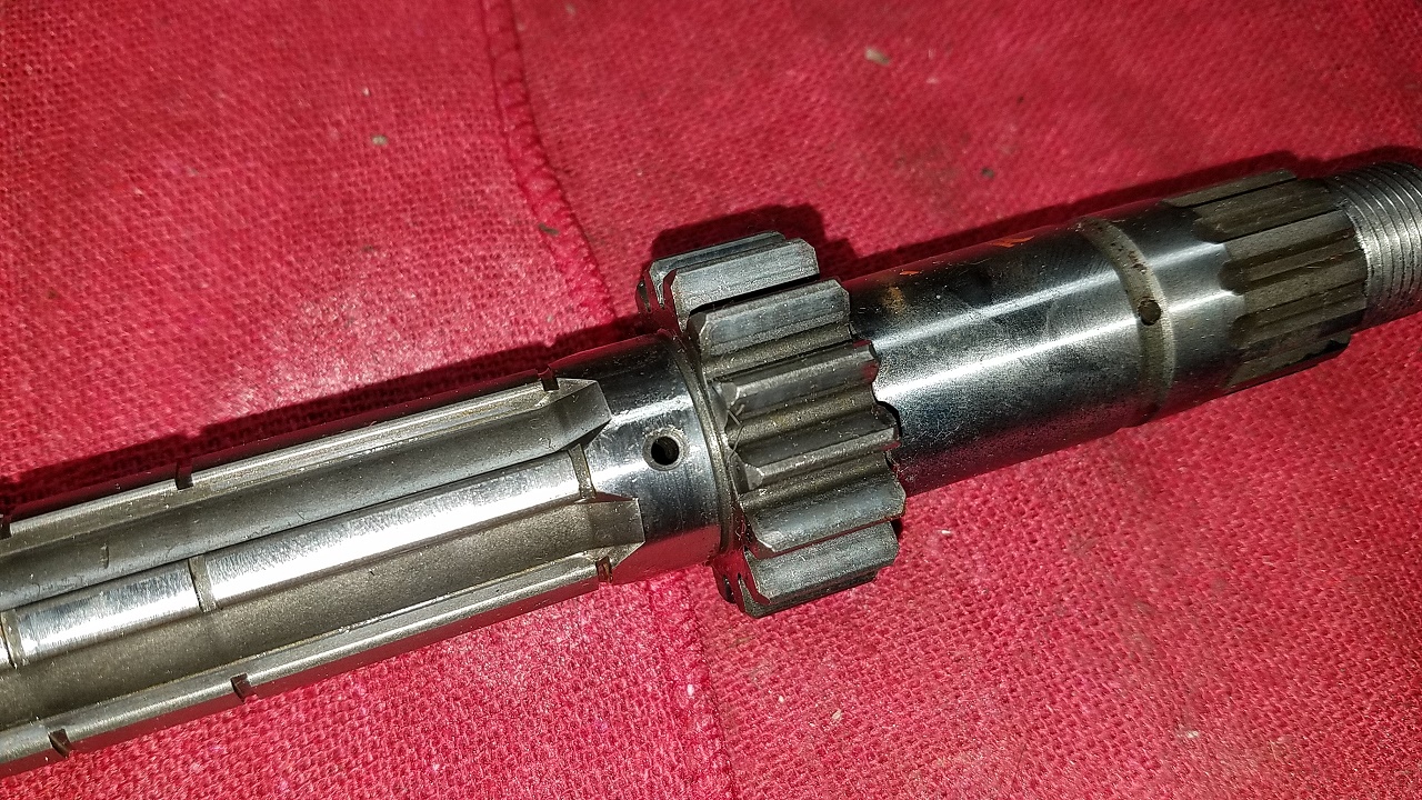

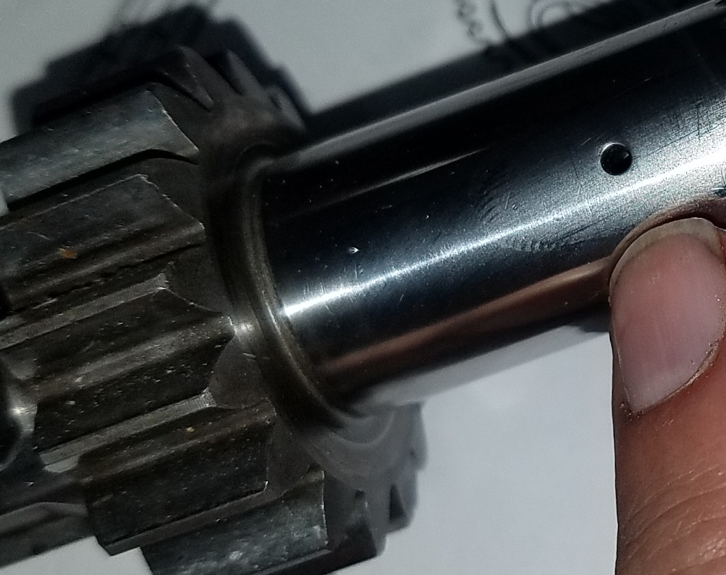

Other manufactures simply drill some holes in the shafts... Likely before the shafts are hardened :o
I used a double straight flute 1/16" drill bit that I purchased from Grainger.
Drill at a very slow speed is required with a lot of oil or coolant.
When you start drilling the surface metal is very hard but once you cut past the hardened surface metal it drills very easy until you start to break through into the center of the shaft which is also hardened.
I broke both my bits and now have to remove some hardened drill bits :x
After drilling I chamfered the holes with some diamond grinder bits then ran the shaft on a polish wheel.
The finish is very smooth and I believe this will help keep your trans running smooth for many years...

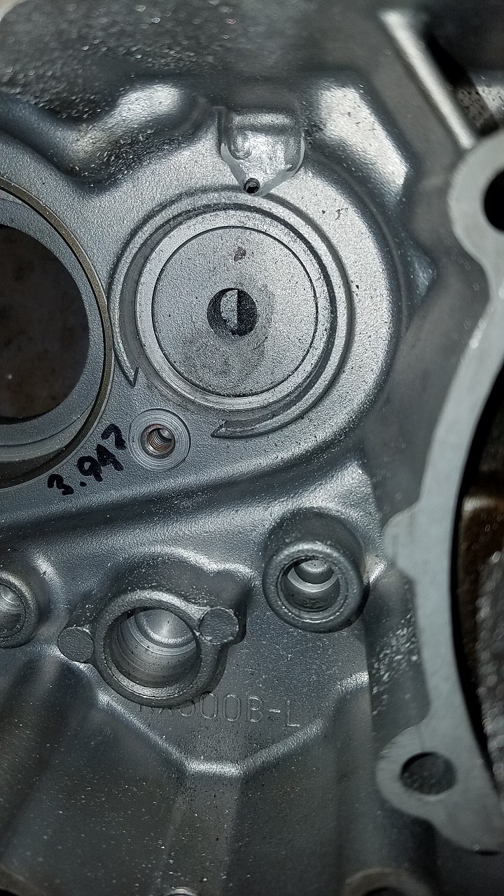

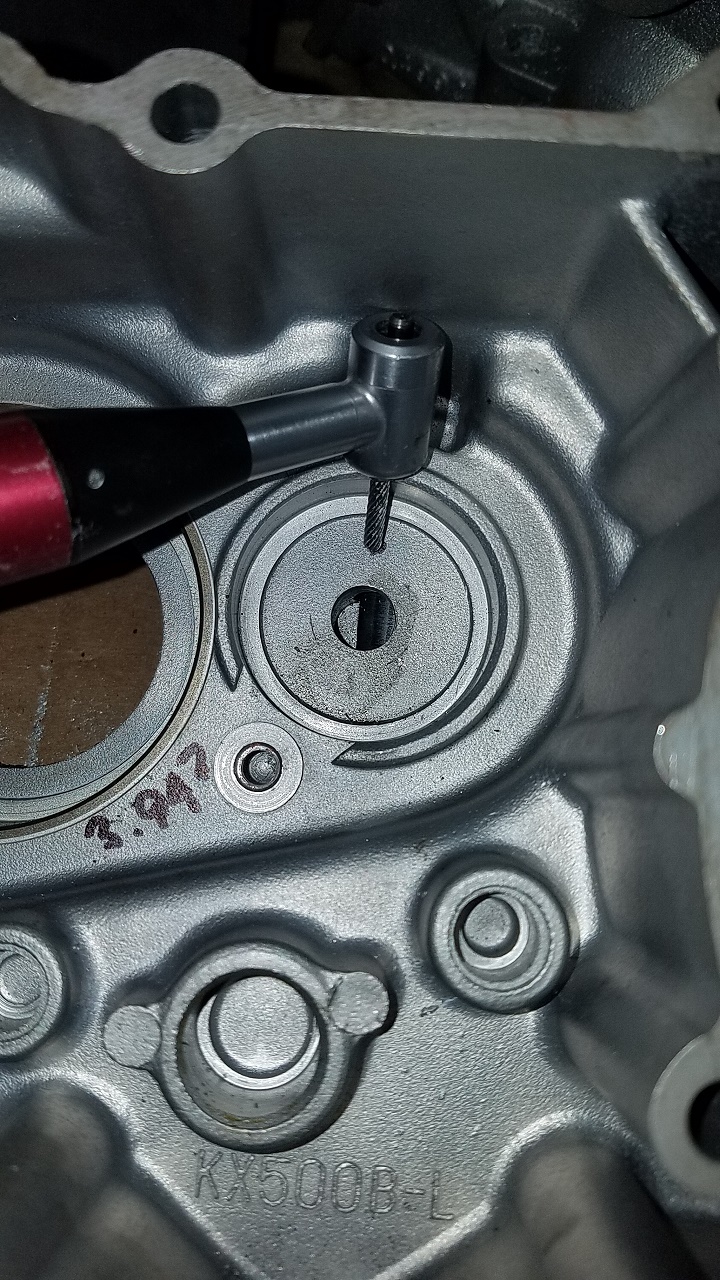

One, is to use a porting tool and bore a hole at an angle back into the clutch puller cavity such as this.
KX GURU RACING TRANSMISSION OIL MODS 105.jpg (460.12 KiB) Viewed 10572 times
The oil should pass through the bearing and feed the oil hole.

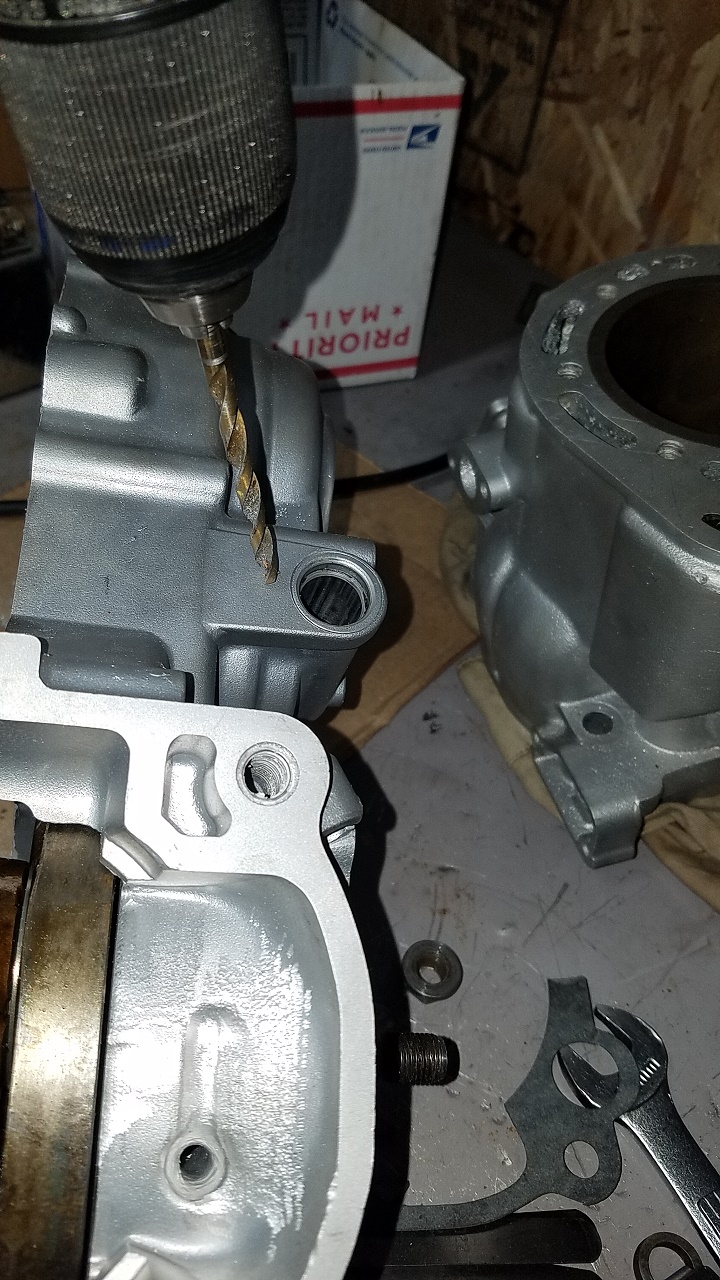

The other way I see is to bore a small hole from the outside of the case at an angle to just miss the clutch puller upper bearing, cut through to that ledge above the bearing and then into the clutch puller cavity. The only issue, and it's not a big one is that you will have to have the hole on the outside of the case tig welded.. After this is done you could reshape the ledge above the bearing to hold a reservoir of oil.
KX GURU RACING TRANSMISSION OIL MODS 106.jpg (407.44 KiB) Viewed 10572 times
And the drill bit shown is for demonstration purposes only... I would use a much smaller bit.
I couldn't find a smaller one that was handy :o

Here is a pic of the ledge that is above the bearing..

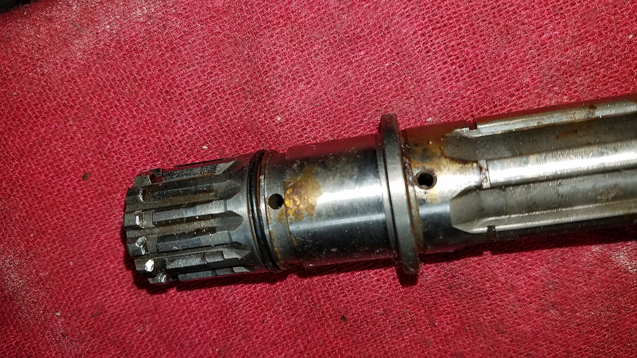

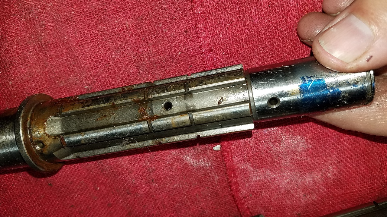

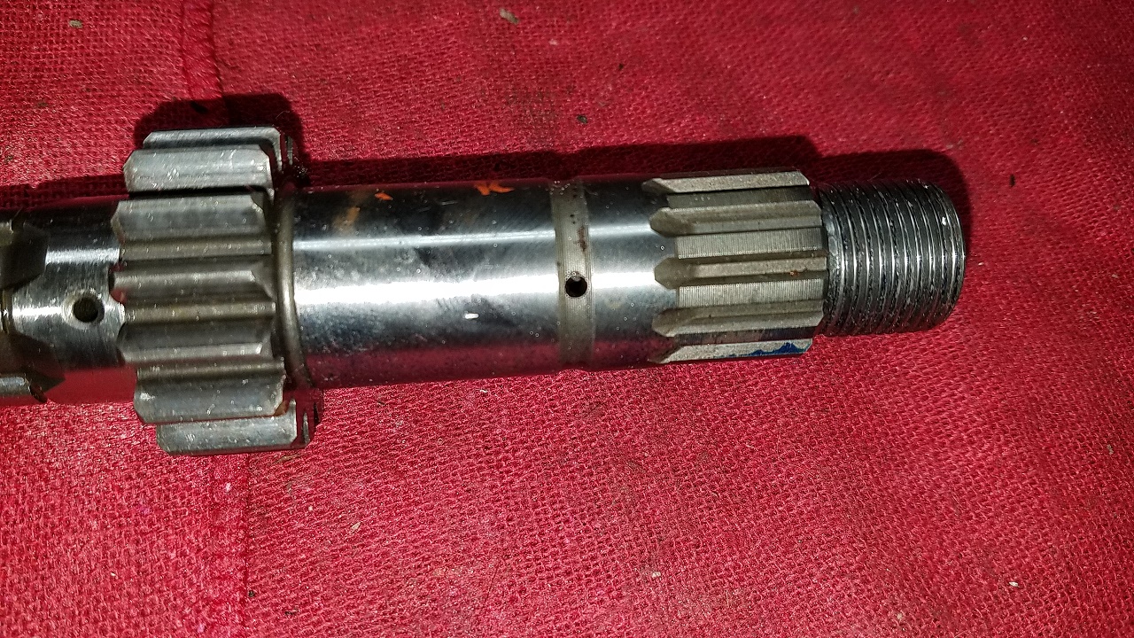

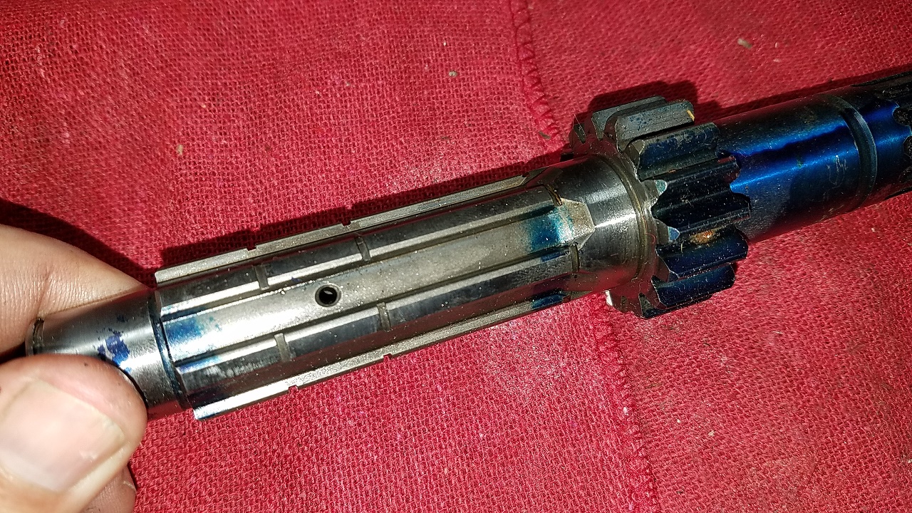

A few years ago a buddy of mine wanted to try to build a wide ratio trans for a KX500. One of the trans I sent him was from a KLR650. With a minimal amount of lathe work he was able to get it to work. At the time we decided that it wasn't worth the effort for the little difference in gearing. But lately I'm thinking that it may be a back up plan. As a lot of you know several of the gears are no longer made and this issue will get worse over time. Jason Tanner sent off two complete transmissions to have all the gears undercut. That will prevent them from slipping out of gear ever again and hopefully breathe some new life into some older sets. We will let you know how that is working out. While I had the KLR650 transmission out I took a look at the shafts... Note anything familiar?

Re: KX500 Transmission shaft mods.
Yes... oiling holes... I have seen many KLR650's with 50,000 plus miles on them so I'm more convinced that drilling some holes will be a good idea...
Oh... These holes were .093" in diameter...
The ones I drilled were .060" in diameter... Which is good because small holes are really hard to drill in hardened material..
The .093" diameter carbide straight flute bits did the trick.
I'm 4/4... 8-)

This is how I modded this case to capture oil and feed the end of the transmission shaft.
KX GURU RACING KX500 TRANSMISSION MOD 101.jpg (496.15 KiB) Viewed 10466 times
I probably got a little carried away with the porting tool.
While I'm sure this will work, I won't go quite as deep on my personal cases.
