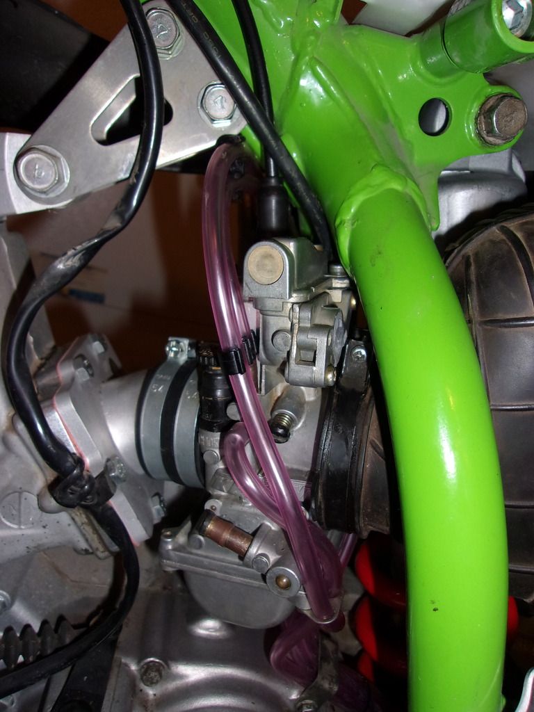

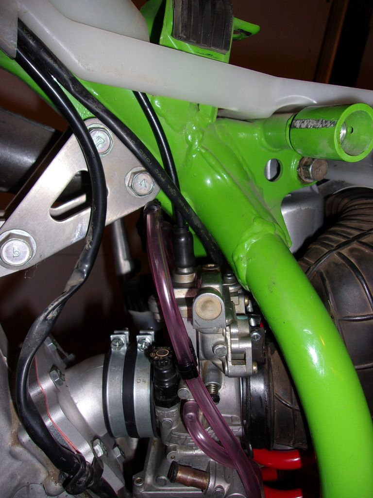

Re: Need a new carb for your KX500?
Hmmm... I'm having some strange thoughts.. :shock:
KX GURU RACING 2016 KTM 250SXF KX500 CONVERSION 183.jpg (298.68 KiB) Viewed 16938 times
KX GURU RACING 2016 KTM 250SXF KX500 CONVERSION 184.jpg (242.54 KiB) Viewed 16938 times
KX GURU RACING 2016 KTM 250SXF KX500 CONVERSION 185.jpg (310 KiB) Viewed 16938 times
KX GURU RACING 2016 KTM 250SXF KX500 CONVERSION 186.jpg (258.87 KiB) Viewed 16938 times
Post by moto939 »
Have you tried test fitting this carb? If you have not, you'll eventually find an interference issue with the tank and the carb cap.
Shouldn't be a huge deal to modify the cap since the tps is removed from the carb. I'm hoping that's all that's needed.
The short bodied carb I have not tried it just yet.
It's still sitting about a foot from my computer :(
I have so many project going on right now it's crazy.
KTX500E
Sean Collier's engine.
Sean Collier's rear brake mod.
K5 trans mod.
K5 drum valve mod.
K5 Turbo crank mod.
K5 92mm Big bore Mod.
And probably a few others if I were to take a look around my shop :lol:
It will fit my KTX500E with no issues as I have a ton of room.
But my basic K5 may have some issues..
The 96-97 KX250 and 00 CR250R carbs ( 38mm quad vent air striker) will fit with no issues as one is on Sean's bike right now..
Post by moto939 »
The carb fits fine, other than the cap hitting the inside of the tank on the left side.
The welch plug area will need to be removed and tapered back towards the cable in the center......or at least that's the plan. :o
