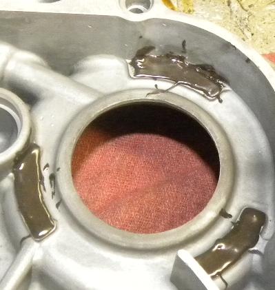

When I scuffed up the surfaces in preparation for the JB-Weld I didn't put the JB-Weld on right away.
In fact, I cleaned them up with some carb cleaner and let them sit overnight.
The next morning I noticed that the aluminum was already a little darker and not as shiny as it was when I first cleaned it up.
So I did a little research and it turns out that the oxygen in the air will start causing the aluminum to oxidize almost immediately.
From what I found, within an hour a skin can develop which will inhibit the bonding of the JB-Weld to the aluminum.
It may not be much but why take the chance?
So I cleaned mine up again before applying the JB-Weld.
Re: Prepping a set of KX500 engine cases for rebuilding

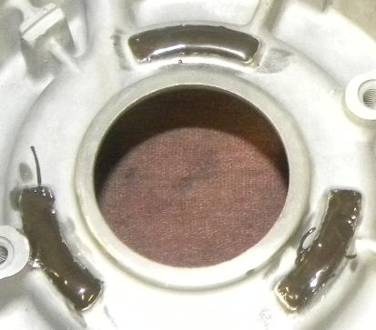

Here is how my cases looked after applying the JB-Weld.
kx500 engine case jb-weld 1.JPG (27.51 KiB) Viewed 13887 times
kx500 engine case jb-weld 2.JPG (21.35 KiB) Viewed 13887 times
Not the neatest job of applying the JB-Weld but I think it will work.

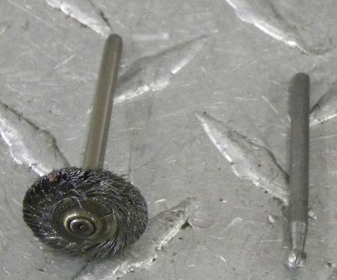

Another thing that may help you is the tools that I used to clean the cases up.
Besides the punch I used a wire wheel (Left).
However, I felt as though it may have left too smooth of a surface so I used a small cutting tool (Right).
Man, did that do a quick and nice job of cleaning.
Because of the radius shape it was easy to get into all the nooks and cranny's.
A word of caution.... This thing cuts QUICK!!!

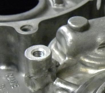

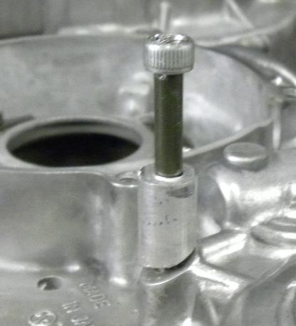

Had to fix the tower for the counter sprocket guard :(
So I got a piece of 1/2" round stock, drilled and taped it, also left it long.
Chamfered the angled end.
Ran a bolt through it to hold it all together.
Also, I ran a bottom tap all the way to the bottom of the tower hole as there was very few threads left.
tower fix.JPG (20.72 KiB) Viewed 13885 times
Then I took it next door and had my buddy weld it up for me.
tower fix -2.JPG (16.1 KiB) Viewed 13885 times
Once it was welded, I removed the bolt, ground the tower to the correct length, countersunk the end and cleaned up the edges.
I won't grind the weld down to clean it up because there is very little penetration and I don't want it to break off for no good reason.

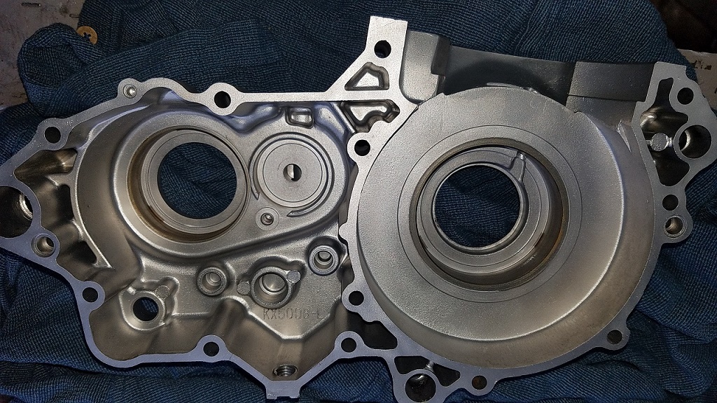

Since this was originally wrote, I invested in a vapor blaster and it was one of the best things I have done..
Now our cases are amazing 8-)
And no media impregnation...

I might have missed something, but what was the purpose in filling those 3 voids on the outside of the case halfs?
Sometimes the steel insert leaks all the way through the case so it's just a little extra insurance..
