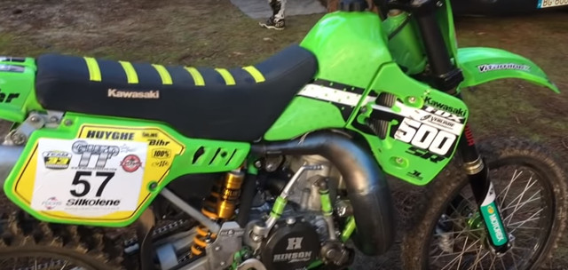

what is the ohlins rear shock model compatible, In France I saw many kx500 with ohlins shock!
but what is the model, any idea?
thanks
Re: Consolidated KX500 Suspension upgrades
They were specific to the KX500.
They are more prevalent in Europe than in the USA.
They are hard to find.
