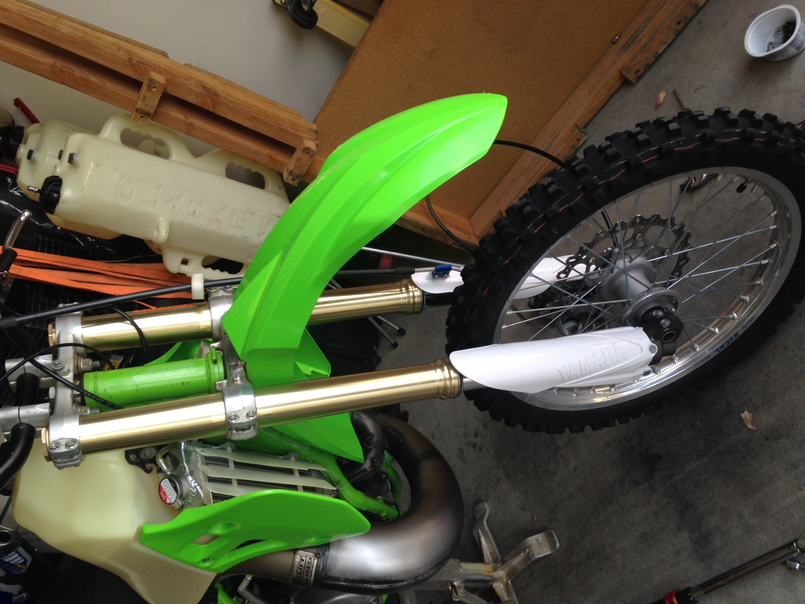

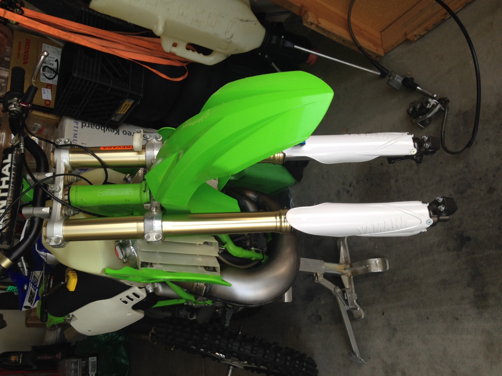

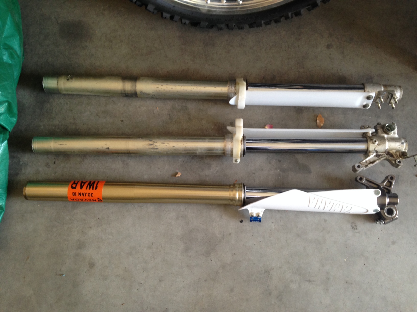

Here are a few pics of my fork swap. I picked up a 2000 KX500 about a month ago. I own a 2016 YZ450FX, so did some measuring and research before I even bought a 500 and learned that the Yamaha stuff is real close. I used a caliper to measure the diameter of both sets of forks, but since it is just a cheap Harbor Freight caliper, I doubt it is exact, but I figure the difference in measurements between the two forks should be pretty close. The top clamping area was on a difference of 0.01 mm, while the lower was 0.3 mm difference. Just used the stock KX triple clamps, and the YZ stuff slid right in, also used the front wheel and brake from the YZ. Haven't been able to take the KX out to the desert yet (need to rebuild the rear shock before I actually ride it) but the forks were pretty nice on the YZ, so hoping they will be just as nice on the KX.

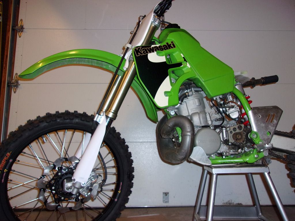

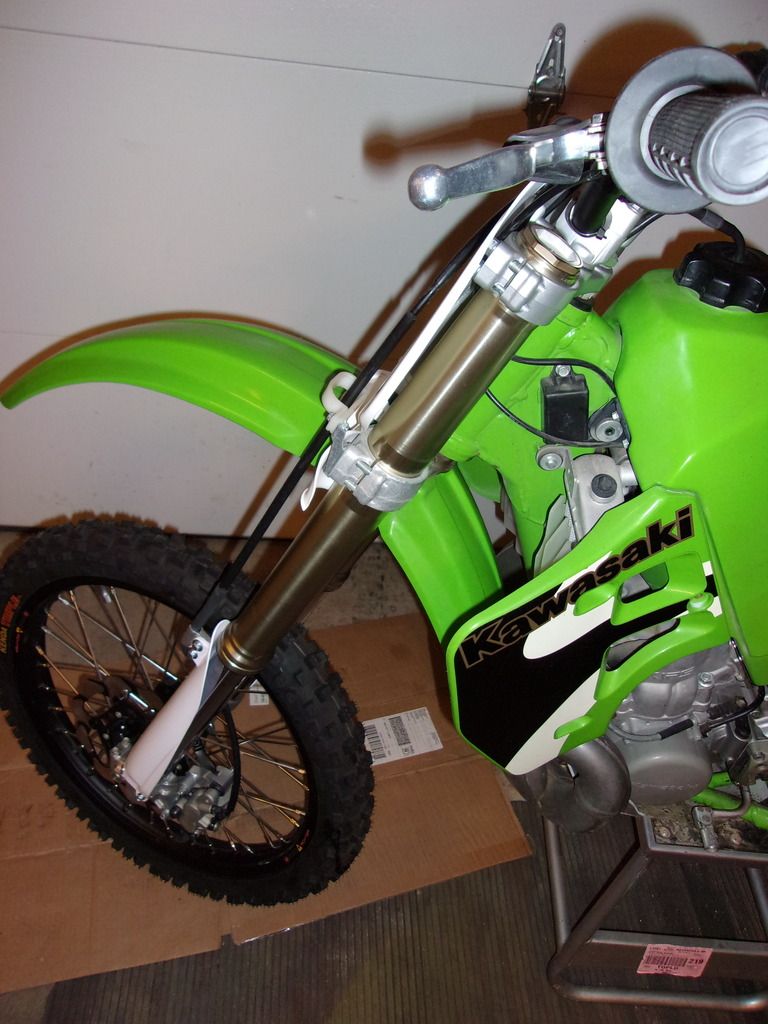

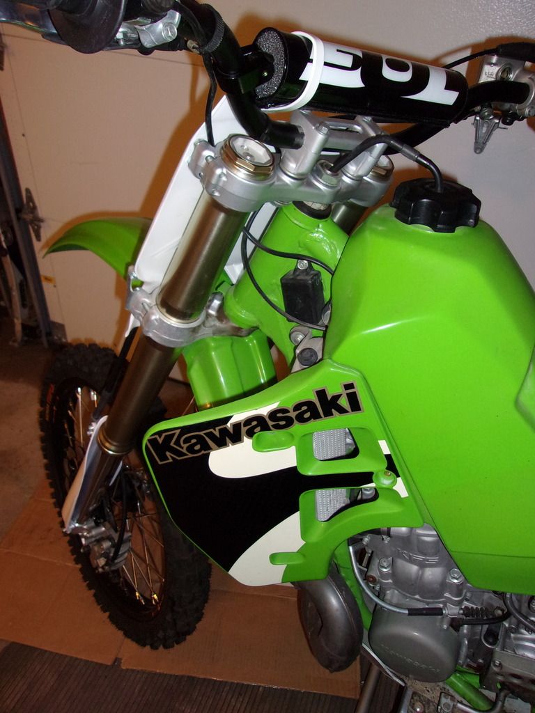

I have been wanting a 500 for a while, but Seans bike build finally got me off my duff and buy one. I found this nearly spotless '01 on Craigslist and after a 8 hour drive and seeing it, I couldn't give the owner money fast enough. Original tires, chain, sprockets, bars and grips, it definitely a legit low hour bike......if it had more than 5-6 tanks of gas thru it, I would be surprised. Good base to start with.
So I machined the top triple to fit a set of '09 YZ450 forks. Added a Yamaha wheel, caliper, rotor and a Honda m/c. Removed the stock green bars for a higher set of 7/8 Tag bars. I flipped the bar clamps around for more forward offset....it looks a little weird (gap to the front), but I assume that's ok to do.
The shock was leaking, so I sent it off to MX Tech for a rebuild. When it came back, I added a Yamaha TI spring and aluminum collars. Curious to get it out and see how it works/feels.
