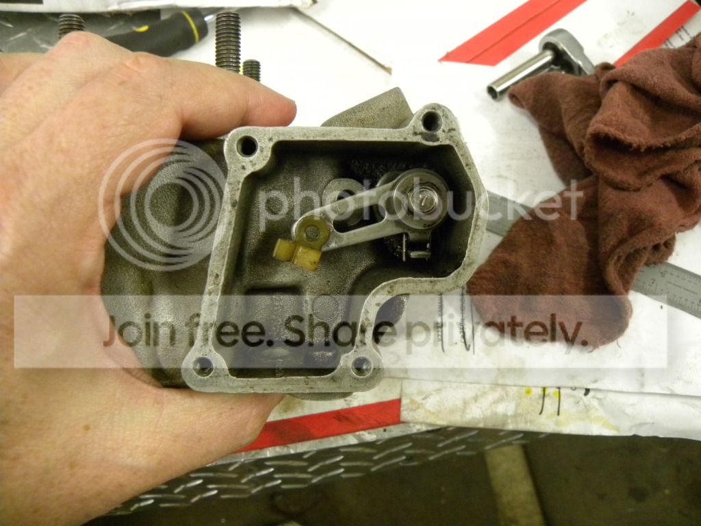

After removing your cylinder and head, this is what your valve set up looks like:
Here's some more pics with the valves push up:

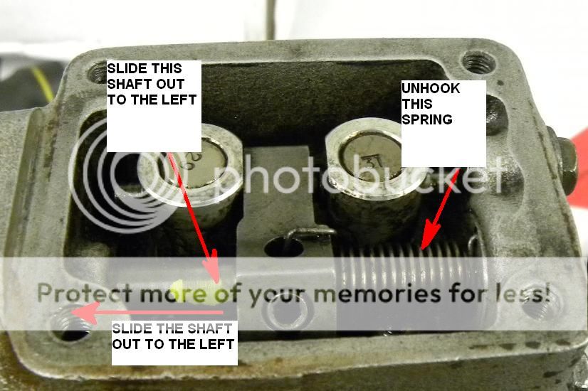

Now, unhook the spring first and then slide the shaft out to the left:

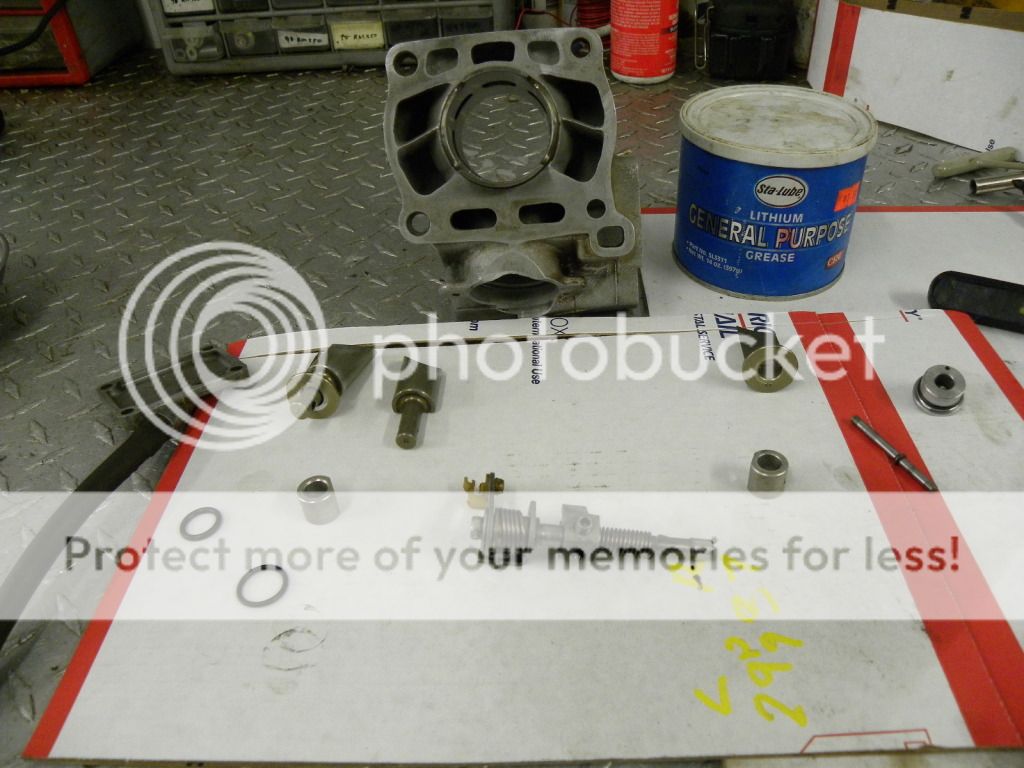

Here is a view of the shaft out of the cylinder and assembled as it sits in the cylinder:
