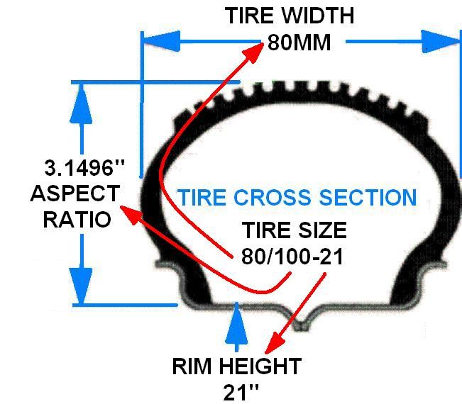

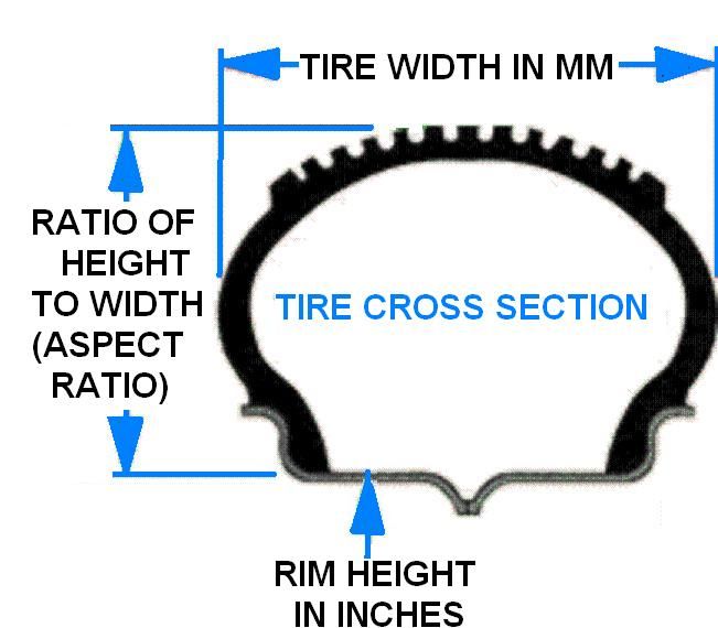

Below is a picture of the 3 things you will need to figure out how big your tire should be.
Tire width, Aspect Ratio, and rim diameter.
Keep in mind that tire manufactures can vary on sizes.
So far I have found some automobile manufactures off by as much as 1/2" in overall tire diameter.
However, most of the dirt bike tires I have checked are very close.
When you look at tire sizes you will see something that looks like this: 80/100-21.
What exactly do those numbers mean?
The first number 80 is the width of the tire in millimeters.
The second number is a ratio of the tire width called the Aspect Ratio.
In this example the second number is 100, so 100% of the tire width (80mm) is also the tire aspect ratio, 80mm.
The last number 21 is easy, the rim height is 21" in diameter.
To calculate the overall tire diameter you will need to convert mm in inches, or inches into mm depending on where you live :D
Since we are in the USA we will be using inches :o
Take the aspect ratio 80 and multiply by 0.03937 and you get 3.1496".
Take the aspect ratio 3.1496" and multiply by 2 and you get a combined aspect ratio of 6.2992".
Last, add the rim diameter of 21" to the combined aspect ratio of 6.2992" and you get a overall tire diameter of 27.2992".
Now, take a look at the picture below and see if this example makes sense:

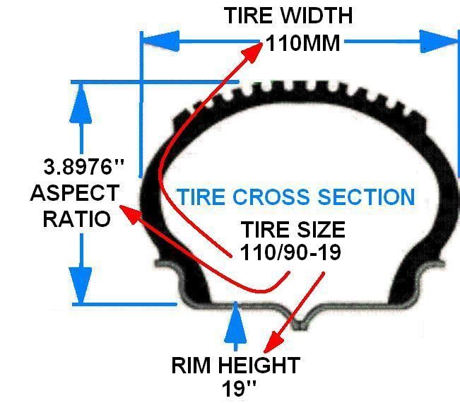

Now, how about a tire size of 110/90-19.
The first number 110 is the width of the tire in millimeters.
In this example the second number is 90, so 90% of the tire width 110mm is 99mm. (110mm x .9 = 99mm)
The last number 19 is easy, the rim height is 19" in diameter.
Once again since we are in the USA we will be using inches :o
Take the aspect ratio 99 and multiply by 0.03937 and you get 3.89763".
Take the aspect ratio 3.89763" and multiply by 2 and you get a combined aspect ratio of 7.79526".
Last, add the rim diameter of 19" to the combined aspect ratio of 7.79526" and you get a overall tire diameter of 26.7953".

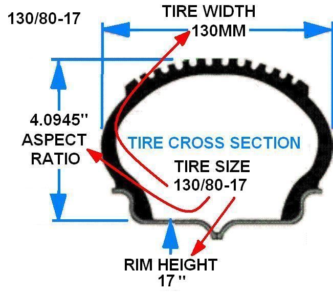

How about a 130/80-17.
The first number 130 is the width of the tire in millimeters.
In this example the second number is 80, so 80% of the tire width 130mm is 104mm. (130mm x .8 = 104mm)
The last number 17 is easy, the rim height is 17" in diameter.
Take the aspect ratio 104 and multiply by 0.03937 and you get 4.09448".
Take the aspect ratio 4.09448" and multiply by 2 and you get a combined aspect ratio of 8.1889".
Last, add the rim diameter of 17" to the combined aspect ratio of 8.1889" and you get a overall tire diameter of 25.1889".
