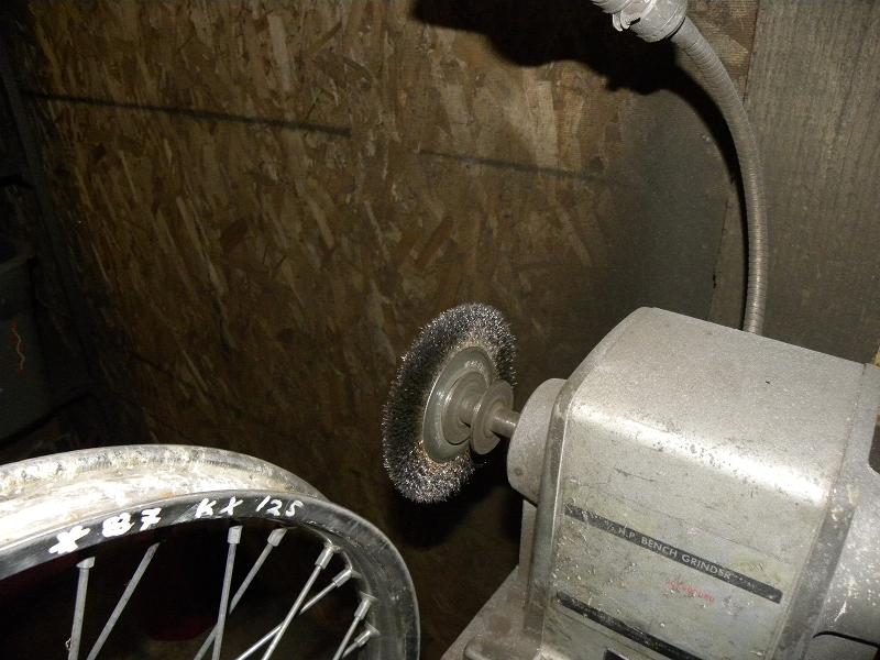

The first thing I do is clean it up on a wire wheel.
There are many different ways to do this but the wire wheel takes just a few minutes and removes the Oxide from the rim in a hurry.

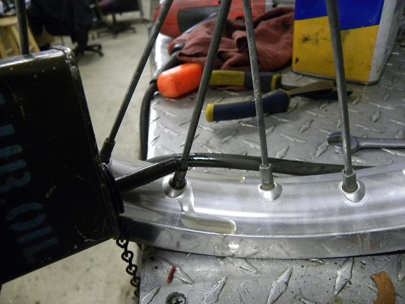

Once that is done I use a quality penetrating oil such as Kroil.
I put it in from with ends of the nipple.
Once the oil has set for a few hours I attach some Vice Grips at the hub end of the spoke using a rage doubled over a few times for protection.
Then I try to adjust it.

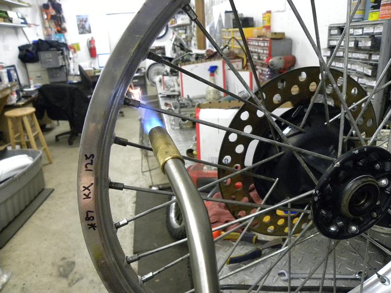

Still won't adjust?
Here is your best friend:
You need to be careful not to over heat.
If the nipple is made from aluminum this is especially true because it's easy to melt it right off the spoke..
Once you get it hot, put your spoke wrench on it and turn.

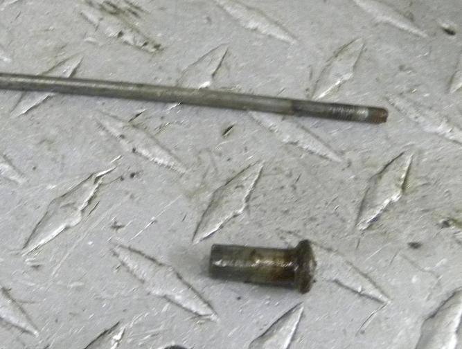

It should now come off like this one did:
I like to take the spoke back to the wire wheel and clean it up.
When you are done you can reinstall the spoke and tighten it up to the manufactures specs.
