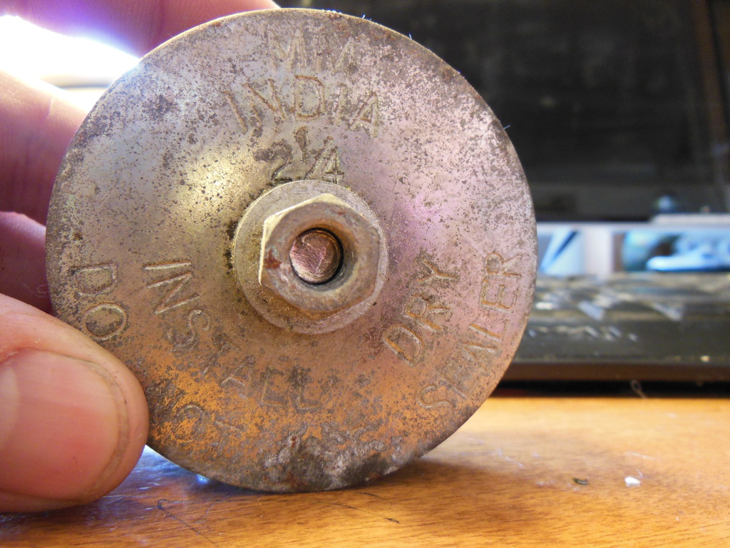

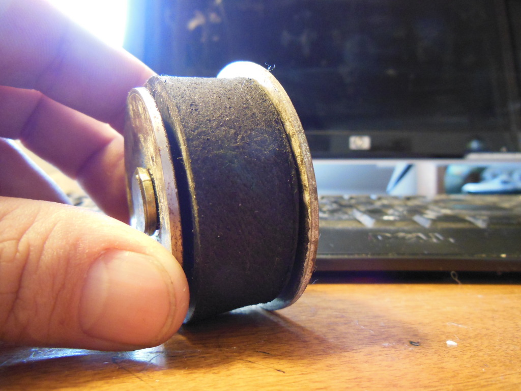

Items I use
1 3/4 plug
2 1/4 Plug (had to shave it down some in lathe... could do by hand with a grinder too I guess)..

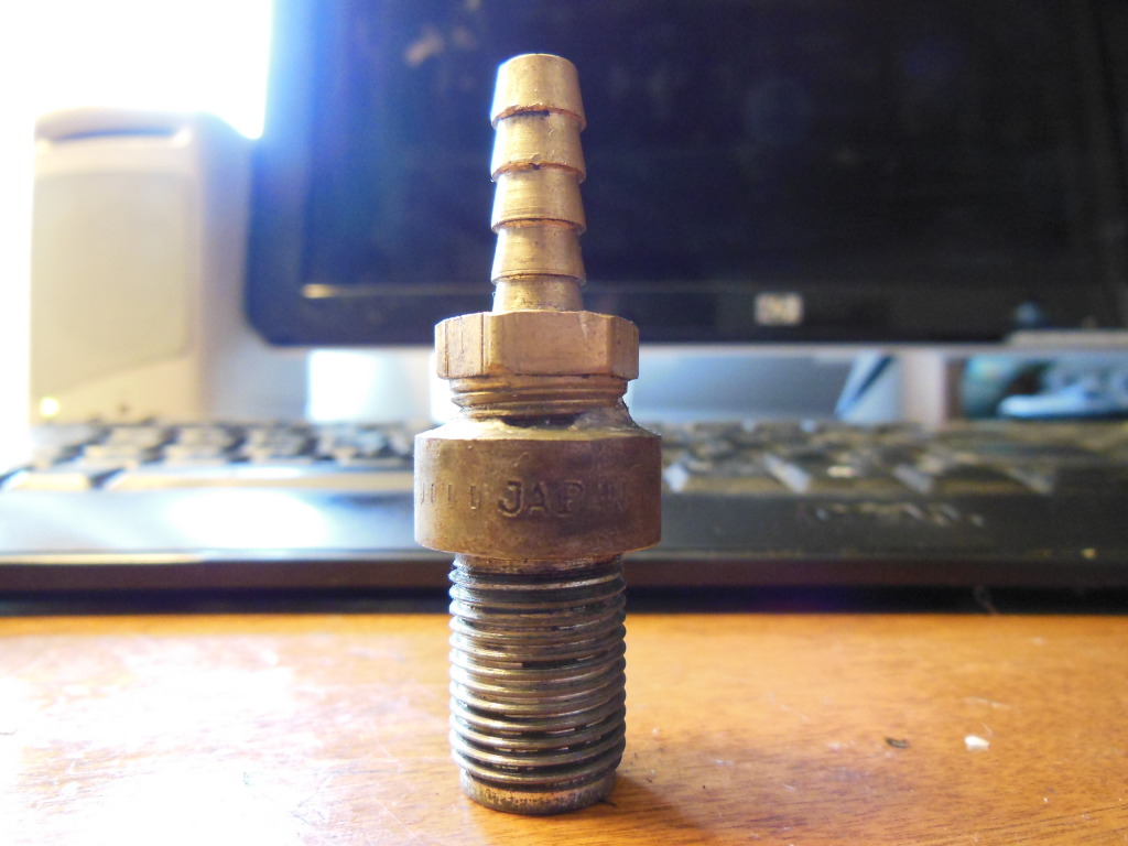

Old spark plug with innards busted out. and a .25 barb. soldered together.
the reason I used that barb.... is I have a VERY accurate Bicycle pump. (wife races) that reads low pressure well, so the shrader end will seal against it. as also my hand vacuum pump hose goes right on it.. so I can swap between pressure and vacuum easy.

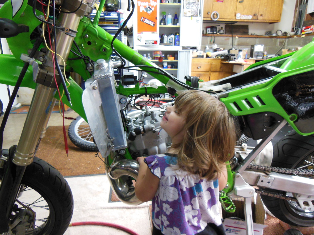

So easy a kid could do it 8-)
