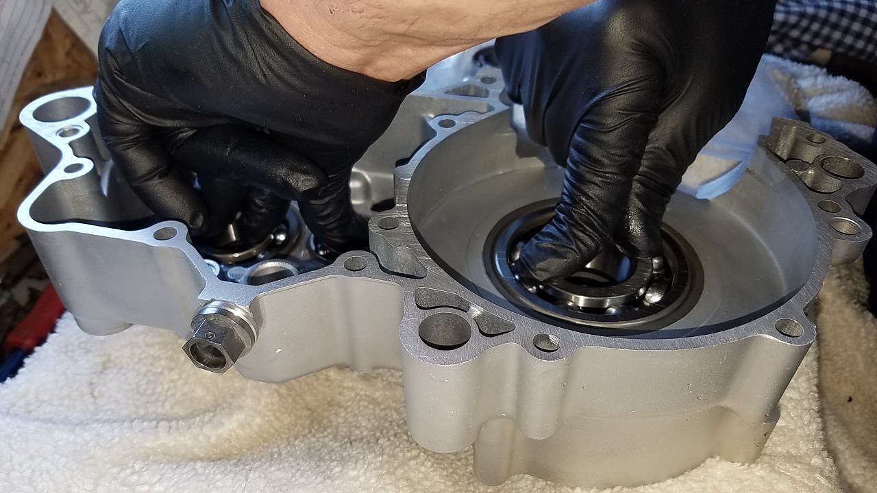

At 275f the bearings will drop right in.
Just don't burn yourself...
