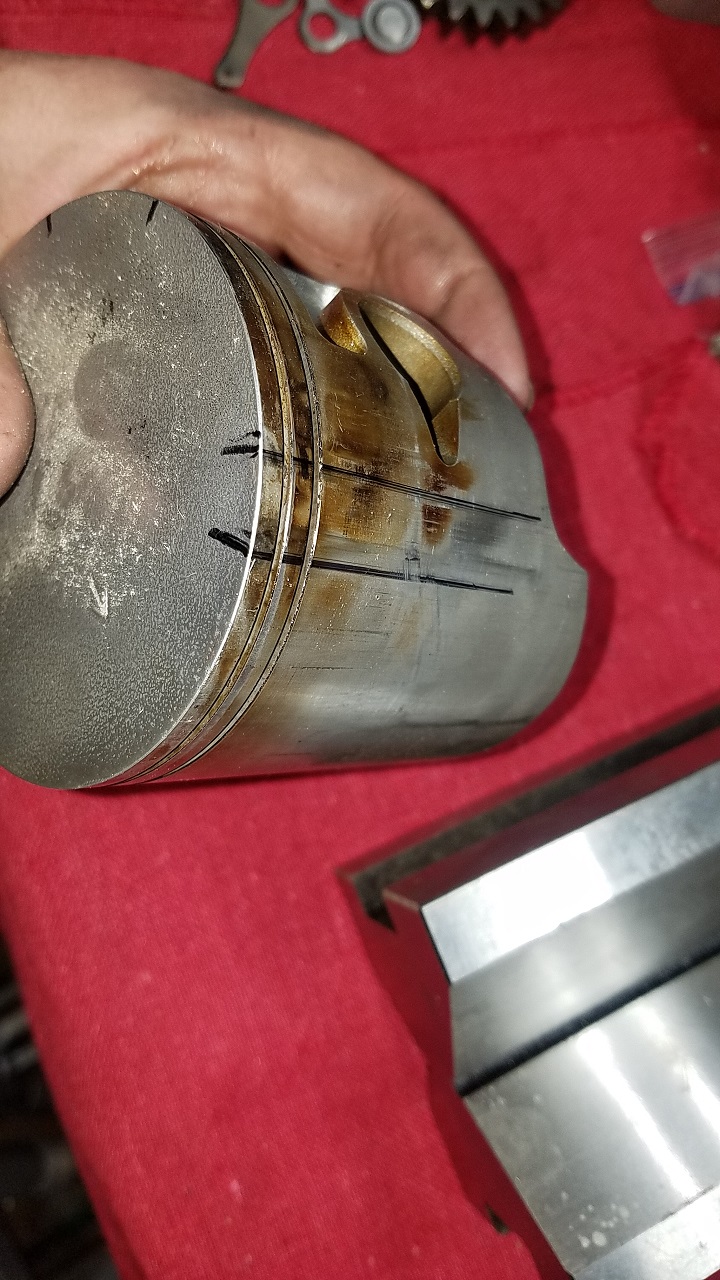

One of the things that you start to notice when building KX500's or any other 2t engine is that there are some area's you would like to see a bit more oiling.
Here is a well worn KX500 piston..
Notice the vertical lines in it...
Those are all places I would like to see some more oil..

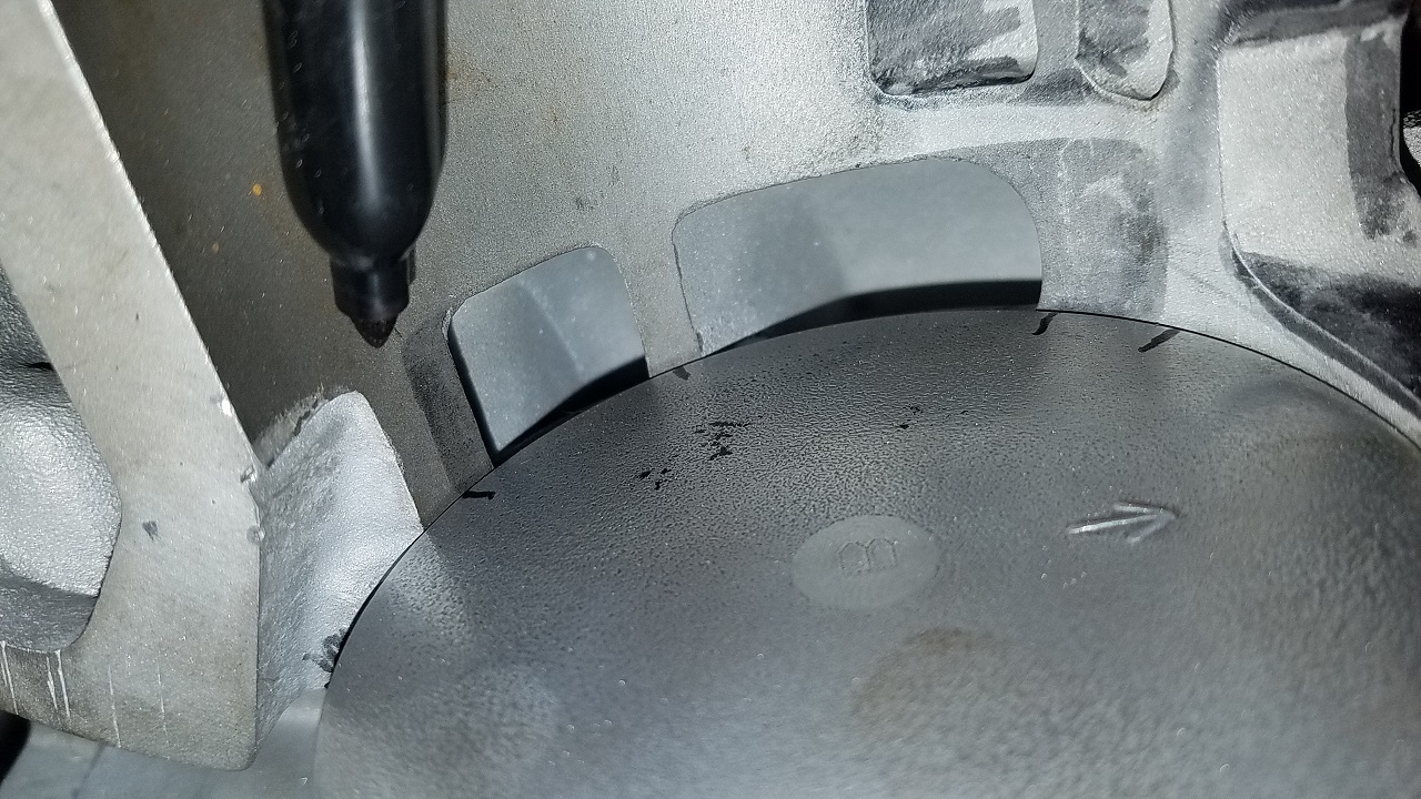

First things first, you need to mark to top of the piston with the location points you want to run vertical down your piston.
KX GURU RACING HOW TO ACCURATELY MARK YOUR PISTON OILING HOLE LOCATIONS 104.jpg
KX GURU RACING HOW TO ACCURATELY MARK YOUR PISTON OILING HOLE LOCATIONS 104.jpg (399.51 KiB) Viewed 7955 times

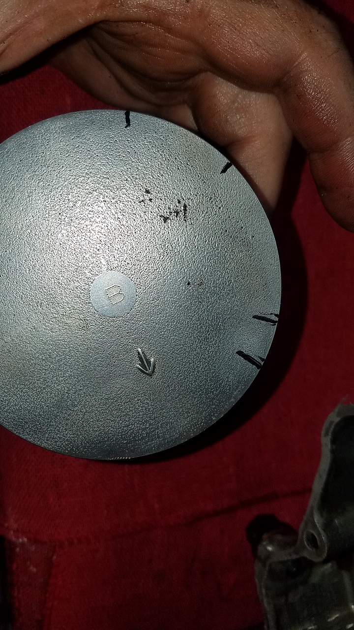

Next, pull the piston out of the cylinder and take a look.
KX GURU RACING HOW TO ACCURATELY MARK YOUR PISTON OILING HOLE LOCATIONS 105.jpg
KX GURU RACING HOW TO ACCURATELY MARK YOUR PISTON OILING HOLE LOCATIONS 105.jpg (422.26 KiB) Viewed 7954 times
KX GURU RACING HOW TO ACCURATELY MARK YOUR PISTON OILING HOLE LOCATIONS 106.jpg
KX GURU RACING HOW TO ACCURATELY MARK YOUR PISTON OILING HOLE LOCATIONS 106.jpg (367.87 KiB) Viewed 7954 times
Now for the hard part... Transferring the lines from the top of the piston to the sides...
You will need a "V" Block like this.

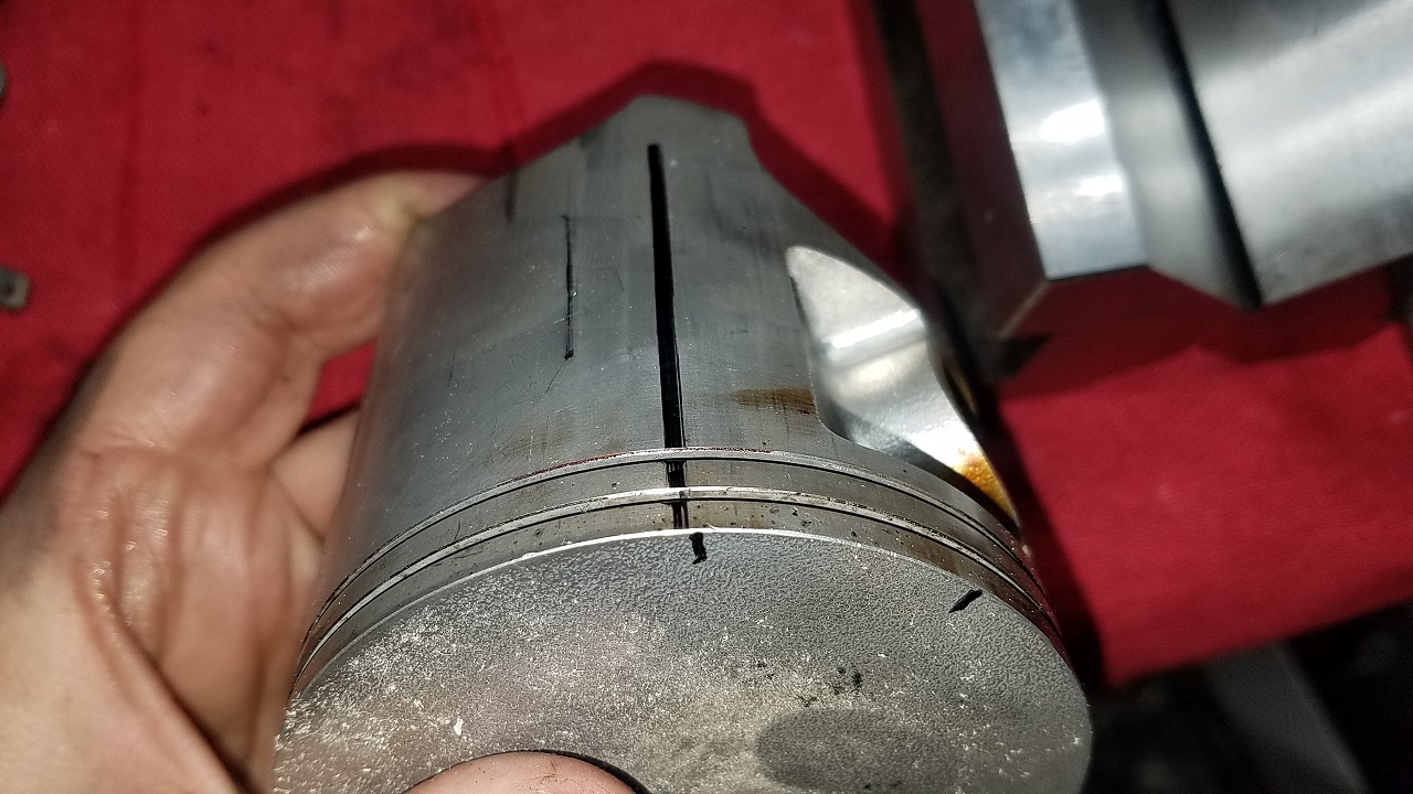

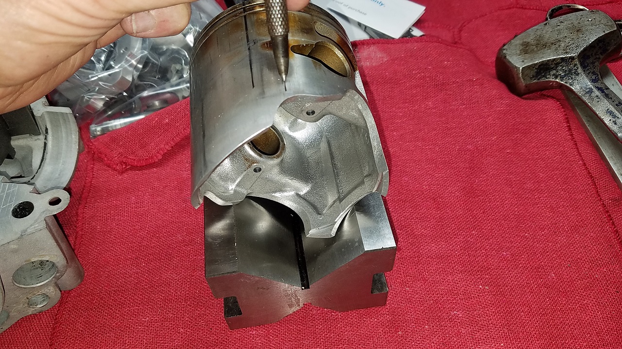

Put the piston into the "V" block and rotate the piston so that the mark on the top of the piston aligns with the edge of the block.
Once you have it aligned you can run a sharpie down it like so... Except.... IT won't work like this... :roll:

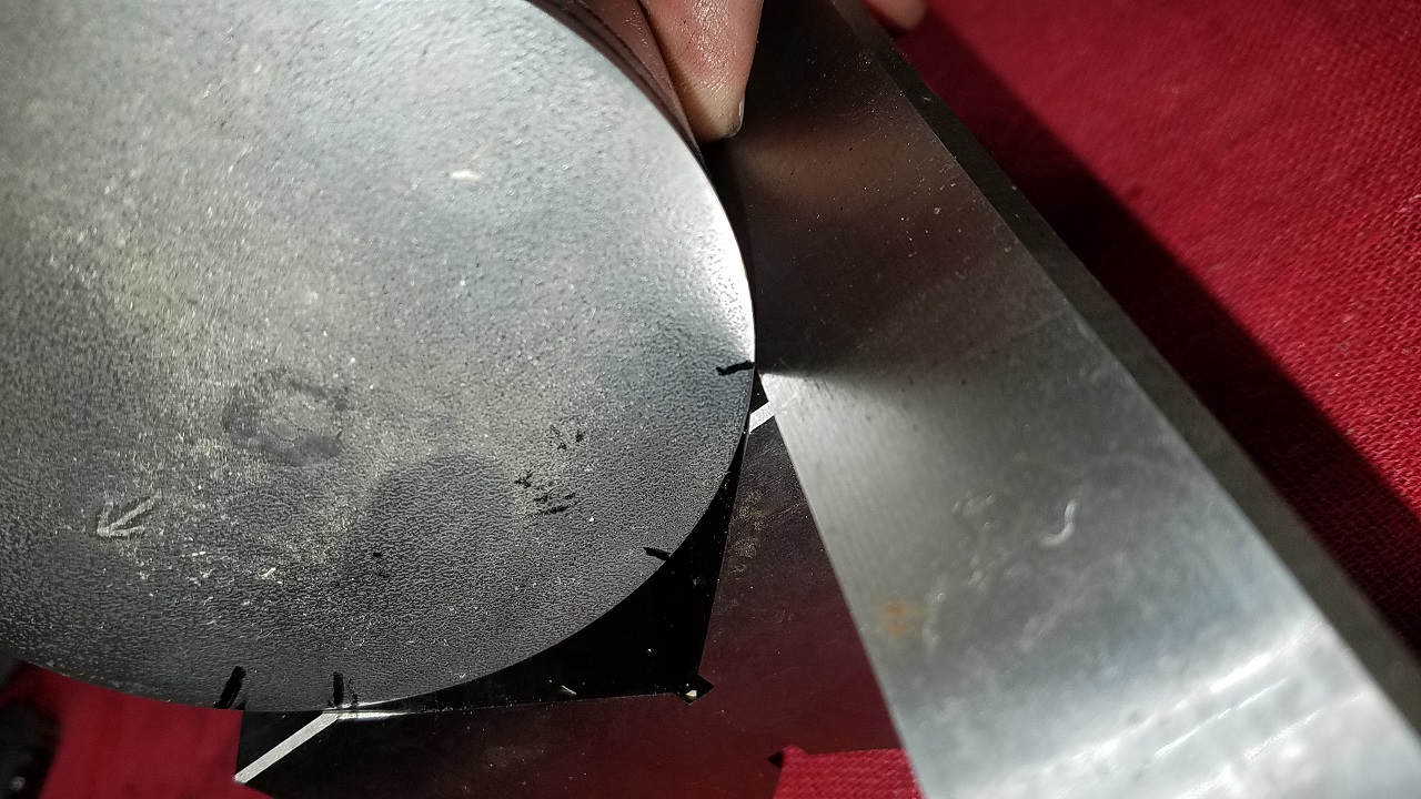

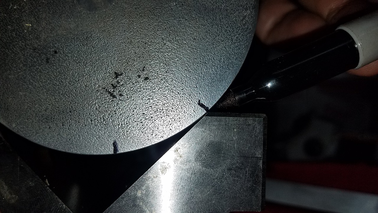

Easy... Get a piece of material such as this piece of aluminum and raise the marker up a bit...
KX GURU RACING HOW TO ACCURATELY MARK YOUR PISTON OILING HOLE LOCATIONS 109.jpg
KX GURU RACING HOW TO ACCURATELY MARK YOUR PISTON OILING HOLE LOCATIONS 109.jpg (373.04 KiB) Viewed 7951 times
Now, run that marker down the edge and PRESTO!.... Oops...
KX GURU RACING HOW TO ACCURATELY MARK YOUR PISTON OILING HOLE LOCATIONS 110.jpg
KX GURU RACING HOW TO ACCURATELY MARK YOUR PISTON OILING HOLE LOCATIONS 110.jpg (317.79 KiB) Viewed 7951 times
Don't get in a hurry... If you mess up wipe the mark off and start over...

At this point you can mark your hole positions..
When you use the punch you don't need to wack it... Just a little tap will do ya..
KX GURU RACING HOW TO ACCURATELY MARK YOUR PISTON OILING HOLE LOCATIONS 115.jpg
KX GURU RACING HOW TO ACCURATELY MARK YOUR PISTON OILING HOLE LOCATIONS 115.jpg (502.04 KiB) Viewed 7949 times
I like leaving the piston in the "V" block because it holds the piston so nice.
Just be sure to air hose or wipe the piston and "V" block in between holes so you don't scratch up your nice new piston.. :oops:

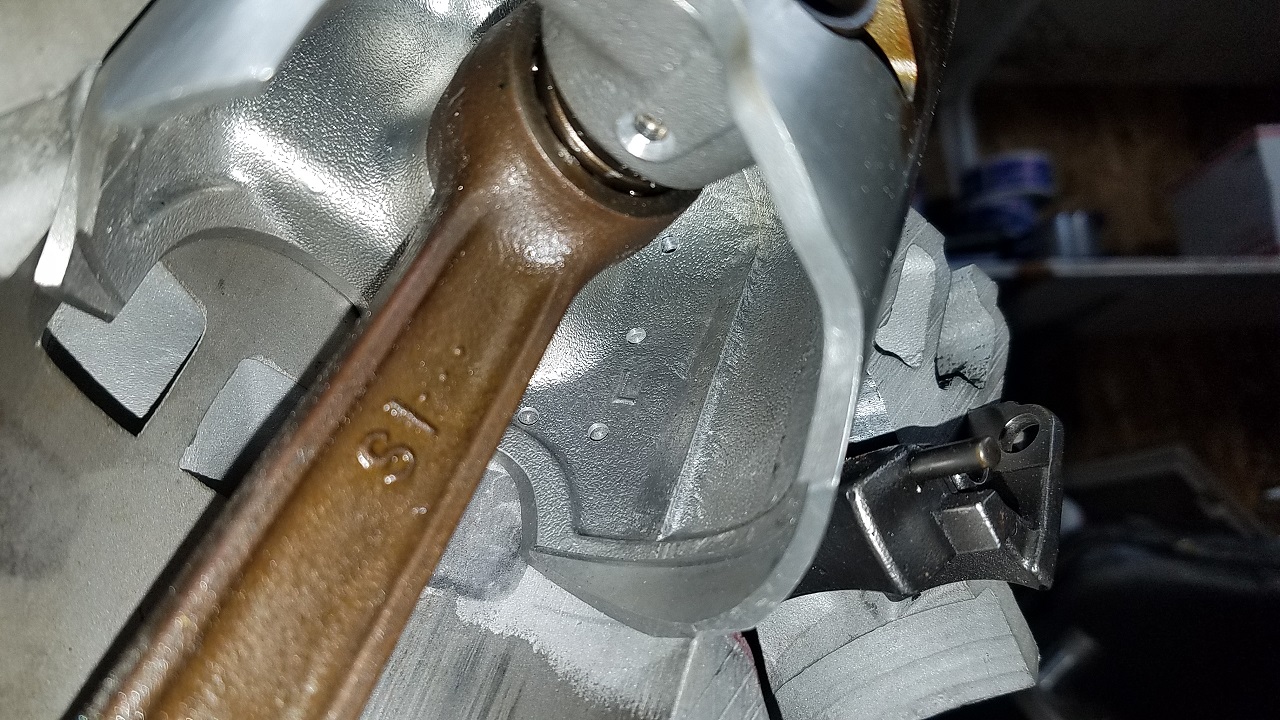

I intentionally used a much larger drill bit then I needed because I wanted to accentuate any errors I might have made.
Once done I put the piston back into the cylinder and ran the piston up and down to see if I exposed any of the ports..
KX GURU RACING HOW TO ACCURATELY MARK YOUR PISTON OILING HOLE LOCATIONS 118.jpg
KX GURU RACING HOW TO ACCURATELY MARK YOUR PISTON OILING HOLE LOCATIONS 118.jpg (394.53 KiB) Viewed 7948 times
KX GURU RACING HOW TO ACCURATELY MARK YOUR PISTON OILING HOLE LOCATIONS 119.jpg
KX GURU RACING HOW TO ACCURATELY MARK YOUR PISTON OILING HOLE LOCATIONS 119.jpg (416.53 KiB) Viewed 7948 times
KX GURU RACING HOW TO ACCURATELY MARK YOUR PISTON OILING HOLE LOCATIONS 120.jpg
KX GURU RACING HOW TO ACCURATELY MARK YOUR PISTON OILING HOLE LOCATIONS 120.jpg (396.88 KiB) Viewed 7948 times
As you can see this was a perfect job.
