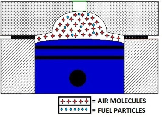

What happens when you heat the air up?
The molecules move faster and further apart.

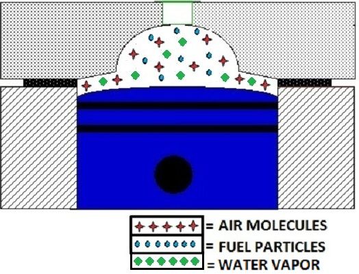

See the chart below.
Note how few Air molecules there are.
Because they are hotter, they vibrate faster and push the surrounding air molecules farther away giving you less air in the combustion chamber:

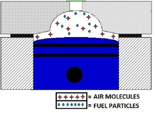

What happens when you cool the air down?
The molecules move slower and move closer together.
They do this because they are colder, they vibrate slower and can't push the surrounding air molecules farther away:
Note that on both charts there is the same amount of fuel entering the combustion chamber regardless of air temperature.
So it's winter out and it's 10 degrees, the air is going to be extremely dense (Molecules are closer together).
This means that your engine will be allowing more air molecules into the combustion chamber, thus requiring more fuel.
Let's say that it's in the middle of the summer, your in the desert, and it's 110 degrees.
The air will be a lot less dense (Molecules are further apart).
That means that you will be letting in a lot less air into the combustion chamber requiring a lot less less fuel.

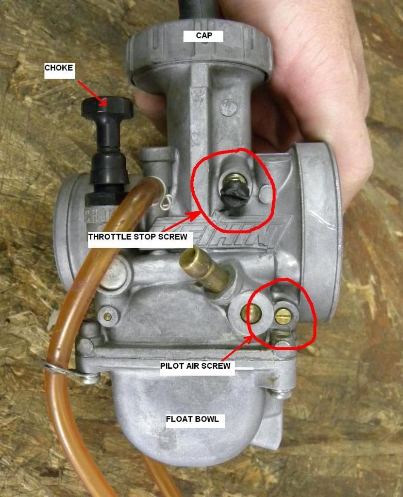

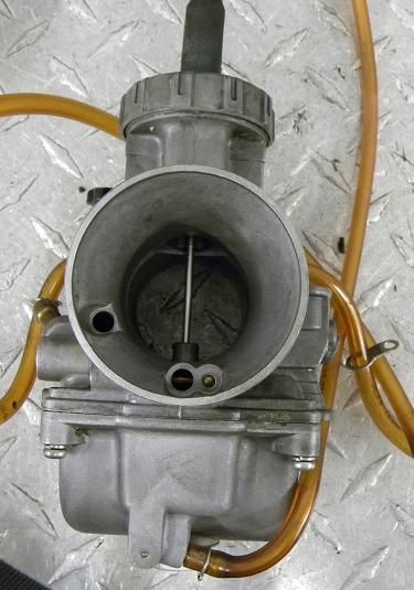

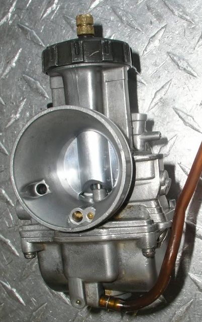

Here is a pic of the carb with labels for ID's.
Note: the air screw is usually located toward the air box side of the carb (Big end).

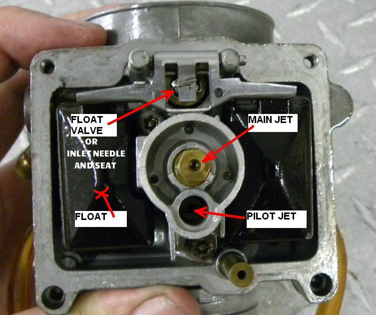

Here is a pic of the carburetor opened up:
The pilot jet is down deep in that hole and requires a flat blade screw driver to remove it.

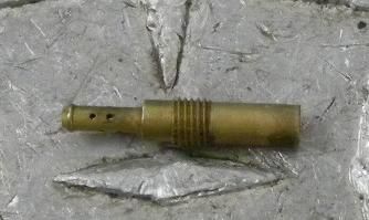

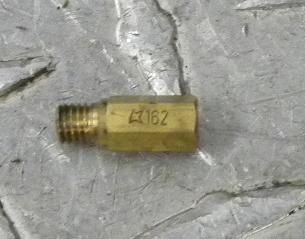

Here is a pic of the pilot jet removed from the carburetor:
See those little holes in the pilot jet?
Those are called Emulsion holes.
The Emulsion holes must be clean and free of debris.
You should also be able to look down the center of the jet and see daylight through it with no obstructions.

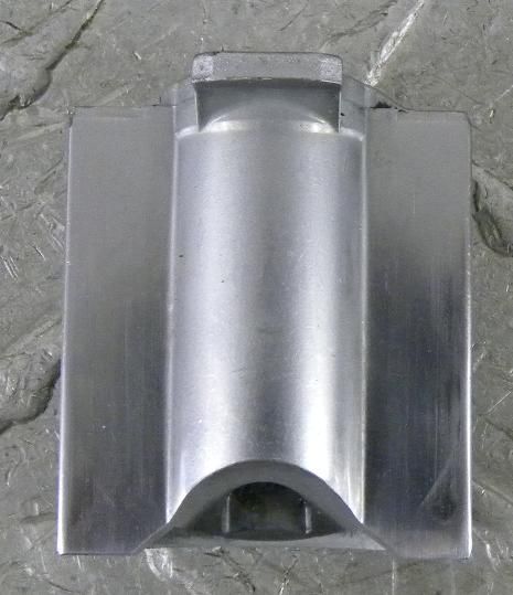

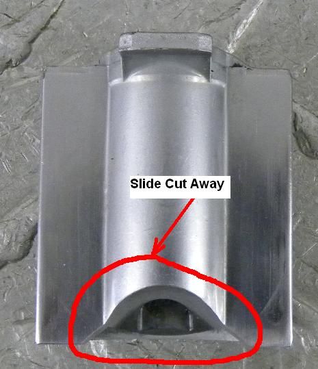

Slide, What is it and what does it do?
In most cases you will not have to change your slide unless it is just worn out.
The main job of the slide is to meter how much air flows into the engine.
When at idle, the slide is in the down position.
This blocks off most of the air into the engine but not all.
When you twist the throttle to the wide open position the slide moves up to it's top position.
While the slides main job is to control the air flow into the engine it also meters air at low RPM's by means of angles cut in the bottom of the slide.
This area is called the Slide Cut Away.

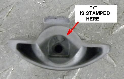

Stamped into the slide is a set of numbers.
The lower the number the richer you will be at low RPM's.
The higher the number the leaner you will be at low RPM's.
Most of the time it will be unnecessary to change the slide unless you are making radical engine modifications or if the manufacture just flat out blew it in their slide selection :-)

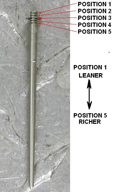

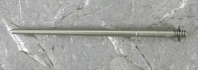

Needle, What is it and what does it do?
There are three parts to most needles.
You have the Length which effects the largest part of your midrange but also has a tendency to effect a little upper and lower throttle positions as well.
There is the taper which typically effects 3/4 throttle to full throttle but is the least sensitive part of the needle.
And last there is the needle diameter which controls mainly the 1/4 throttle range or just off the pilot jet.
Needle Length
As you can see from the picture below the needle has several positions for the clip.
Starting with position 1, if the clip is in this first position this will allow the least amount of fuel through thereby giving you the leanest condition.
So the further down the needle you move the clip the richer your mixture will be.
If your needle length is too lean you will loose a lot of your midrange power.
In fact it may feel like riding a small bore two stroke, simply no power down low, then as it finally revs up, whoah baby!
The biggest problem with running the needle length too lean is welding your piston to your cylinder or, burning a hole in your piston.
Running the needle length to rich will make it run weak and blubber in the midrange.
So, what is the safest way to figure out your needle length?
Put the clip in the 1st or 2nd position and run the bike.
Then move the clip one position richer and run the bike.
Keep doing this same procedure until the bike starts to run weak and blubbery, then back the clip one position.
It's important that you not run the bike too lean in the midrange as typically most riders spend the majority of their time in the midrange.
Needle Taper
If you look at the picture of the needle you will see that the lower half is tapered.
The taper has the least effect on your jetting.
The taper effects the areas from 1/2 to full throttle but primarily around the 3/4 throttle range.
Something else to consider, if you run a leaner taper you will need a richer main jet, and if you run a richer taper then you will need a leaner main jet.
My feelings are to leave the taper alone unless you are making critical engine mods, the engine designer blew it, or your running in extremely cold conditions.
Needle Diameter
Most of the time the needle diameter effects the 1/4 throttle position or just as you start to feel the engine pulling.
It can however effect a little on either side of 1/4 throttle.
IF the needle is set to lean you will loose bottom end power and once again you will most likely shorten the life of your engine and in some cases dramatically.
If the needle is set to rich your engine will bog out and in more extreme cases you will fowl your spark plug.
On a few bikes there are good reasons to change the needle but for most, unless you have a real good reason for changing the needle, I say to leave it alone.
