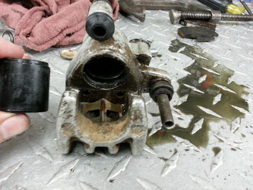

Typically they will shoot out with a noticeable pop..
If you don't use a rag to keep the piston from shooting out, be sure to aim it in a safe direction because the piston will easily shoot out 12 or more feet even under fairly low air pressure.
This one oozed out because the piston and seals were completely gummed up.
OEM-CYCLE.COM BRAKES 109.JPG (99.39 KiB) Viewed 18397 times

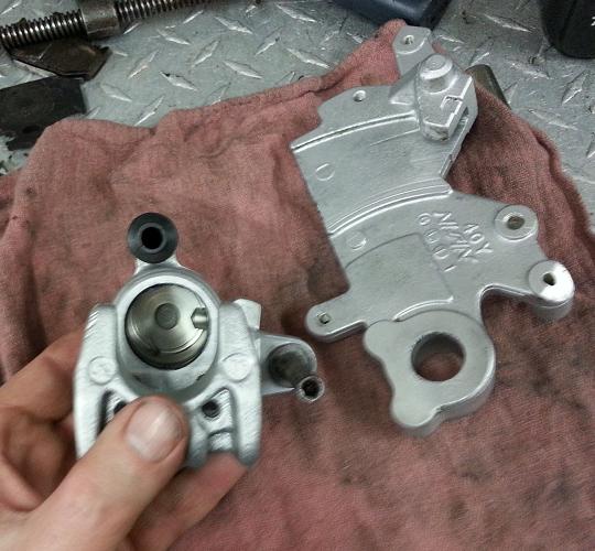

Assembled.
OEM-CYCLE.COM BRAKES 118.JPG (34.26 KiB) Viewed 18397 times
Because the pads are wide open I give the caliper a quick shot of air down the hose hole and they snap shut.
If yours is slow to close, better give it a complete rebuild...
OEM-CYCLE.COM BRAKES 119.JPG (33.56 KiB) Viewed 18397 times
Half done...
