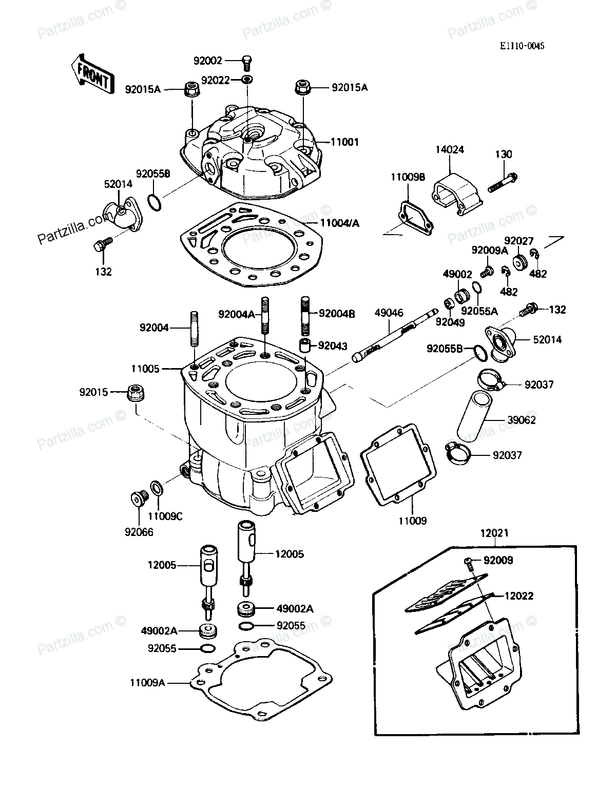

First, look at the diagram..
1988 kx500 cylinder.png (104.72 KiB) Viewed 14145 times
If you haven't already, remove the right governor cover 14024-1611
Then remove CIRCLIP-TYPE-E,4MM 482J4000
Next remove COLLAR,GOVERNOR ROD 92027-1834
Then remove the other CIRCLIP-TYPE-E,4MM 482J4000.

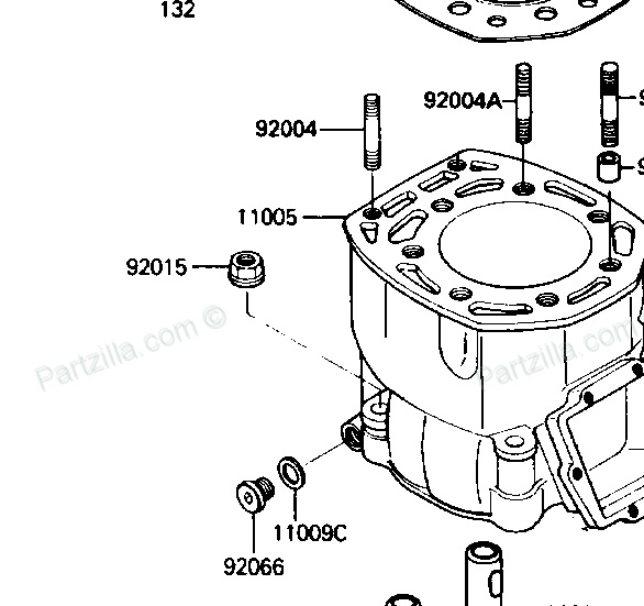

Now remove PLUG,12X10 92066-1222
Then remove GASKET,12.5X18X1,DRAIN PLUG 92065-073 or 11009C
The ROD-GOVERNOR 49046-1057 will not come out yet because it is still meshing with the exhaust valves 12005-1080.
Re: How to remove your exhaust valves from your 88 KX500
Move the ROD-GOVERNOR 49046-1057 so that is is roughly centered.

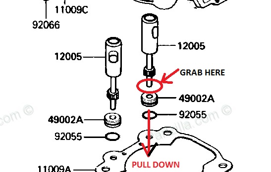

1988 kx500 cylinder 3.jpg (47.54 KiB) Viewed 14143 times
Grab on to the bottom of the exhaust valve and pull the valves down about 1/4"
If you have aluminum valves BE CAREFUL AS THEY WILL BREAK EASILY

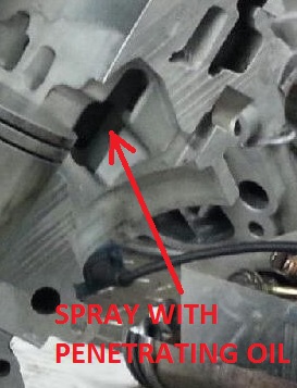

If they don't pull down easy, STOP, squirt the valve heavily with a good penetrating oil.
Be sure to squirt both valves not from the bottom but into the exhaust port as shown below

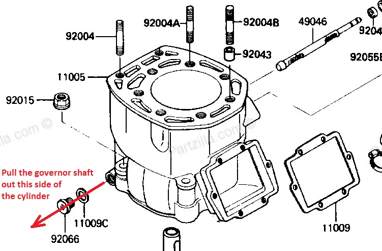

Once you have both valves moved 1/4" down, pull the governor rod out in this direction
