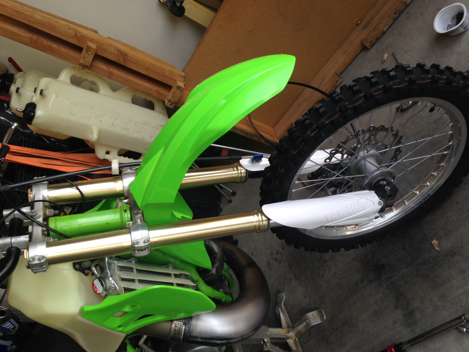

The fork spacing of the KX clamps is slightly narrower than the YZ clamps, so I'll have to fiddle with the wheel spacers a bit. Otherwise it should be a clean set up. More pics when I get it assembled. :D

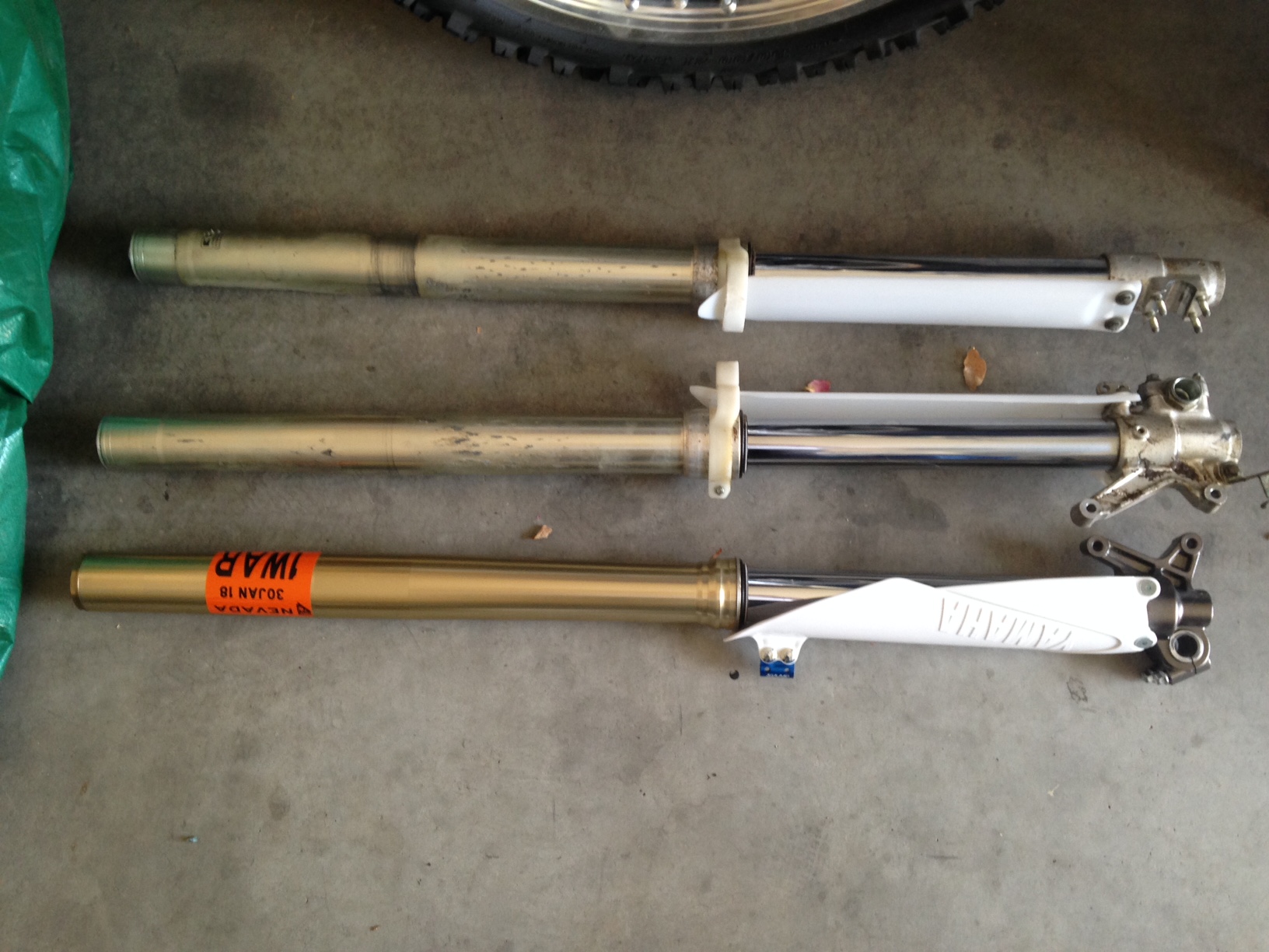

Here are a few pics of my fork swap. I picked up a 2000 KX500 about a month ago. I own a 2016 YZ450FX, so did some measuring and research before I even bought a 500 and learned that the Yamaha stuff is real close. I used a caliper to measure the diameter of both sets of forks, but since it is just a cheap Harbor Freight caliper, I doubt it is exact, but I figure the difference in measurements between the two forks should be pretty close. The top clamping area was on a difference of 0.01 mm, while the lower was 0.3 mm difference. Just used the stock KX triple clamps, and the YZ stuff slid right in, also used the front wheel and brake from the YZ. Haven't been able to take the KX out to the desert yet (need to rebuild the rear shock before I actually ride it) but the forks were pretty nice on the YZ, so hoping they will be just as nice on the KX.
