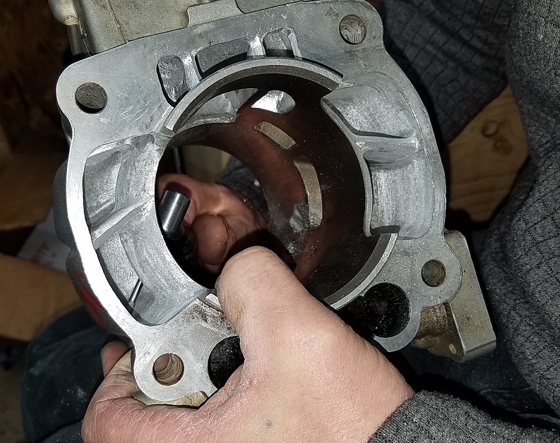

Jason is hard at it...
It's amazing how many hours it takes to do a nice porting job...
JT ENGINE WORKS KX GURU RACING ENGINE BUILD FOR JEFFS 93 112.jpg (181.41 KiB) Viewed 9441 times
JT ENGINE WORKS KX GURU RACING ENGINE BUILD FOR JEFFS 93 111.jpg (257.21 KiB) Viewed 9441 times
JT ENGINE WORKS KX GURU RACING ENGINE BUILD FOR JEFFS 93 110.jpg (123.62 KiB) Viewed 9441 times
Re: 1993 KX500 Engien build for Jeff Y
Still hard at it... Same cylinder, different day...
After doing the base porting, Jason is Vapor Blasting the cylinder to clean it up.
Once it is done it will get all final port work then it will go off to plating.
Once it comes back, it will get the final Vapor Blasting and then polishing, clean up, then assembly..
Still a lot of work to do..
JT ENGINE WORKS KX GURU RACING ENGINE BUILD FOR JEFFS 93 115.jpg (368.21 KiB) Viewed 9387 times
I don't think most people fully grasp how much work Jason's level of porting takes.
Here is a bit of a secret.
In the first hour to hour and a half you can get 80-85% of the basic port work done, or something comparable to E. Gore, or some of the other big name shops. To get that last 15-20% takes more and more time.... But if your looking for a quality port job you won't see much if any better then Jason's work any where...
