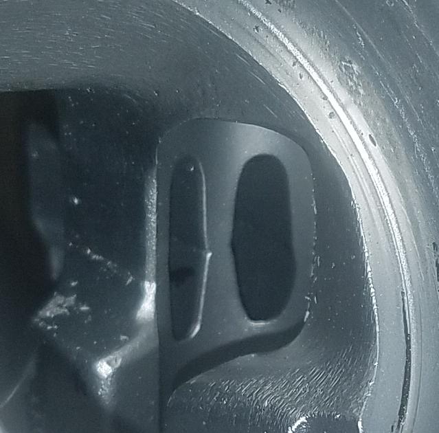

Here is a view from the exhaust port... Before..
And after the rough cutting is done..
Now I need to finish the other side to match.
Then, I need to install the exhaust valves and mark them so that I can get the ports to match the open and shut position of the valves for maximum flow.. Breathe baby breathe!

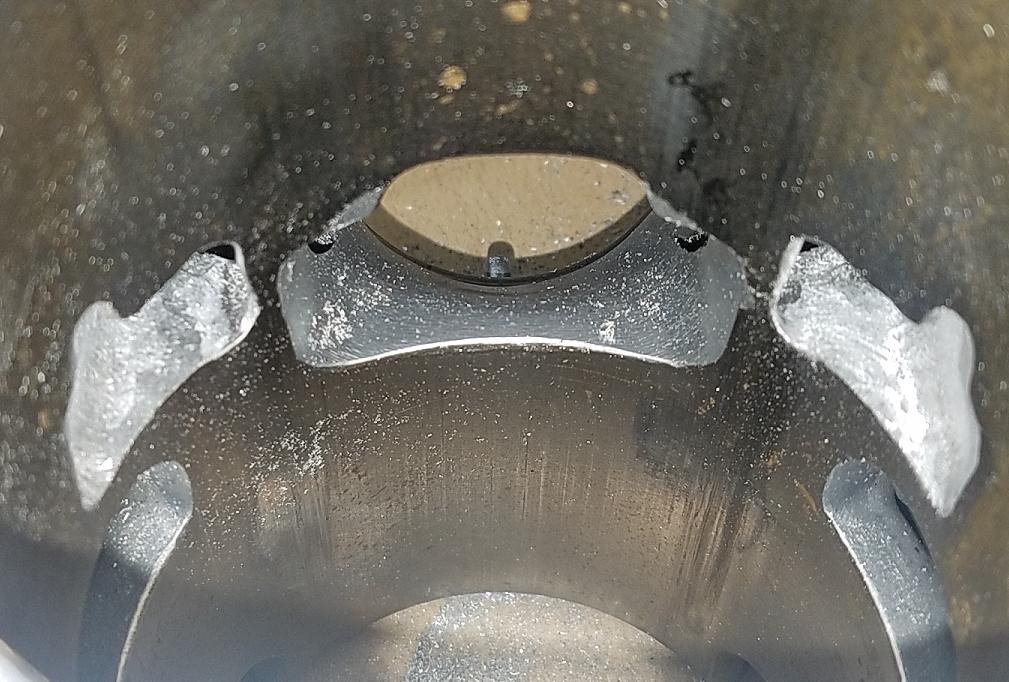

Ok... I have both sub ports roughed in.
The cool thing about this porting is that if Brent decides at some point that he needs more power, we don't need to do a lot of work to boost it.
Add a base gasket spacer and take a bit off the deck and your going again..

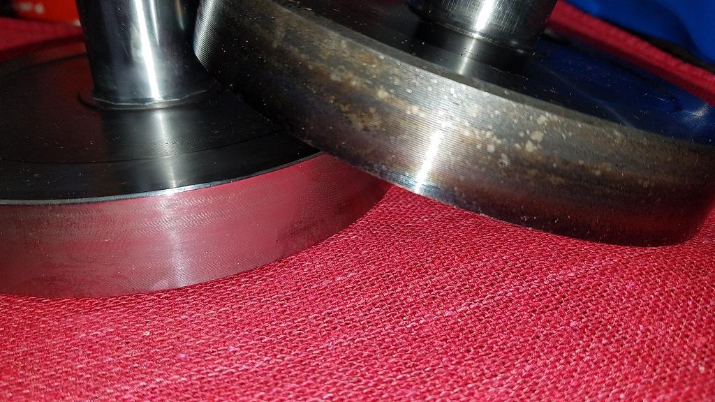

Last week before I sent the crank out I took some pics and forgot to post them.
A lot of guys don't know that when you send a crank off to have it rebuilt, the company that rebuilds them does not clean them unless they come packed in mud or something... Even then they will probably knock just enough of the mud off so they can press it together
I have had cranks rebuilt by many different companies so it's a common practice.
So, some time ago, Jason and I decided that we would clean them up before sending them out and the results were immediately noticeable.
Here is a comparison of a crank half that we cleaned up, vs one that is not cleaned up.
I did not polish the whole crank, but I did the OD as well as where the rod bushings go.
Making sure that you get all the foreign material off isn't exactly easy but the results are worth it.
One other point... Remember how bad the bearing journal looked on the left crank half?
Well, it was undersized by a couple of thousands.
Some guys will still use them by applying some loctite on the journal.
But this does not address the issue that cause the problem in the first place.
Sure, it will work for a while but that is not the kind of engine we want to build.
I took the crank half to a company that does industrial hard plating.
They grind the bad journal undersize just enough to get it to clean up.
Then, they plate it just slightly oversize, and finally they grind it to the correct tolerance.
It isn't cheap to get done but it is a lot less expensive then buying a new crankshaft.
