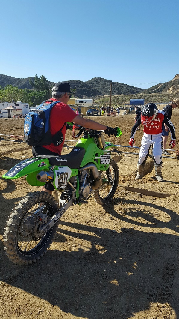

At the track this morning..
KX GURU RACING SEAN COLLIER KX500 308.JPG (369.18 KiB) Viewed 16892 times

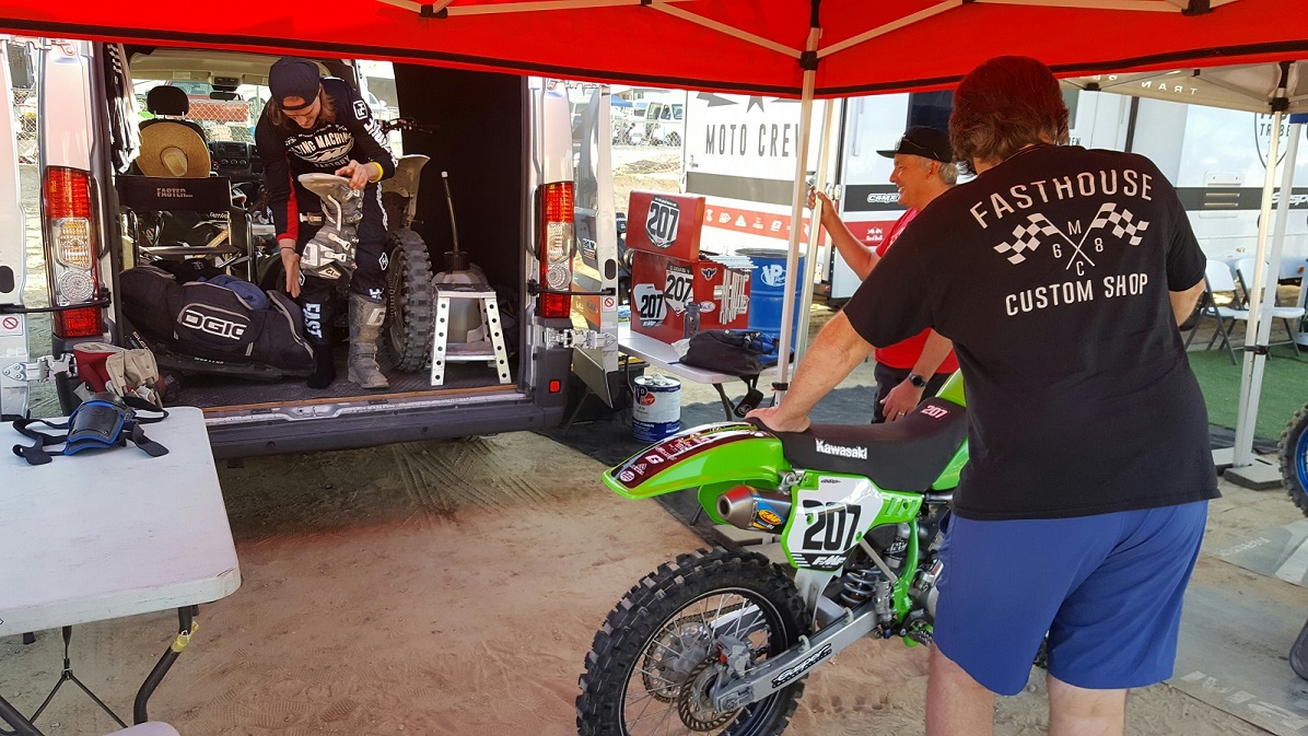

Getting the launch pad ready to go..
KX GURU RACING SEAN COLLIER KX500 309.JPG (332.73 KiB) Viewed 16889 times
