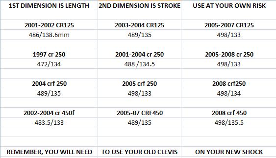

This information is not verified as of yet.
I received it from a guy wanting to use a newer shock on his older CR250.
Use it at your own risk...
And remember, you will need to use your older clevis on the newer shock...
First measurements is the length, the second is the stroke
If you have other info which conflicts with this info please let me know.
Honda CR shock info
