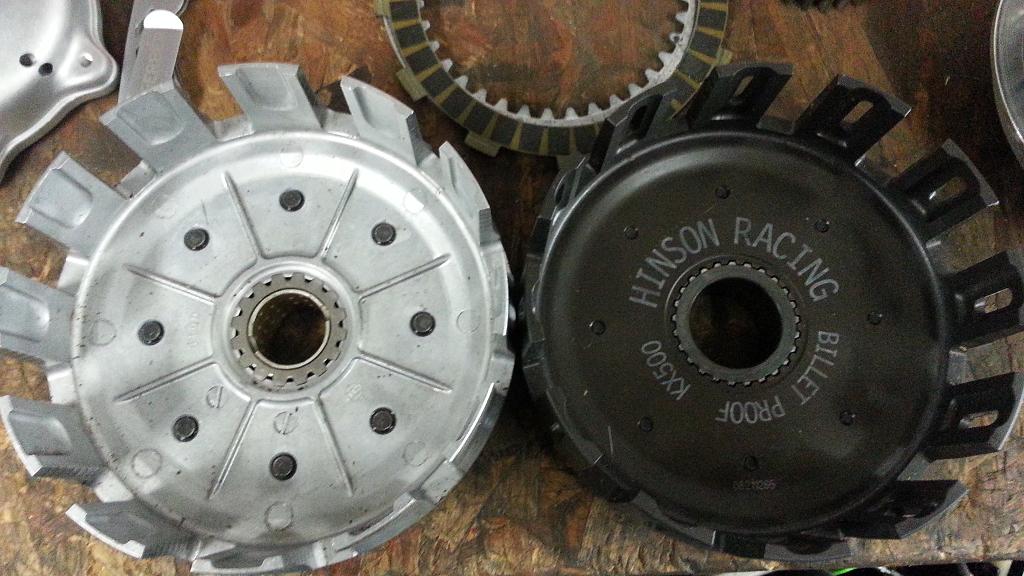

Wouldn't it be nice to be able to get a brand new KX450F Hinson clutch basket and drop it into your 89-04 KX500?
I would sure like it...
So, what would prevent you from doing it?
Let's see..

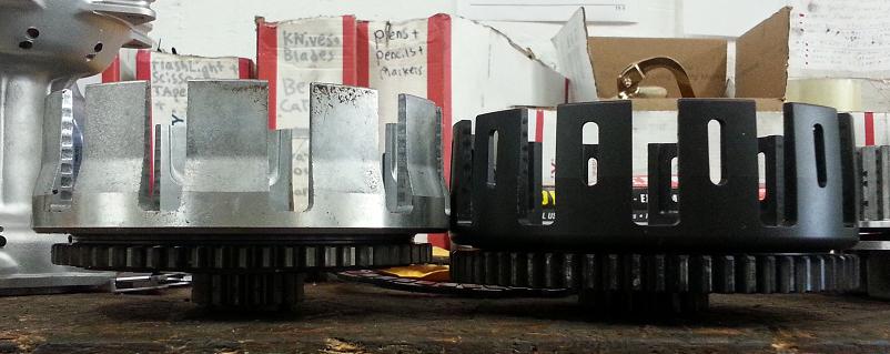

Here is a pic of both baskets side by side.
KX500 VS KX450F CLUTCH BASKET 101.JPG (129.28 KiB) Viewed 21564 times
KX500 VS KX450F CLUTCH BASKET 102.JPG (45.52 KiB) Viewed 21564 times
Re: KX450F VS KX500 CLUTCH BASKET COMPARISON
Right off the bat, the KX450F basket which is on the left has a much smaller bearing hole then the KX500 Hinson basket on the right.
However, when you drop the bearing and the collar into the center bearing hole of the KX500 basket, the KX500 Basket has a smaller hole size.

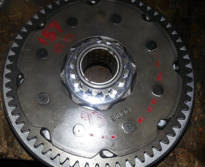

The KX450F ID measures 25mm

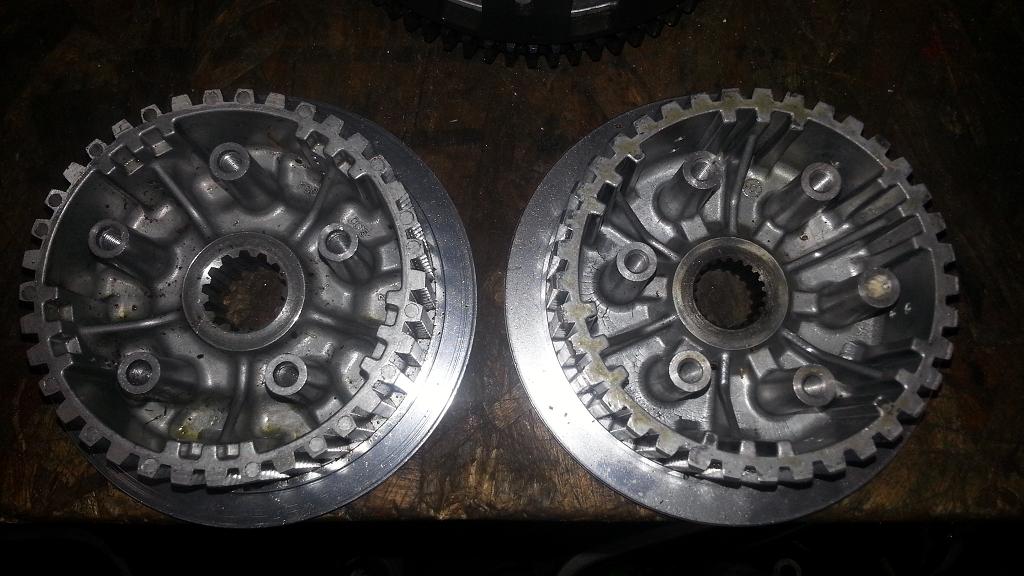

The KX500 ID measures 22MM

So the ID of the bearing holes are different and the gear's are clearly different.
What about removing the basket off the KX450F and mating it to the KX500 gears?
Let's see...
Here is a pic of the KX450F basket.
The mounting bolt hole circle is 8 bolts on a 93MM bolt circle.
Also, the basket diameter is 157mm.

The KX500 mounting bolt hole circle is 8 bolts on a 96MM bolt circle.
Also, the basket diameter is 153mm.

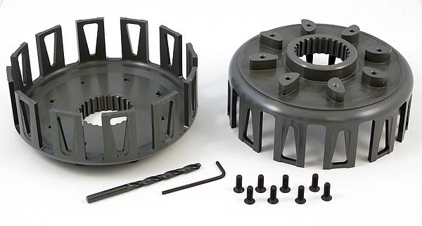

But I think I would get a Mitaka before that much effort.
http://www.mitaka.co.uk/KAWASAKI%20CLUTCHES/4389.htm
